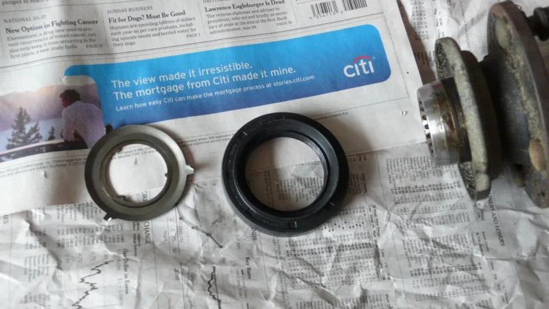

Ok, So I dissasembled the TC last weekend, no problem, going to mount rebuilt 5 speed. Front companion flange removed, Front output shaft - tapped out of old bearing mounted in front side of split case, oil seal removed, this crazy looking locking washer (the kind that has three outside tabs sticking out that you could bend back in...or at least that what it looks like) falls out. It was in between the oil seal and the bearing and has three little prongs on the inside that fit on the shaft splines so when the shaft spins it spins too. My Machine shop guy (who builds race cars) said it looks like it does not belong there but he is not completely familiar with LCs. It also does not show anything like this in any of the schematics that I have looked at. I guess since it was there that it belongs there ...but it's just weird. I hope the picture I tried to post comes through. Many thanks. Walt

Thanks...actually my race car guy said as much but he was not sure....I figured I would put it back in but but funny there is no picture of it either in the FSM or on the schematics at Specter Off Road
It is in the FSM for a 62. In the schematic Toyota calls it the "No 2 oil receiver" for some reason. Wouldn't be the first thing toyota left out of an FSM on accident...
Tony
the front slingers were not on all 60 series split cases, they were added sometime towards the end of production. i install them anytime i build a split case.
the #1 oil receiver is the slinger on the idler gear iirc.

Can someone confirm which direction the oil slinger goes?
This thread says the concave side goes towards the bearing, but I took my original one apart and the concave side (as shown in the picture above) was towards the seal and front drive shaft.

Here's pics of what happens with the oil slinger backwards. Doesn't show up real well, but it's crunched and the "slinger fins" are messed up:
The normal one is on the left. The bent one is on the right.
Get a new slinger, front seal and stake nut.
If you can't find them, pm me. I have those parts in stock.
Also, rotate the snap ring on the front output bearing so the opening is on the bottom.
Inspect the bearing and snap ring for damage. The tabs on the slinger would have made contact with at least one if them. In 4wd that would have caused some noise for sure.
