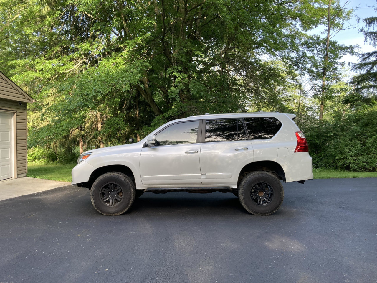

Now that's all fixed, time to start modding it? :cool:
already pretty modified! but as you know, it is never done :)
