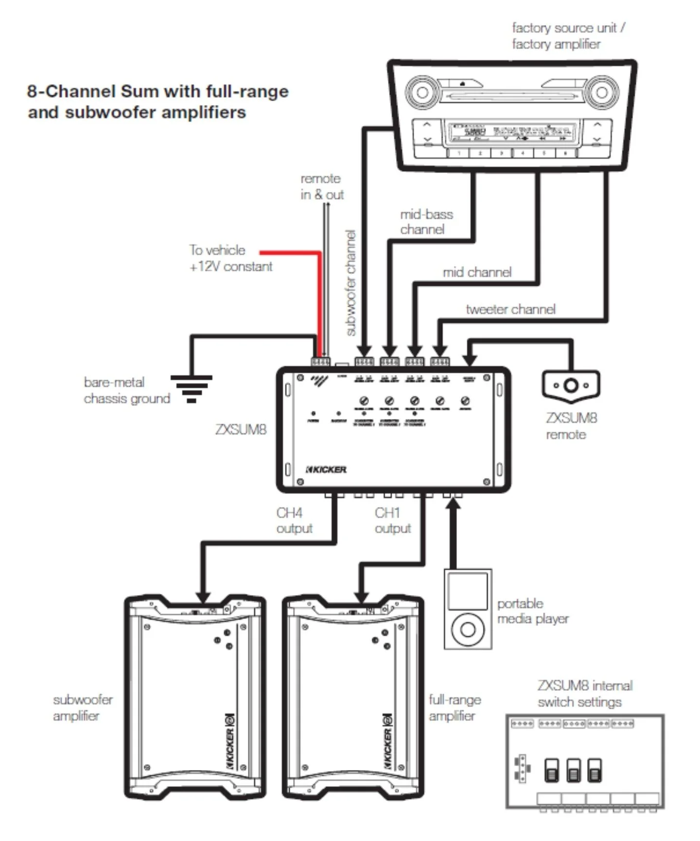

The OEM stereo does not have low level / RCA output so you need an OEM audio integration module that combine all those speaker output level signal and process it to low level signal to be able to add regular amplifier. The problem I found is you ability to lose fader from head unit. You have to do it from the OEM integration module or manual amp tuning.
oem integration at Crutchfield
There are a lot of brands that make this OEM integration module.
If you have nav system it's better to do non nav conversion so you could install a regular head unit with RCA unit.

No. The ML speakers are 8-ohm. The amp will not be happy running 4-ohm speakers. I used the PAC integration module which intercepts the audio signal between the head unit and amp and converts to 6 RCAs. I then installed a JBL 5-channel amp, all new speakers, and a bandpass subwoofer. The ML amplifier is still in place, but now it only powers the center channel to announce GPS directions and bluetooth phone conversations.

Previous owner install kicker integration kit, 4 channel Alpine amp, amplified 6" bazooka tubes and some aftermarket speaker. The staging never sounds right. They must spend a lot of money redoing the stereo and it sound meh.
I just did non nav conversion and it sound really bad. Then wire the RCA direct to amp while the bazooka still goes to OEM integration module. Still sounds bad and found out the Android head unit does not send low frequency signal as it is. I have to change the sub channel output to combined full spectrum signal and adjust frequency cut off at the bazooka amp. Now it sounds really good and the bass hits hard for no additional investment. I am no audiophile and this is been a headache project that start from simple aliexpress android head unit order. The previous install looks somewhat professional so it's not a cheap install. I would be very disappointed I am the one paying for the installation. The sound staging and frequency response was terrible.
Sounds like the Kicker module ain't that great. The PAC adapter decodes the digital signal meant for the ML amp and converts to a standard 6-channel deck output. There IS some fine tuning available via USB if desired, but I left mine default and am thrilled with the results. My fader/balance are centered as are my BASS/MID/TREB and I have crisp highs, warm mids, and punchy mid bass from the doors and a nice <80hz from my 12" sub. If I need to boost or attenuate anything from my 3-way component system up front, I have a [-3db/flat/+3db] for the mids and tweets separately. As it so happens, everything is set to flat and sounds great.
