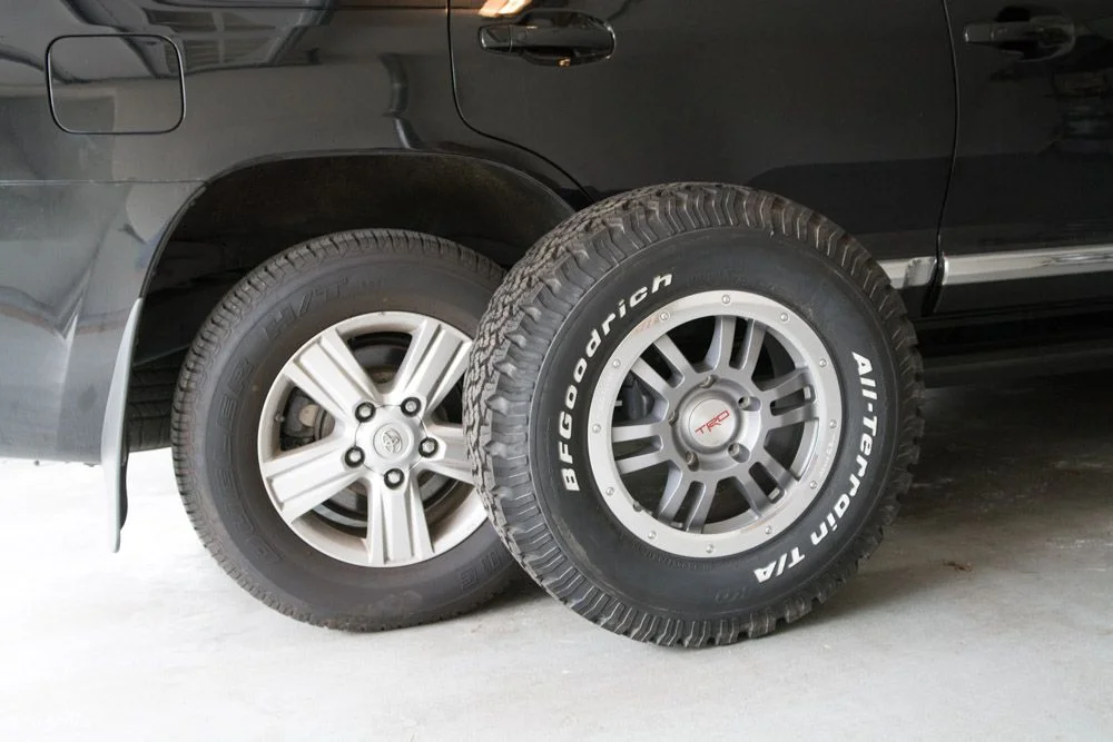

Thanks all. I picked them up today for $1200. It looks like they came new on a 2012 Toyota Tundra, and they were promptly removed and then stored for six years.
Everything looks fairly close to as new as I could imagine.

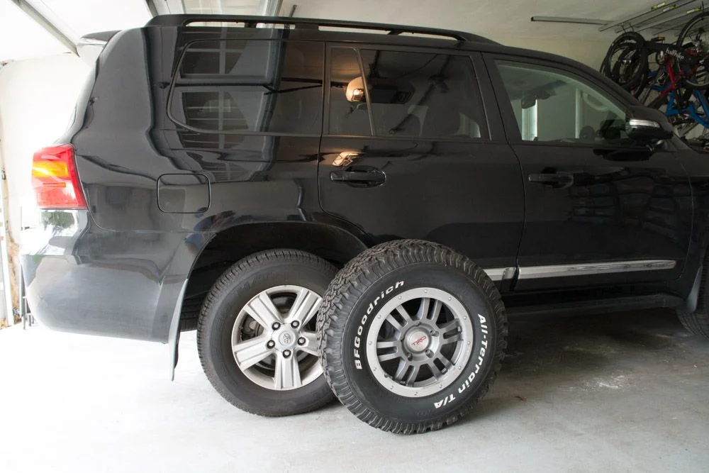

Here are also the tires next to the ones they will replace. I am thinking of only putting the wheels on when I offroad or for winter, and then keep the stock Duelers on for summer road riding.

That’s gonna look sick! Nice find and work. When you said the same person posted many different ads, I was afraid it was gonna end up with you saying it was a scam. Glad it worked out!
Would thus be an upgrade for my stock set up? I do not have suspension lift. Would the 285 rub? I have seen suggestions for 275/70/17 if I still have stock suspension
Set of 4 Toyota Tundra Rock Warrior Wheels with BFG Tires
To fit 285 you have to get rid of the front mud guards and atleast lift it an inch. (3cm spacer cheap lift).
These are general grabbers and they rubbed until I got rid of the mud guards and added a 3cm spacer.
