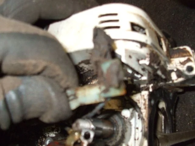

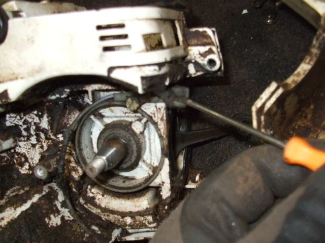

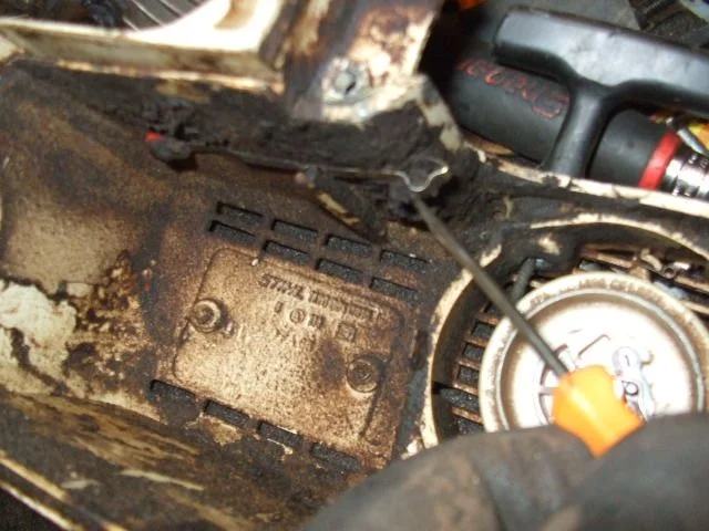

Here are the contacts.
The On/Off slide has a metal slider under it that contacts the is kill wire under the carburetor.
