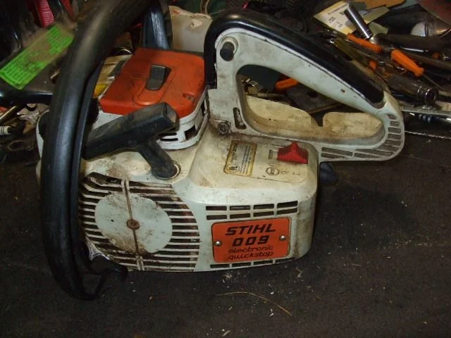

This is a step by step pictorial of the 1120 series STIHL Chain Saw tear down and reassembly.
I'm installing a crankcase in a 009L for a friend and a very good vendor here on MUD. (I can't remember exactly if he ran it over with his Pig while doing Trial Maintenance on the Rubicon or dropped it while juggling at Burning Man Festival. The details of the story are unclear to me.)
The 1120 series replace the 1116 Series and has been around a long time.

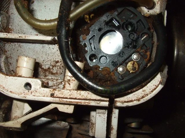

From here you should install a piston stop. This is a horizontal designed engine and the piston is parallel to the spark plug. You can use the "old School" piston stop in this saw. You cannot use this piston stop in any saw where the spark plug enters the cylinder at an angle. You will break the spark plug threads if you do.

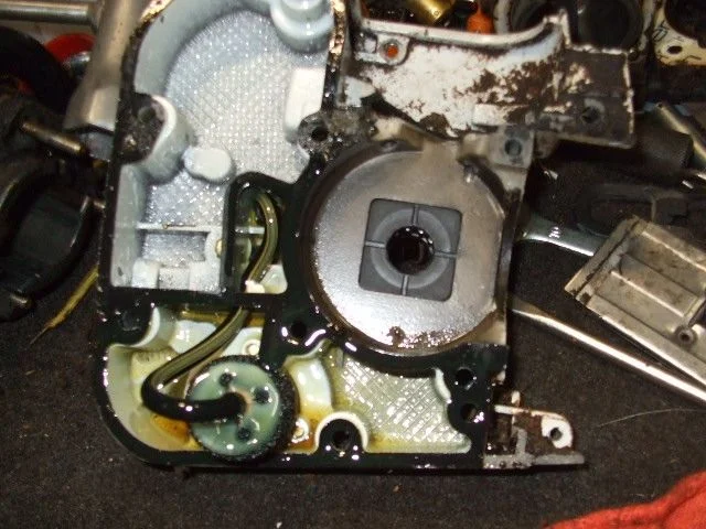

Now it is time to split the crankcase.
Each STIHL crankcase has matched halves. Once they are cast they are machined and bolted together and then powder coated. Alignment pins are installed as well as the screws that hold the halves together. They are then line bored for the crankshaft and then the cylinder area and the carburetor mounting area is decked to ensure a flat surface. Although the tolerances are so close you cannot see the differences Mixing and Matching crankcase halves is not recommended.

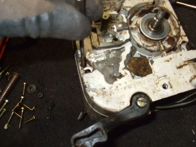

Take a small drift and tap the alignment pins 1/2 way out. On the 1120 sereis there are three alignment pins.
The top one is right under the throttle rod/cable area in the 6:00 position of the carburetor. It is located right above my screw driver/pointer.
The next two are around the crankcase pretty evenly spaced.
