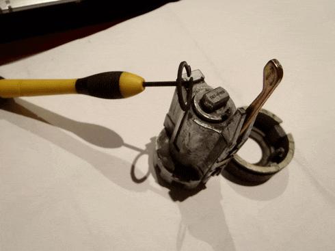

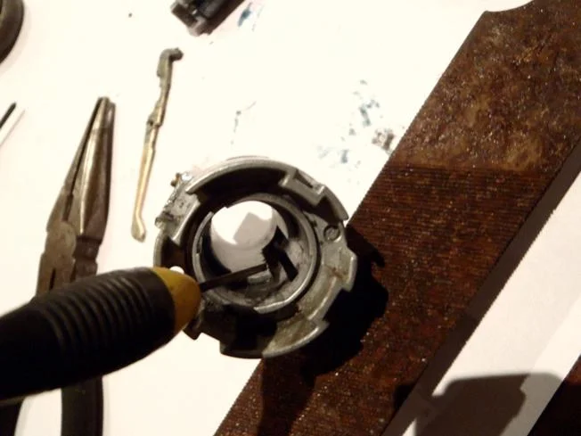

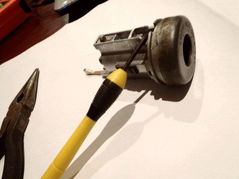

Pic 4 -remove the circlip that holds the key mechanism in the barrel - if you dont have the right tool to do this (i couldnt find mine) you can use a small screw driver -gently lift it out and then up - and then work it off being careful it doesnt take off across the room at mach 1!!)

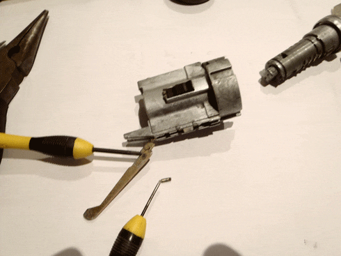

Pic 5 - hold down the steering lock arm and the mechanism will slide out

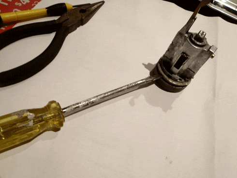

Pic 6 becareful that you dont lose this little pin which locates the steering lock arm in the the top of the barrel

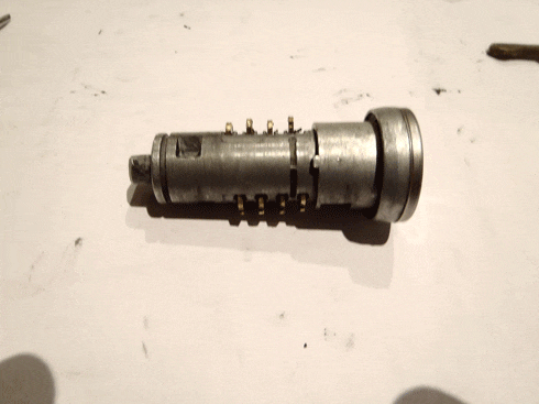

Pic 7 -you can see some of the pins sticking up causing the lock to stick

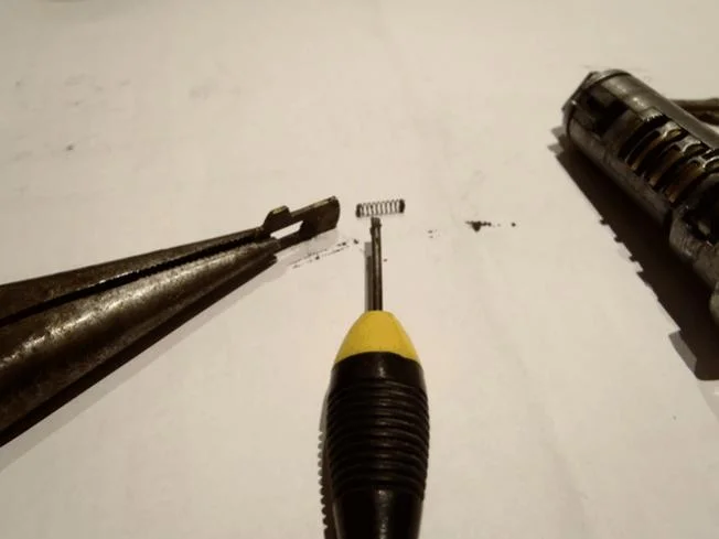

Pic 8 -i removed all the pins/lugs to clean as they were very sticky -be very careful when removing that this little spring doesnt fly out or get lost

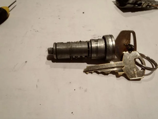

Pic 11 - greased the whole lot and put back together - bingo works beautifully! -

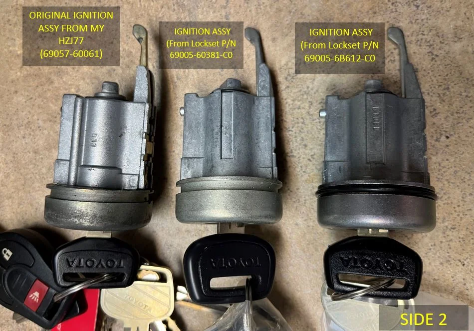

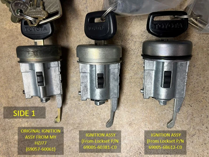

Just don’t be surprised if the lock barrel won’t fit. Might not be an issue with yours since the 77 is 1990 and newer. The lock barrel didn’t fit my 1985 Ute but fortunately I didn’t need to replace it, I bought the kit so I would have one key for everything instead of multiple ones🤣

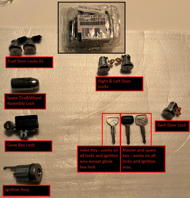

69005-6B612-C0 worked for my 1993 HZJ77. See photos below. Includes everything, even the valet key and glove box lock. The only thing that was extra was the fuel door lock (it comes with two).
