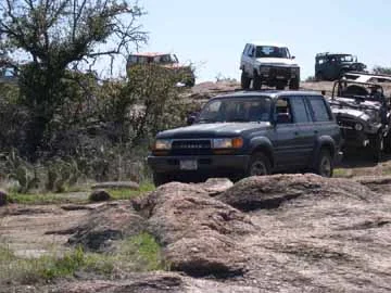

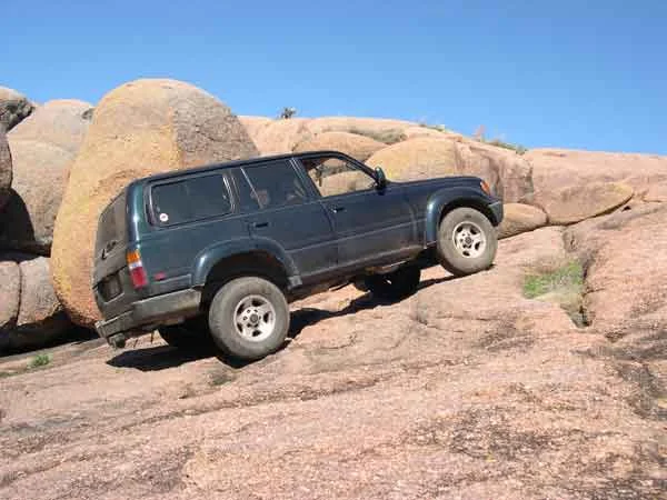

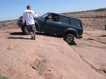

Ready to hit the trails? Get in and go! I suggest taking your truck as is with a group and get to know what it can do just how it sits in your garage! There are lots of things that people have suggested that you can do once you get to that point but for light wheeling you are set! What proof?
Stock truck with out lockers...the ONLY "mod" was I took the running boards off the morning we went out, and left them in camp. And yes..those are even the stock 285 Dunlop tires. :D Check out the avatar also...
attachment.php
attachment.php
attachment.php
Now a word of warning...doing this in your stock truck will increase the desire to do a med-heavy lift...tires...arb...sliders...and possibly lockers. Which are all on my possible future once fund$ are available, but don't sell your truck short. Get out there and enjoy it!
