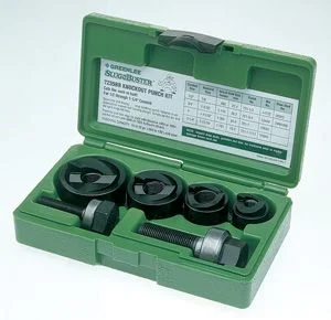

I have a bunch of dull ones also. If you using them for electical work, might want to do what I did and purchase a set of Greenlee knock out dies.

the hydraulic unit is soooo much nicer

Are those strong enough to drill holes in spring perch plates 5/16 steel?
Not likely. The hydraulic unit has the force, but I don't know if the die would hold up. I've used them on 3/16 stainless and that was pushing it. They're really designed for light/med sheet steel.
I don't think so, we use ours for putting holes in electrical boxes, works great for that.
