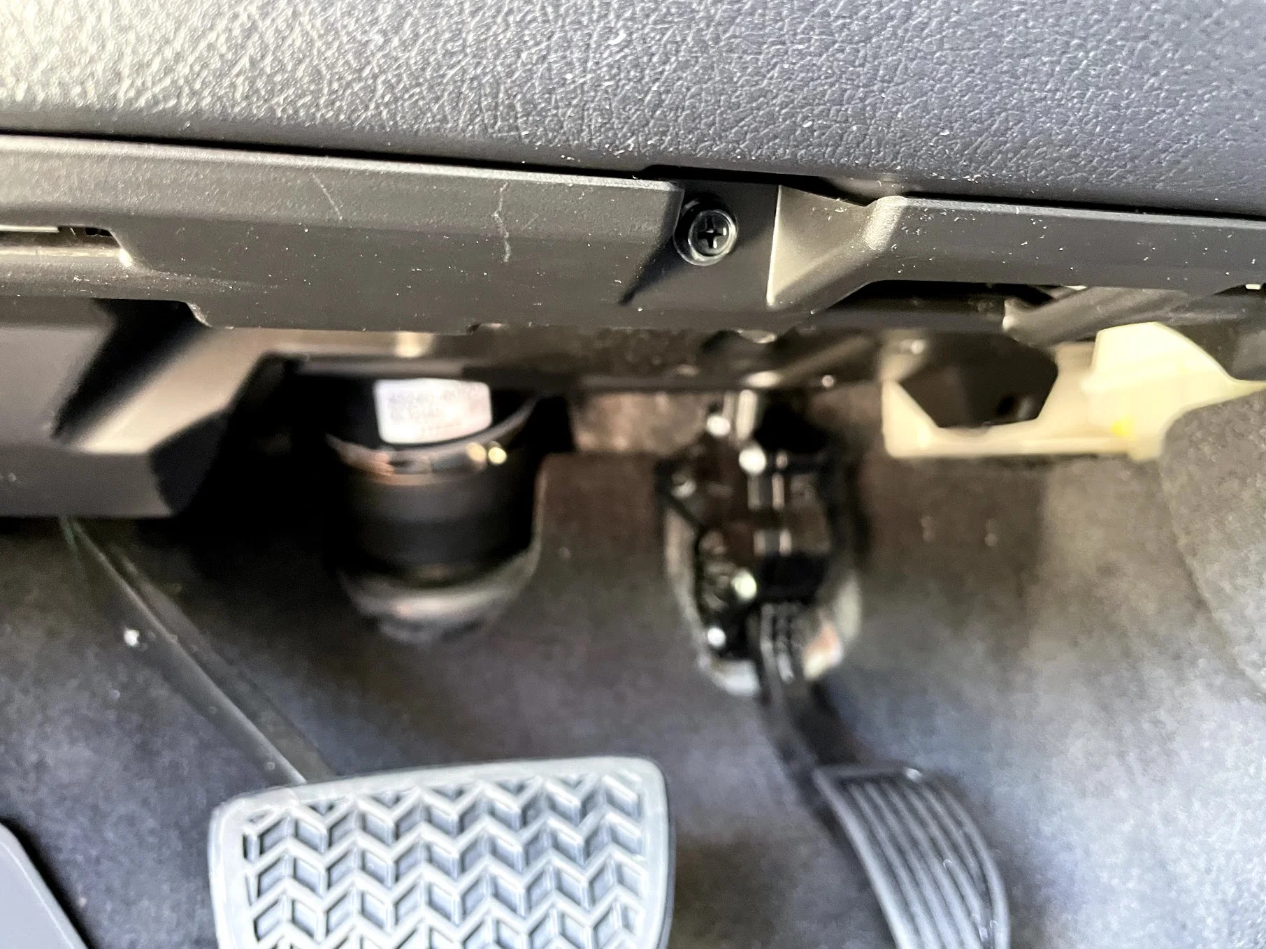

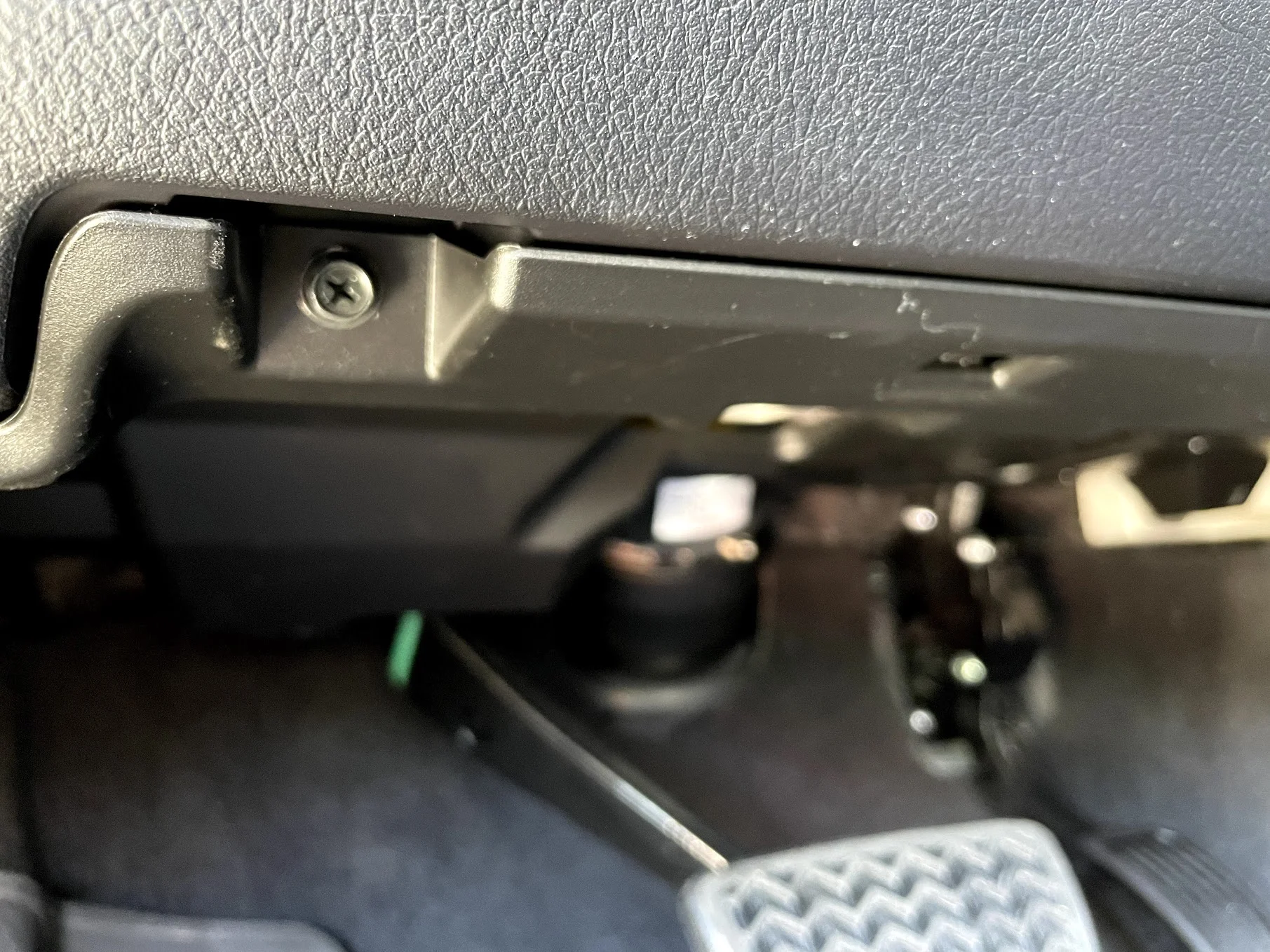

Step 1: Remove the two screws at the bottom of the driver side panel.
Left side screw:
Right side screw:

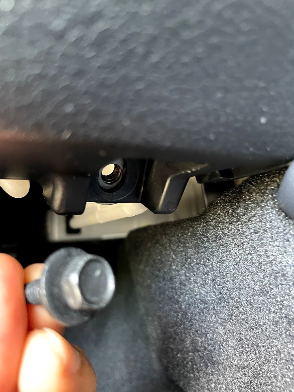

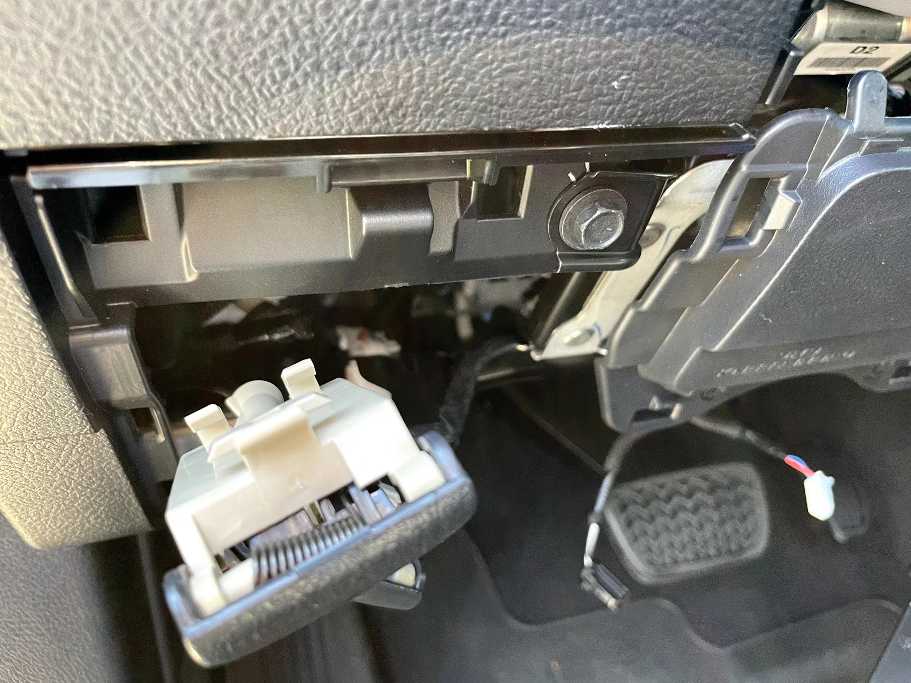

Step 2: Remove two 10mm bolts on the left and right side of the main lower panel. This panel surrounds the knee airbag.
Right bolt

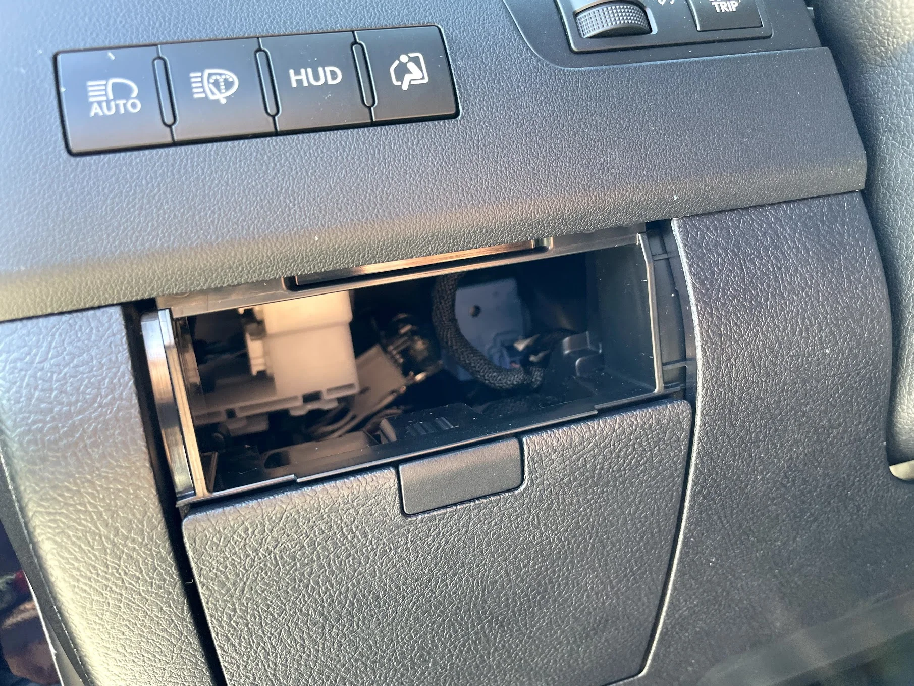

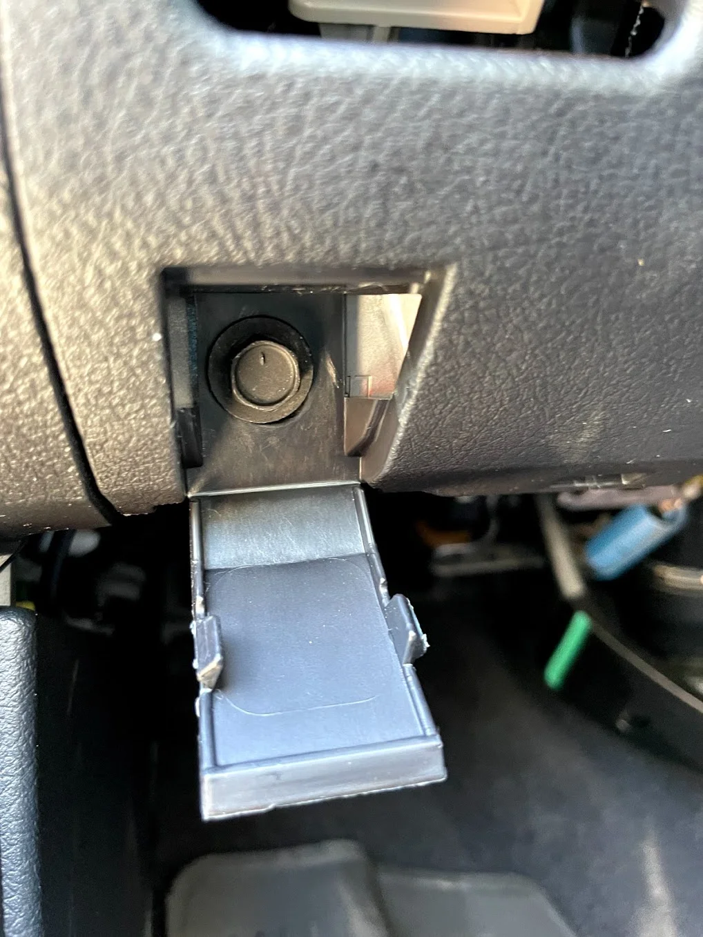

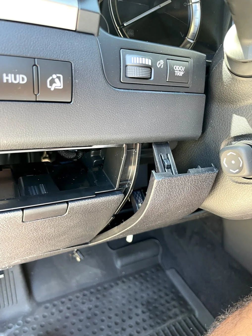

Left bolt is behind this plastic trim piece which opens downards
Trim flap open showing the bolt

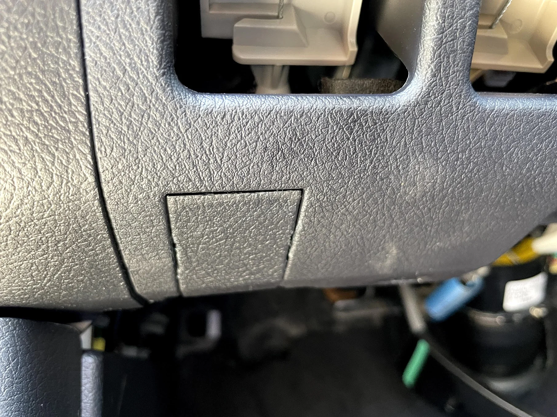

Step to skip: There is a small rectangular trim piece below the left hand buttons and above the coin holder, there is no need to take this out and recommend skipping this step.

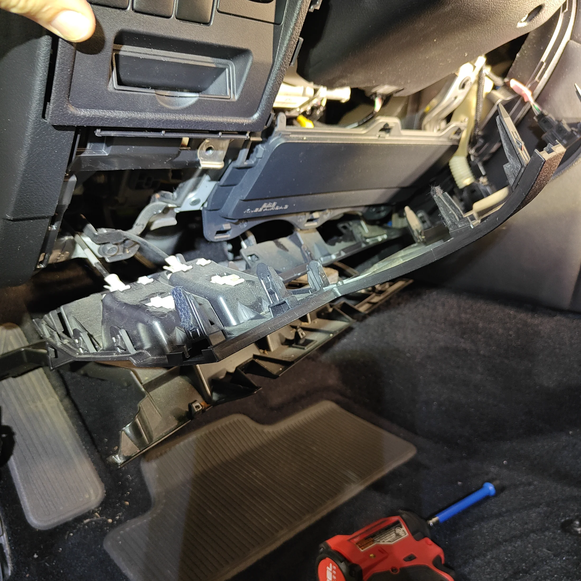

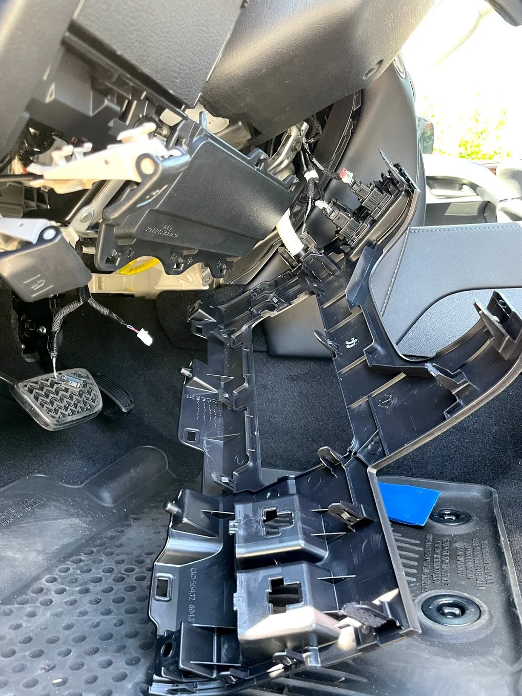

Step 3: Use a trim removal tool to remove the main lower trim piece, its snapped in place across the left, middle, and right
Lower trim left of the steering wheel
Right side trim piece removed (where the tailgate button resides)

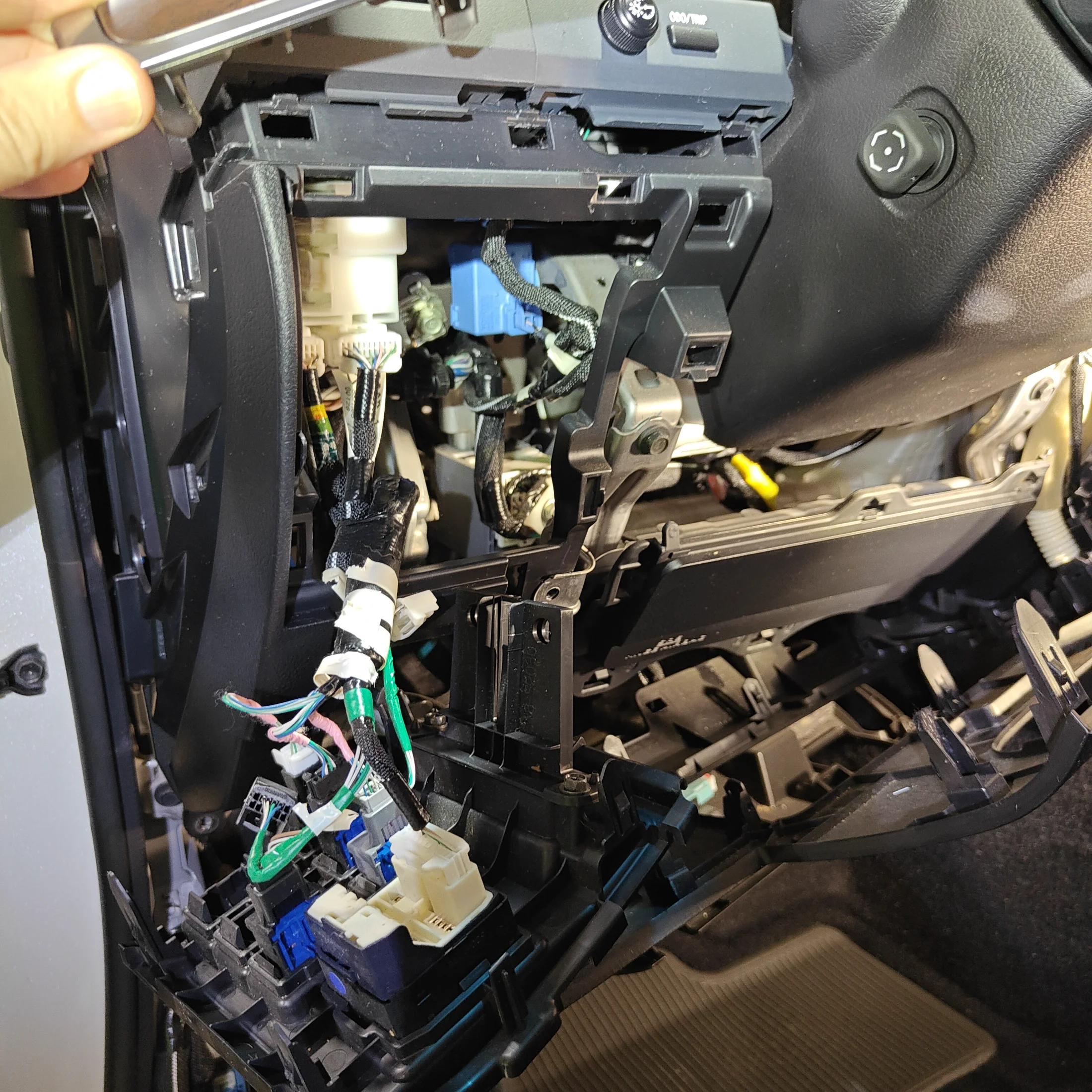

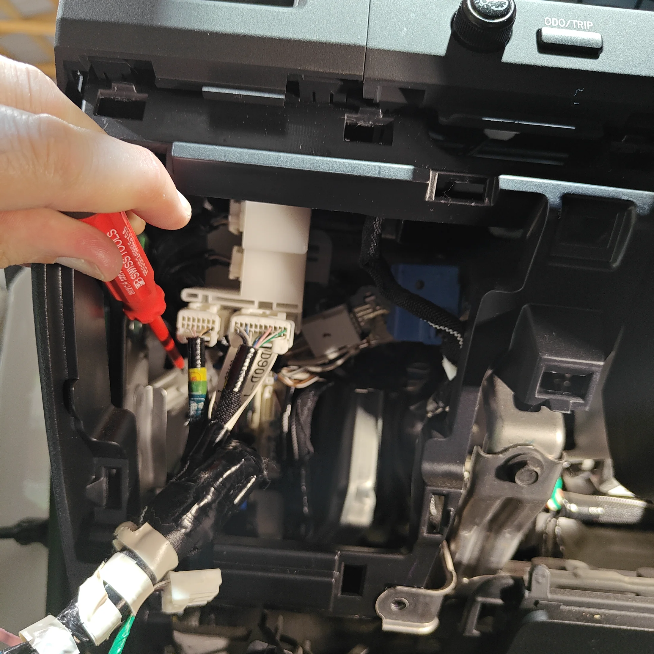

Step 4: remove the gas and hood open levers from the trim piece, it slides and moves down and easily comes out
Lever for hood
Main lower panel removed and hanging by the buttons on the right hand side of the steering wheel

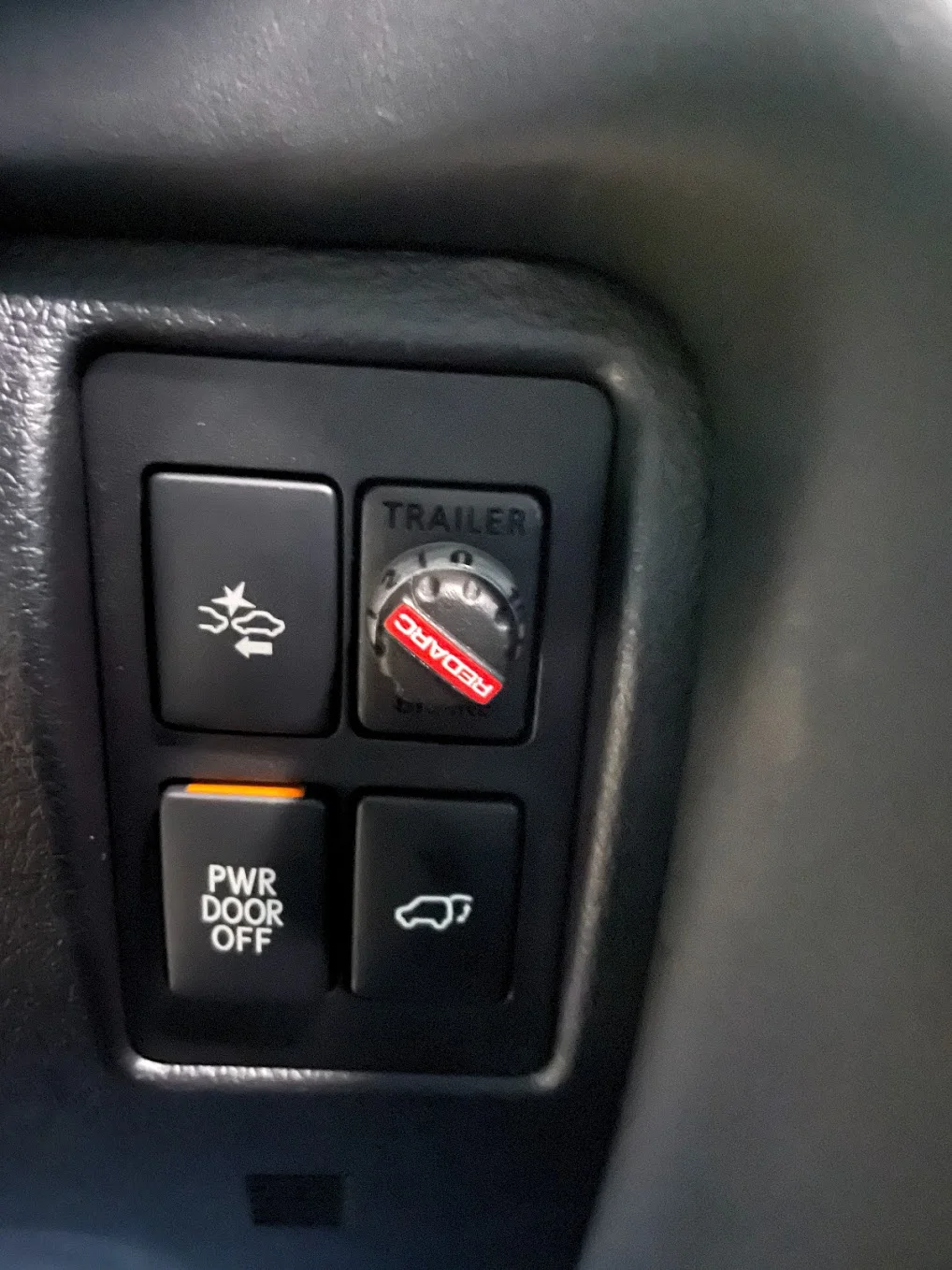

Step 5: remove the empty switch and install mounting panel for Toyota (part 331-TPSI-002)
Back of the switch panel
New trailer brake switch from the front

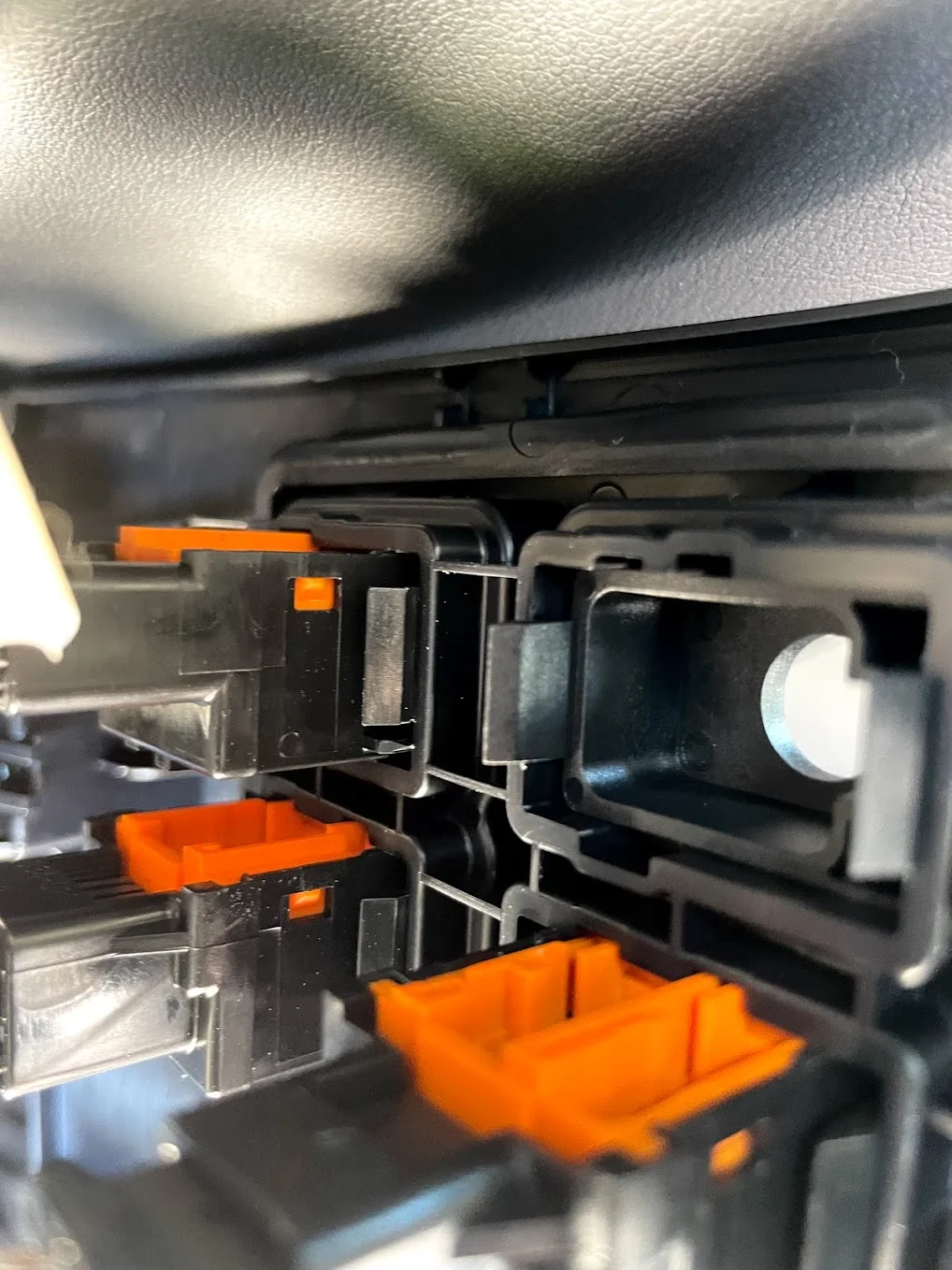

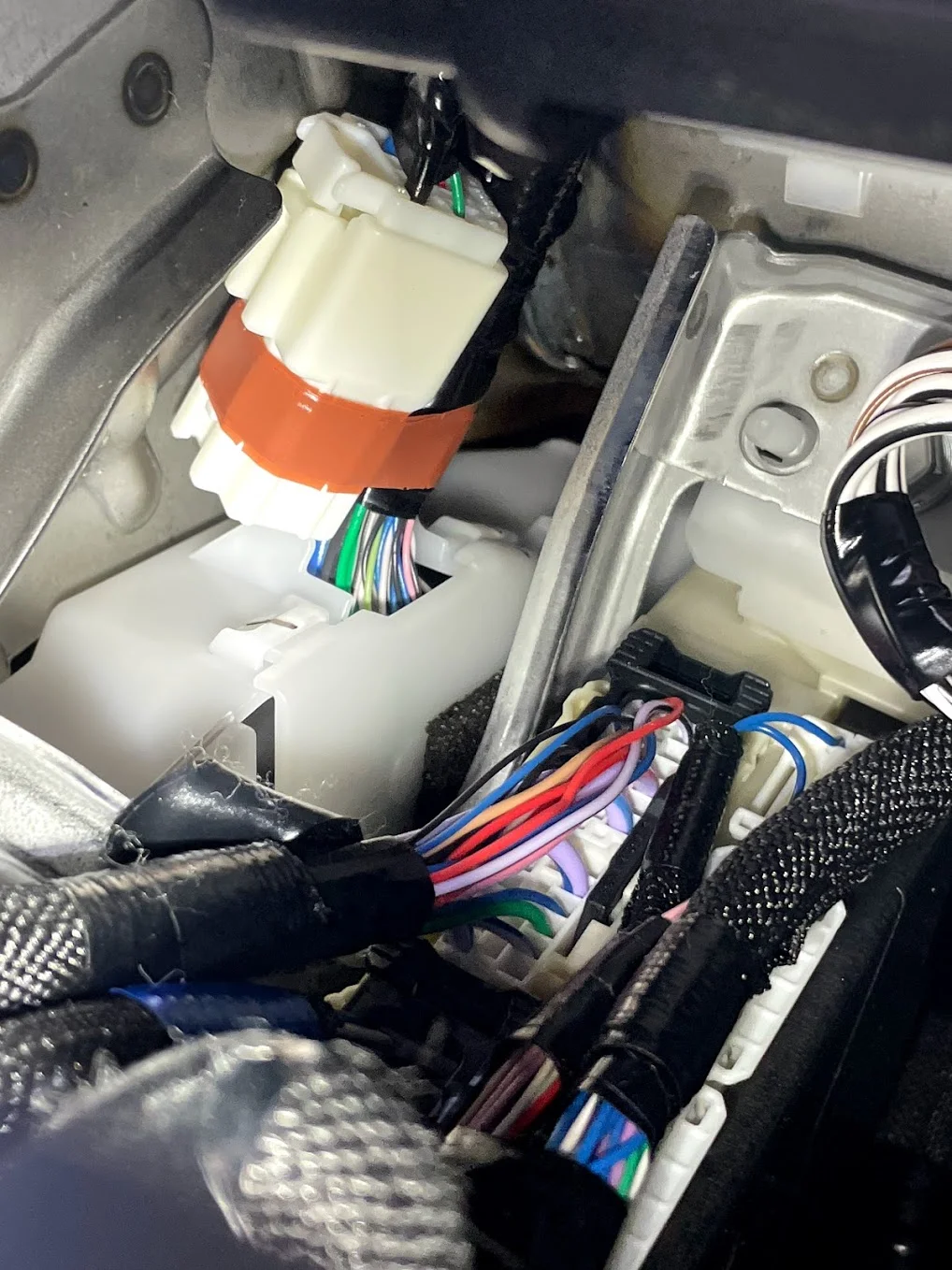

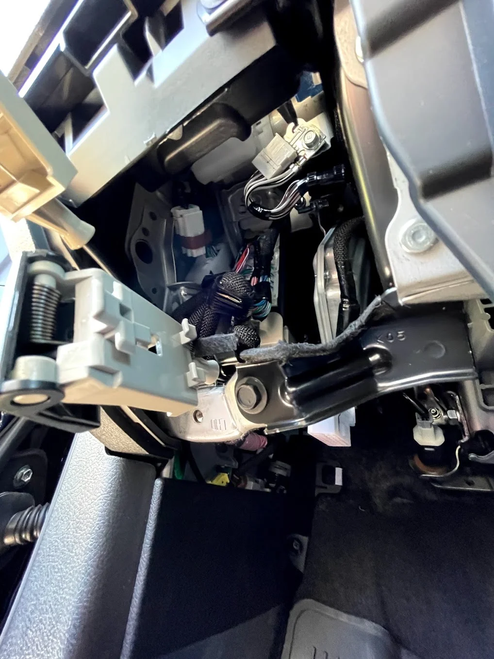

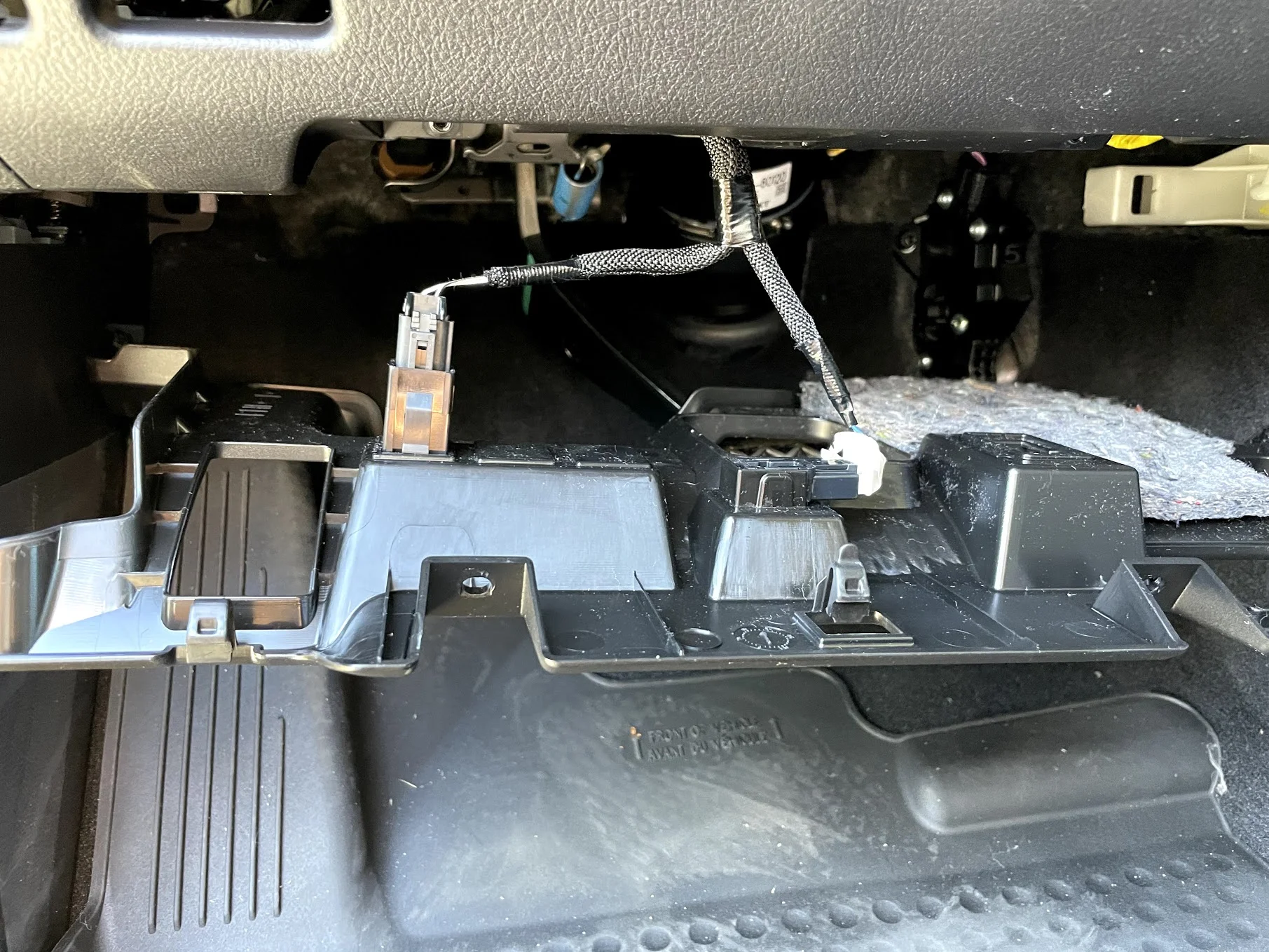

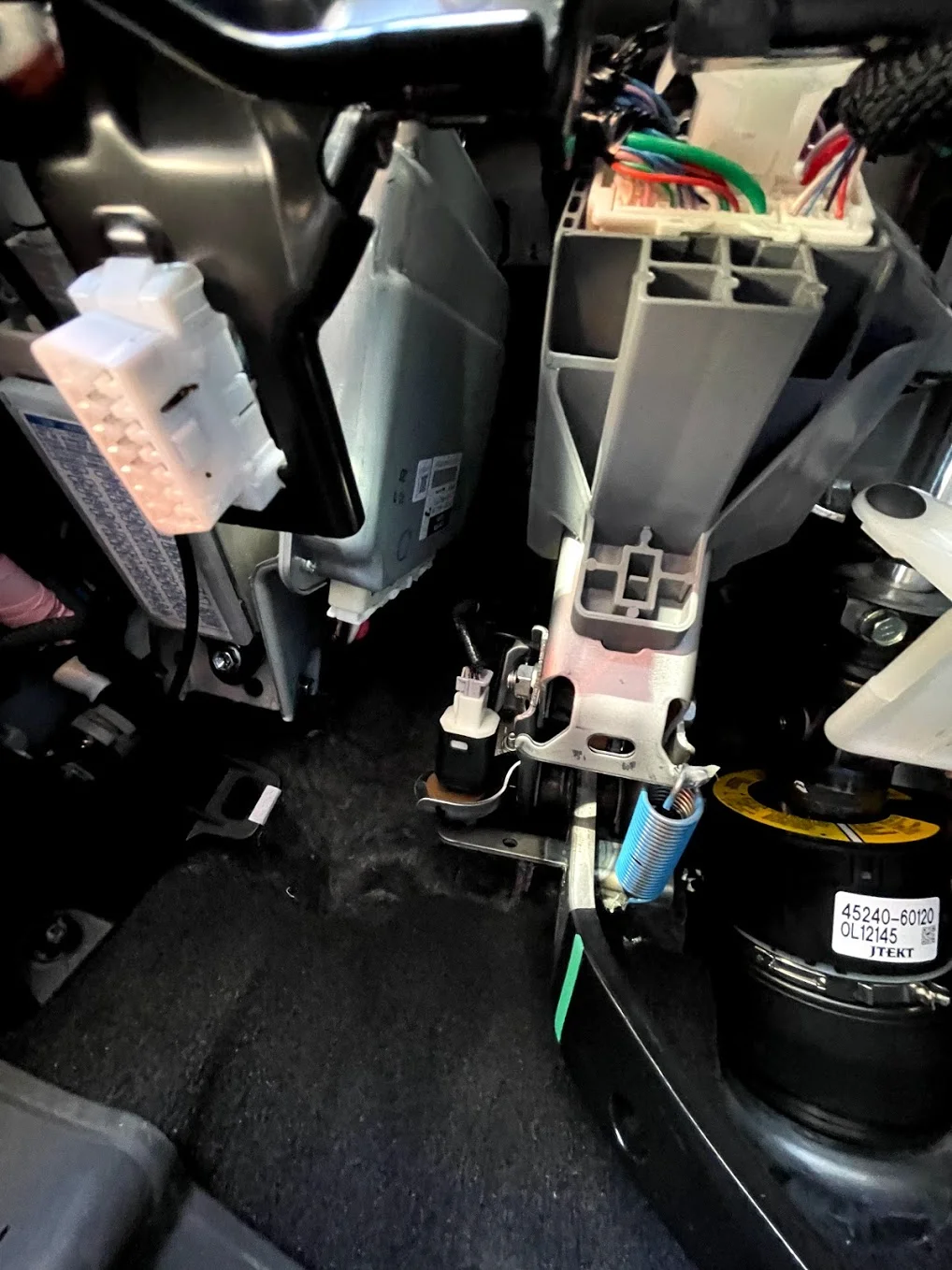

Step 6: Locate the trailer brake controller connector, mine was on the left most side, wrapped in brown tape, and connected to a dummy connector
Up close view of the brake controller and connected to the dummy connector (note with a flash light it looks orange, without flashlight the tape is brown)
Zoomed out view with the dummy connector with tape on it.

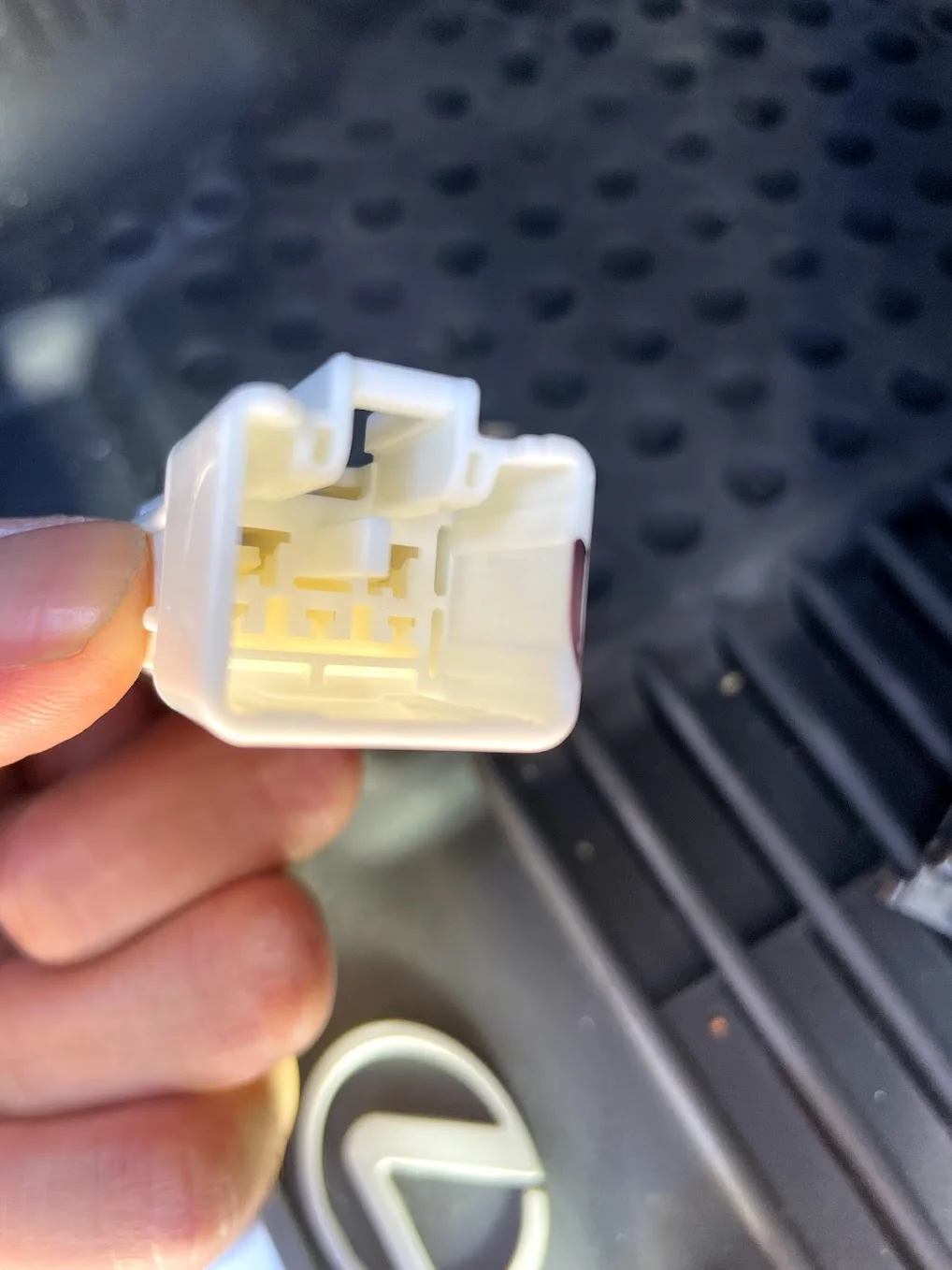

Dummy connector
Dummy connector removed

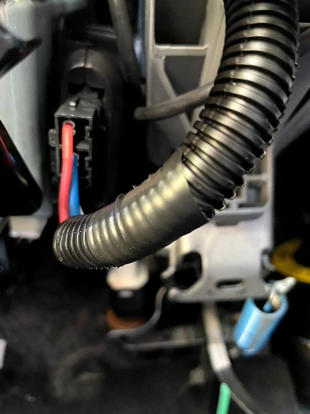

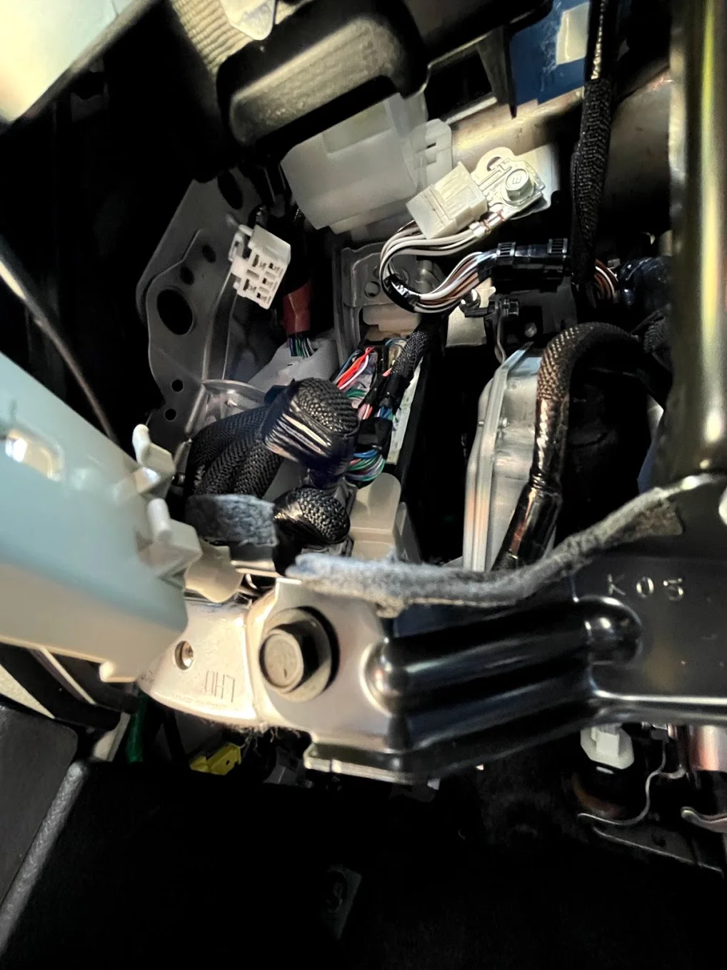

Attaching trailer brake controller: I used double sided 3M tape to attach to the silver box behind the OBD connector.

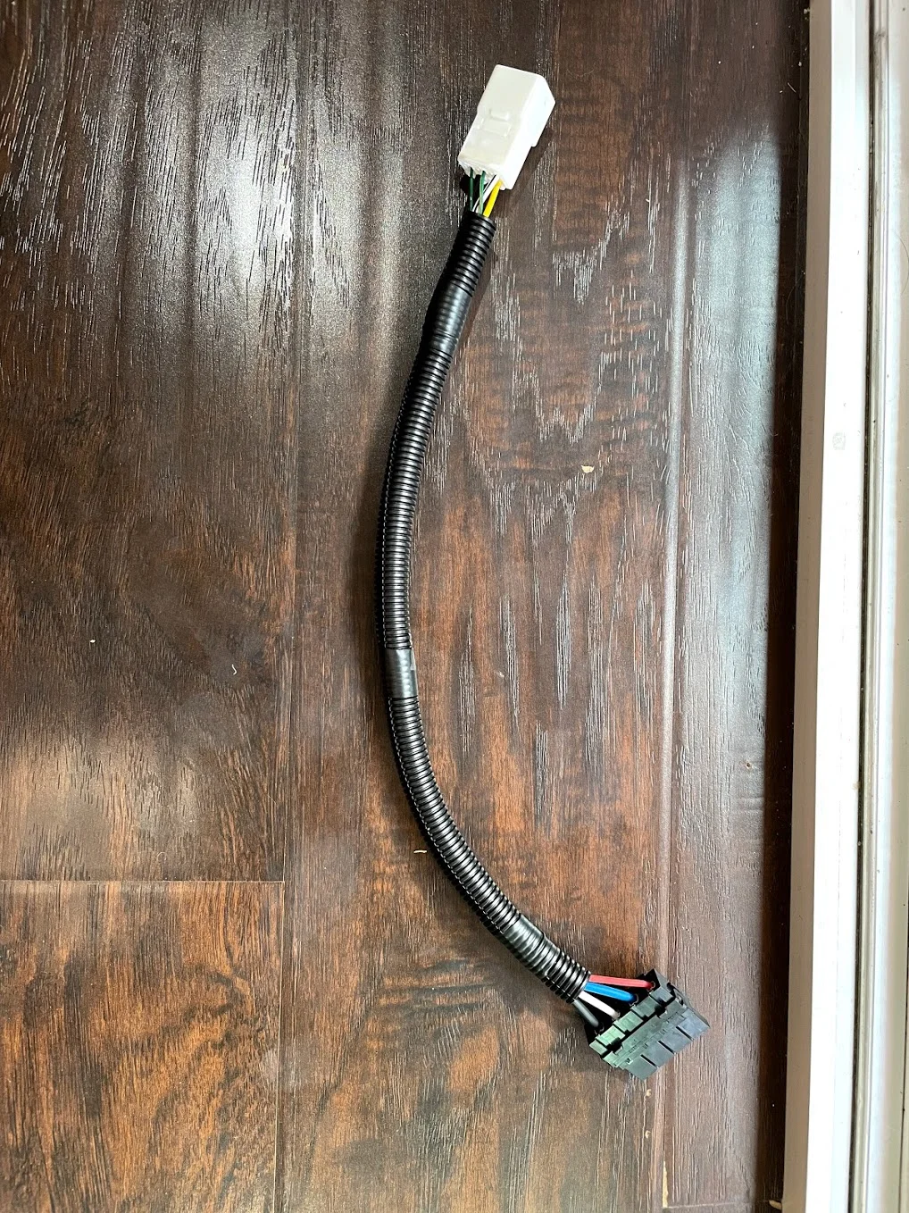

Trailer brake controller plugged in to the cable
Connecting cable (I soldered the two wires, added shrink wrap, added electrical tape over the shrink wrap, and then put all of it in a wire loom)
