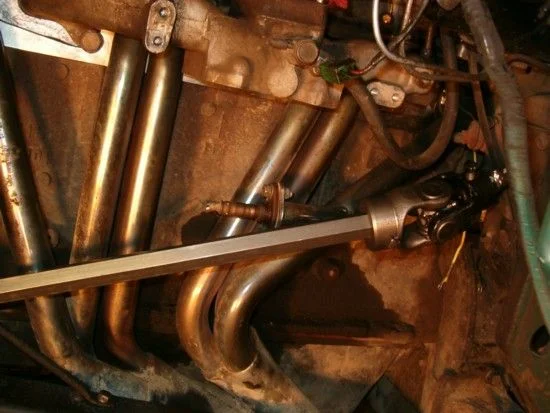

So I had a day off and decided to tackle the final fitment of the powersteering into it's new home. I have everyting in place, the box end clamped down but I need to weld the upper u-joint to the stub of the steering shaft.
The positioning is terrible. Now I know why my last conversion was welded so poorly at this spot. There is essentially no way to get the welding gun into position. I tried from below, no dice, above the booster is in the way. I do not want to rely on the set screw only to keep the shaft in place. The welds also need to be good. Any advice from the pros?

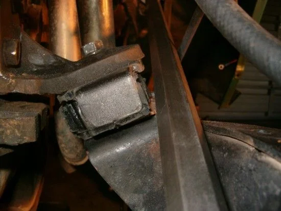

The last pic shows the 1/2 of space between the shaft and the motor mount that was discussed in another thread.

Looks kind of dicey to get that u-joint through the firewall.

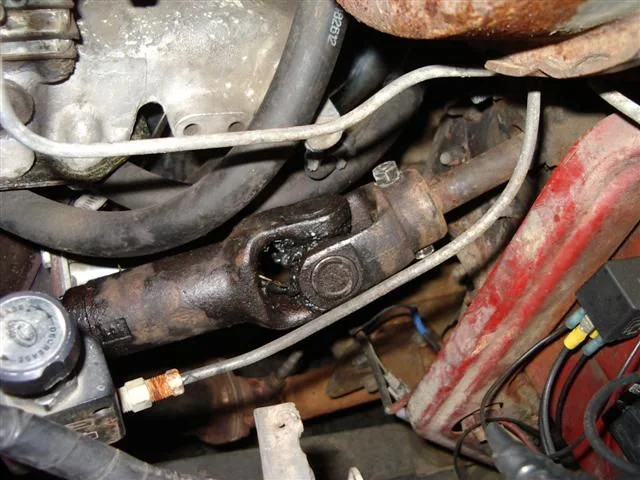

A better idea on that top u-joint, though, is a version that includes a 4" slip joint on one side. The steering box is attached to the frame, and the steering column is attached to the body. The body and frame are seperated from each other by body mounts because they do move differently, expecially if you are doing any twisting on the trail. My old setup did not provide any slip, and the assembly wore itself out and became sloppy. The slip joint in the new column I made shows about 1/4" of slip action there, and after about 10 years is still as solid as the day I put it in. That u-joint in the picture is an off the shelf part with the right size hole on one end for the Toyota steering column, and the other end is a 4" slip for a 1" keyed PTO shaft.

Gary-thanks. I have that same slip joint just down at the box end. It fit just fine with room to spare. Had I been thinking, I would have done it with the slip joint up.

The yoke tacked in place:
