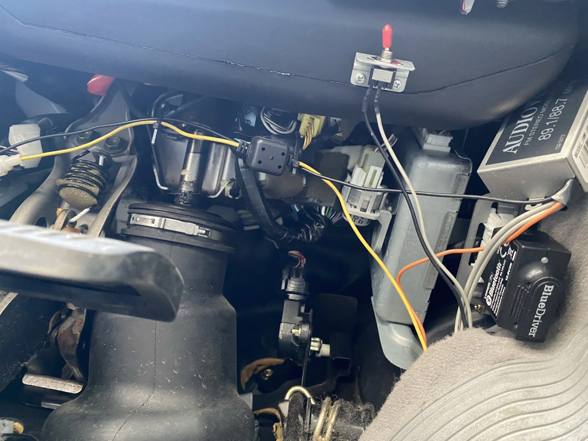

An easy way to tell on a U.S. model, is the VGRS light that appears on the dash, after you disconnect/reconnect the battery.
VGRS equipped LX, have a large boot covering the mechanical unit under the dash. Which all 2003-07 USA models do.

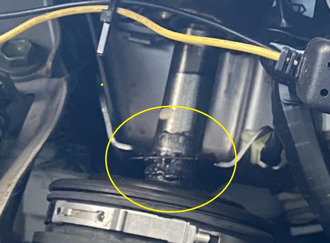

Call any Lexus dealer, with VIN #. They can tell you, if the VGRS snap ring recall work has been done. It is very dangerous to drive if not done. Below is one, that snap ring popped off.
