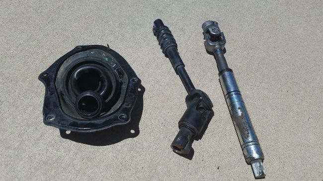

I fixed the clunk in my steering wheel by replacing both intermediate shafts and the grommet/bushing/boot (Toyota calls it a coupling shield) where they enter the firewall. Parts 6, 7, 8 on the diagram.
2021577
The job was not difficult. The hardest part was trying to remove the fender well splash guard without breaking the clips (failed).
It turns out both intermediate shafts felt and functioned like the new parts when held in hand. Only the upper (#1) intermediate shaft has a slip joint on it. The #2 intermediate shaft has a metal bellows on it, but my guess is that the bellows is designed to collapse in a crash. So the problem PROBABLY did not lie in either of the intermediate shafts.
However, the coupling shield (rubber boot on the firewall) was torn around its circumference where it holds the intermediate shaft. It's actually fairly thick, with double-wall construction and a circle of thick foam to reinforce it. Mine was torn on the engine compartment side. I'm guessing it is designed to control some of the bounce or vibration in the shaft when going over bumps, so the damage probably allowed too much movement in the shaft.
Total cost for all the parts was about $325 shipped to my door in 2 business days from Partsouq. The coupler shield by itself was less than $40 before shipping. Could have been a very cheap fix, but I wasn't sure which part was the culprit.

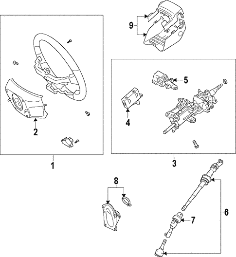

Do you have a part # for part #8 on the diagram (boot)? What's required just to swap that? Does it get any special grease applied when you install it?
Mine has been squeaking when I turn the wheel when stopped or at low speed (i.e. when parking). If I pull the boot up I can spray some silicone lube at the base, which quiets it for a few days/weeks, but eventually the noise comes back.
I'm on mobile, so I can't see your sig, but part number depends on your model year. 45025-60170 is the part for 2008-11 vehicles.
Replacing it involves match-marking your steering shafts, unbolting and removing the upper intermediate shaft, and then removing the 4 or so bolts/nuts holding the rubber boot in place. Not difficult, and you can have it done in less than an hour. Just don't turn the steering wheel with the shaft removed. I didn't apply any grease to mine.
Thanks. Looks like the 2013-2020 models use part 45025-60190. If it keeps squeaking I'll pick one up and see about swapping it.
I fixed the clunk in my steering wheel. My hypothesis above about slip joints was wrong, but the general idea about the problem lying outside the column was correct.
So I basically replaced everything that lies between the steering column and the steering rack. This includes both intermediate shafts and the grommet/bushing/boot (Toyota calls it a coupling shield) where they enter the firewall. Parts 6, 7, 8 on the diagram.
