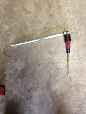

I've been jacking with mine today, a result of a few issues, and created my own SST to do so.
It doesn't turn easily, and the tool comes in handy torquing on the jam nut to tighten.
I made the same tool but with vise grips on the handle. I broke the tip right off the screwdriver.....
