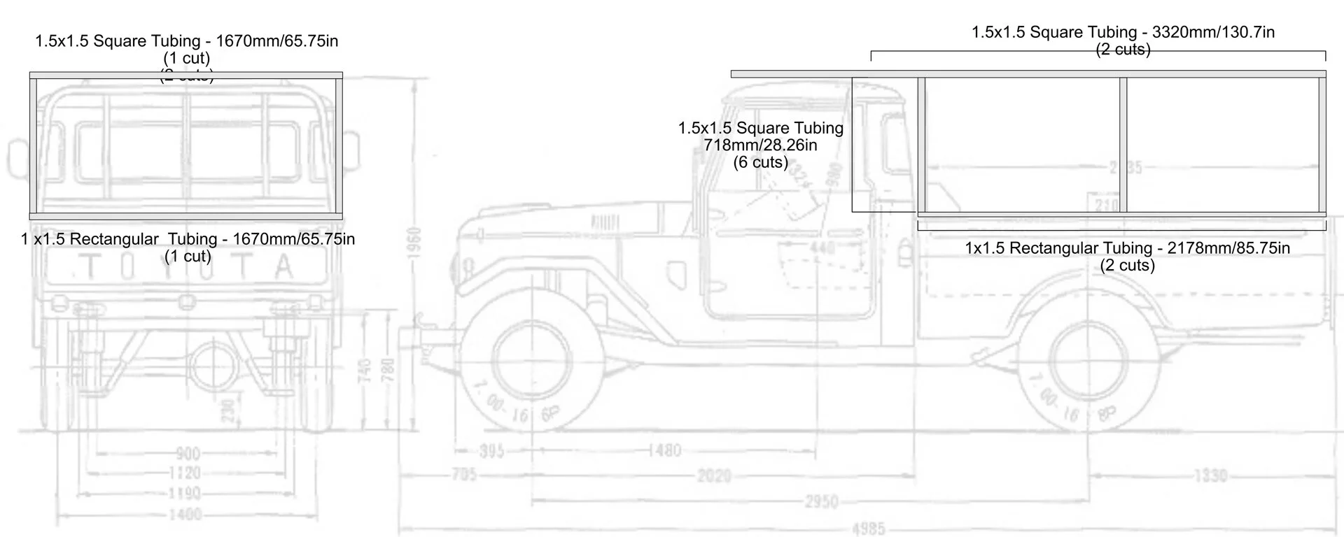

I drew up an idea a few weeks back with the thought of using the steel, but the weight is indeed an issue. That's why I thought of structural steel studs; the ones that are I believe 18 gauge or similar. Seems they are pretty strong. But I if the 1"x.083 wall steel tube you are suggesting is better, I can go with that.
Originally I was going to adapt an AluCab Thor roof conversion to the box frame, but decided I can make a camper box for much less and it will suit my build better. I still very much like the AluCab Thor though, absolutely beautiful!
The "walls" of the camper will be rigid insulation foam skinned with "poor man's fiberglass". This is more to avoid the toxic stench and mess of true fiberglass, which I have worked with and absolutely detest.
I will also use gull wing windows to access stuff from outside.
Below is a drawing of the basic frame, and a mock up of how the camper should look. If you notice, in that drawing, I made the camper to look as one with the cab. This would mean replacing the roof with the camper roof, and removing the entire ear window bulkhead, which would make a continuous area like a Troopy-except for still having the lower bulkhead, which I am fine with.
However, I am not sure how I would connect the camper section with the front properly, and whether the flex of the camper will compete with that of the cab.
I do not want to weld on the existing rear window bulkhead, so perhaps buying a beat up one to just use the area that mates up with the doors, or make my own.
If I have to leave the cab as is and make the camper section separate, that is not really a problem though. I will then simply remove the rear window to allow emergency access to the cab, and use a gasket between the cab and the camper.
Please do advise.

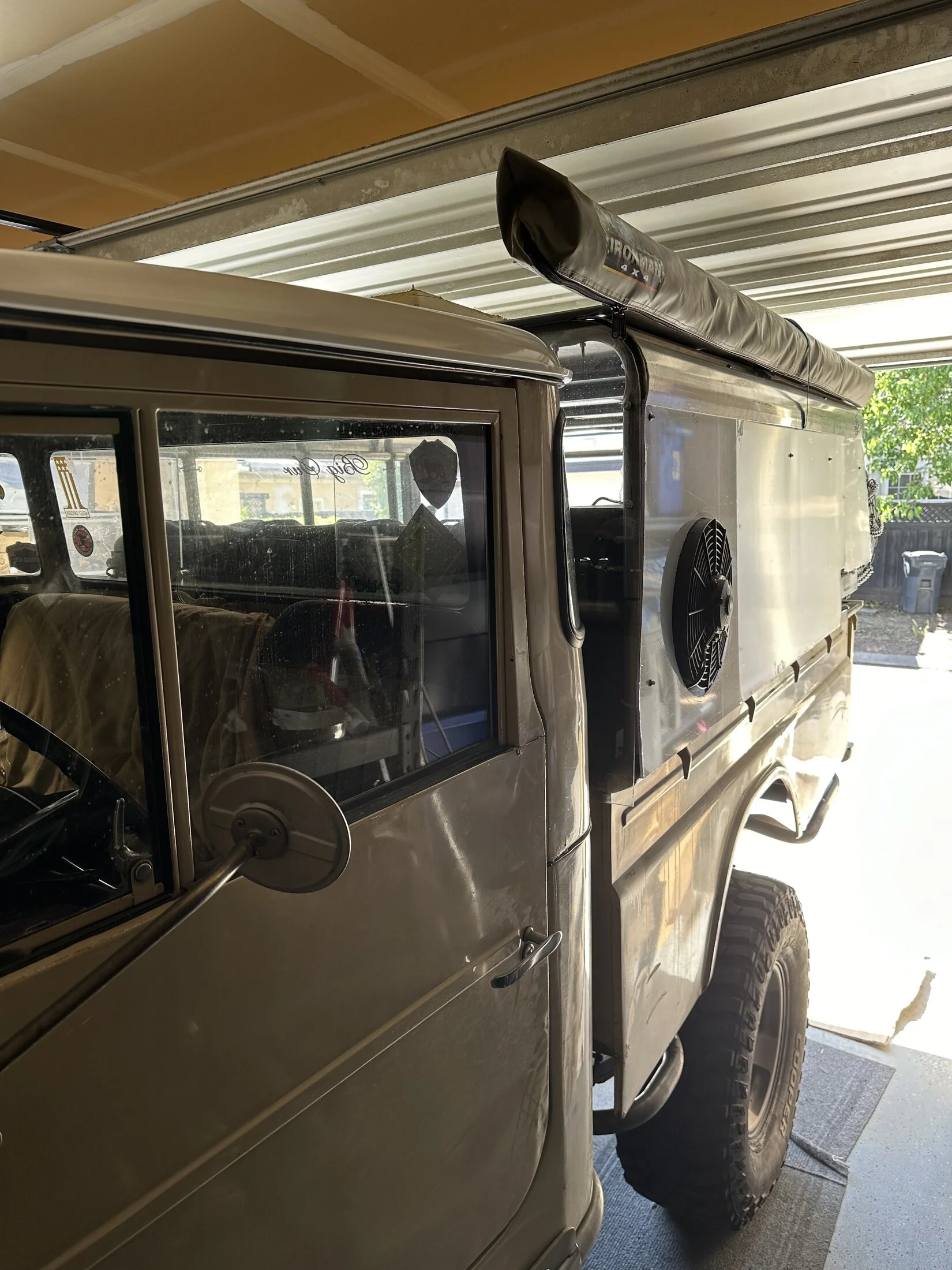

Here is an lx470 being married to a Sunrader camper box. Might give you some ideas.
That was interesting, thanks.
I asked him about the flex. Let's see if he answers.
The original setup, with the little pickup truck, is kind of the same thing, and no issues with the flex it seems.
I was amazed at the absolutely horrendous materials used in that camper though! Particle board!!! Not even plywood, but particle board! Seems like most RVs are build to look nice but are trash: like frosting on a turd.

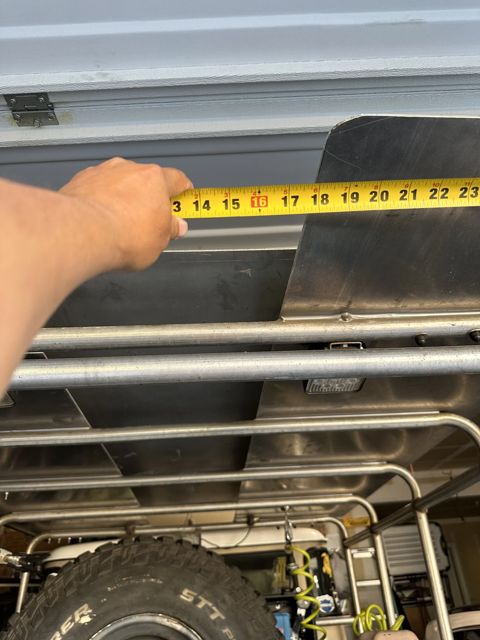

Your ideas are sound, and if you do not have to be limited by height, going over the cab would require about 7 inches of clearance above the cab to allow for the bed box twisting on rough terrain. Troopies bodies do not flex the same way the Longbeds can
As for me, I spent much of 2022, 23 searching for a company who could possible build a bed camper for the FJ45. The only people who are open to building a one-off model is DirtBox out of Colorado. They have a 45 at their shop; possible, though beyond my budget
I chose Gary@mudrak.com to repair multiple broken spotwelds in my pickup bed, after the 2022 Rubithon. I still use a tubular aluminized rack over my bed, and it has been a reliable support for many home lumber projects. after surviving the elements for about 4 years, I replaced the plywood top panels with 2 sheets of 1/8th aluminum (around $280 each) and made the top surface flat, so I could later mount a low profile tent, or solar. I have focused on keeping the great directional visibility of the truck, and so decided that I wanted to just block rain and snow from getting to my gear in the bed. The whole idea of blocking my view of the outdoors and wilderness seems counter to why I have my truck. The pickup bed is vented at the top rails for airflow, if I want to rest thru a storm.
I ‘adopted and re-purposed a stack of 3/8” laboratory polycarbonate shelving, which fit just fine between the tubular uprights, and between the bed and cab. Here is how it handled the May 5th blizzard which stopped traffic in both directions near Truckee. I’m workin on how to enclose the rear, to keep dust and ash out while going thru the icy slush. I run 35’s on springs built to carry the cargo that weighs just about 1700lbs. Had to move the spare out of the bed, so I fabbed a swing out tire carrier. lastly, installing 12V AC with the condenser in the bed (where else can it go?) , powered by a 460A Li Fe Po battery, nearly done after the blizzard shakedown drive. I garage my truck, and so must clear a 7’9” door opening

7" clearance between the roof and the overhang seems like a lot. Are you sure it would be that much?
If it is, it is, though. I can simply mount the off road lights just ahead of it to cover the gap, at least from a front view. I guess the sides can have the awning mount, etc. that could cover the gap.
