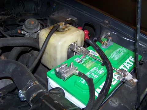

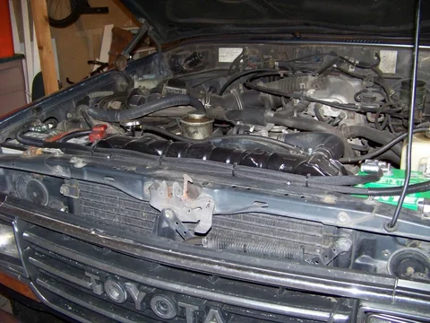

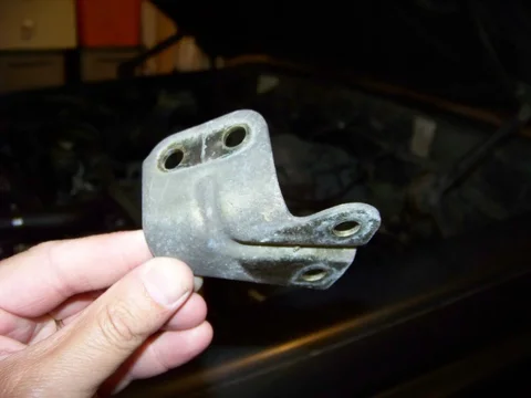

100_6410.webp 100_6406.webp 100_6405.webp 100_6409.webp 100_6411.webp Ok here are some pics. The first two show the battery with the standard hold down and the overflow bottle mounted on the ss relocation bracket. The third pic is the valve ( vsv i believe) that i unbolted from the fender and pushed toward the firewall to allow the overflow bottle to fit. The fourth pic is the bracket that attached the vsv to the fender (this was removed). The vsv hose just sits there pressed up against the overflow bottle. You could zip tie the vsv back to the fender if you wanted to but its not going anywhere. The open port on the vsv is for the hose that leads to the silencer. This was removed to make room for the second battery. The last pic is the rest of the system. I used 2ga welding cable and covered it with heat shield tubing where it passes in front of the radiator. The battery in the stock location is an interstate megatron starting battery. Hope this helps.
man, that looks like a perfect fit. Thanks for including the pic of the ASV. I already took the silencer off that ASV.

Sorry, I had forgotten about this thread. I used the special overflow bracket from stainless steel. I am not sure if it would fit the original hold down but it fits the stainless steel hold down for the original sized battery. I think they only say it doesn'the fit the 62 because the emissions stuff is in the way.
