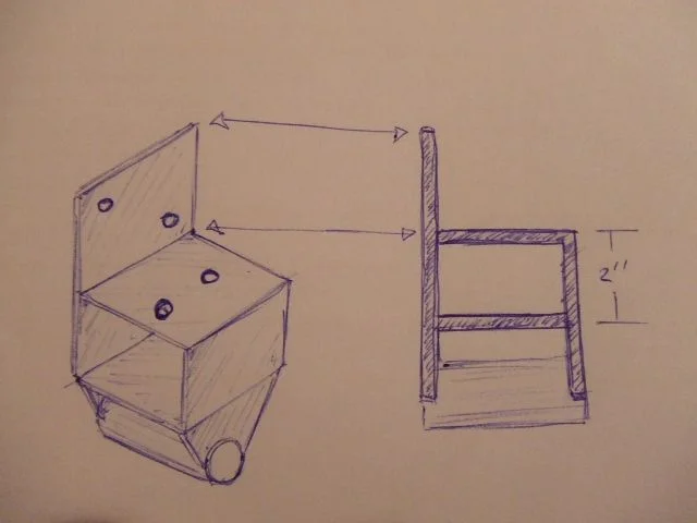

2. I want to move the front hanger towards the firewall to allow for a longer less steep shackle, but the steering arm thing will get in the way.
I figure that if I drop the shackle mount down approx 2" it will clear the steering arm and also give me a nice lift will this work?
I have done a quick sketch to illustrate.

Are the springs that you are wanting to put on in the future longer than the springs you have on it now? If they are shorter I don't see any advantage and if they are longer you must first consider where you want the center of the axle (if you want it in the same place or to move it forward) and then move the hangers accordingly to get the axle where you want it. Still easy enough but just a little more work.
I wouldn't move anything until I had the actual springs that I was going to use. Sure you can make hangers and get stuff ready but I wouldn't put them on until you were ready to put on your new/different springs.
Springs will be original 40 springs I just want to move front hanger back a bit ( axle in stock position) to get a nicer ride and more atticulation.
I will need to drop the hangers to allow this but figure it will give me a nice lift while i'm at it.
I think I had what you want to do. In my expirience don't mess with the hangers. I end up puting them as they came and boght a 2" spring lift. Ride is better as articulation.
