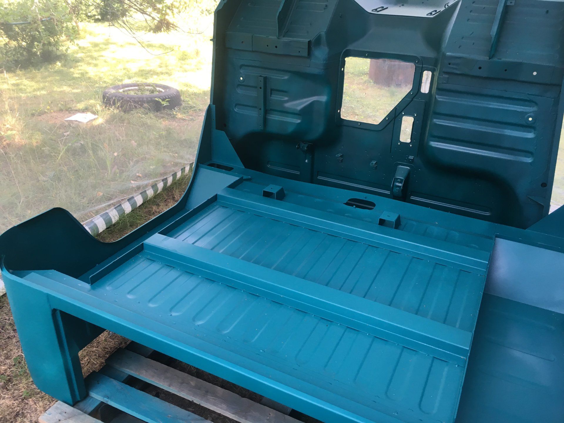

Sorry, but before situation is not going to happen, I’m doing it now. Here are my tub halfs:

And sprayed with a cheap air hopper spray gun (4.5 mm nozzle, 4 bar):
3
Very thich stuff, like construction grout. Hard to get aimed, so wide/uneven spray shape.
But there it is, about 20 pounds sprayed (beige surface is touch dry, white is not yet):

Before:
After:
