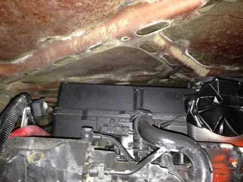

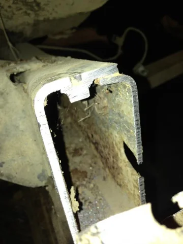

Bye bye frame! Interestingly enough, it tore when the cut got almost all the way through.
Frame cross section. The inner plate is thinner than the outer one.

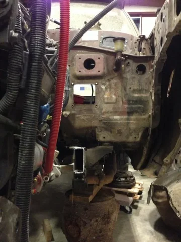

Somewhat in place, with the bezels and grill in place for a frame of reference.
Drivers side
Passenger side
Front
Rear

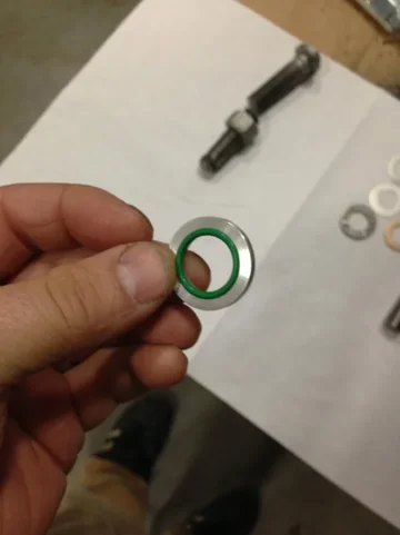

Decided to spend some time on the broken caging bolt on the rear air brake can. After some machining, here's the pile of parts:
I had to machine a new sealing washer for the exposed end if the bolt. When the caging bolt is released, the o-ring seals between the nut and the can to keep water out. What I am trying to emulate:
My attempt:

The way you have that framed cribbed is a little scary. I hope you're keeping the young'un clear of that. :)
Nice fix on the cylinder, Kevin.
The kiddo is trained to stay out from under things. Actually, the cribbing is pretty solid. There is a single board across the top that ties the two cribbing stacks together. It's more steady than the jack stands. I shook it really hard and it hasn't come down. That being said, I will be getting some screw jacks before I tear the rear axle and remainder of the frame out.

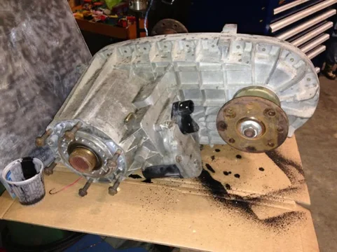

Picked up a transfer case today. I love the fact that ford 6.0 liter powerstrokes self destruct...
NV273. It's the electric shift model, not too jazzed about that, but I should be able to modify it to manual shift if I want to. But the electric shift model came with synchros for the range shift. I like that. It's about 120# and 22" long. 13" offset on the front output, so it will help me clear the fat roadranger. 7800ft-lb ish torque rating, 17,500 gvwr. 34 spline 1.5" input, and I believe the flanges will except a 1480 yoke. Ford put this thing in f-250's on up. Talk about overbuilding a 3/4 ton...
Rear flange:
Front flange:
Input:
The bolt pattern is the same as a np205. I think the register size is different, but I have yet to measure that. Now I can finish my adapter and be one step closer to a complete drivetrain.
There is no provision for a speed sender on the output. The transmission does have one, though. The engine ecu can accept a two-speed rear end switch, so it's drivetrain protection calculations would be unaffected, but it does not output to the speedometer. I will either have to pull a signal off of one of the abs sensors like ford does, or just live with the fact that the speedometer will be off in low range. Not a huge deal to me.

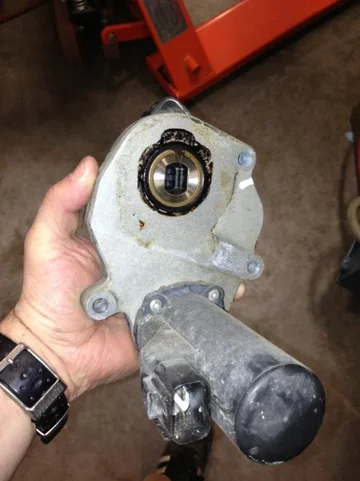

Took the electric shifter unit off to see what was under there. It appears as though a manual shifter is going to be fairly straight forward.

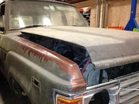

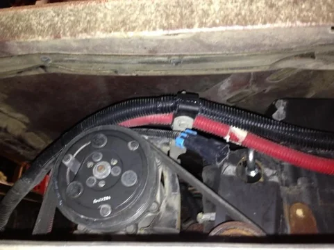

I placed the motor on cribbing to remove the crane so I could look at potential hood modifications. I think I can make a tasteful extension to the already sizable bubble in the hood while keeping the stock lines. Pictures of the fit. There is about 5 inches to the firewall as it sits now, perfect for easy maintenance access, but could be reduced for intercooler fit in the front.
Some notes:
The engine is not exactly centered. It is biased about an inch to the passenger side, by accident. It does give more clearance for steering and front driveshaft/diff this way, though, so I might just go with it.
The hood is pivoting about the crankcase vent filter mounted on top of the valve cover.
The hood clears in the back with no issues. The engine is slanted about 3-4 degrees right now, and I like the way it fits.
All told, I need to make about a 3-4 inch lift in the center bubble to fit it.
