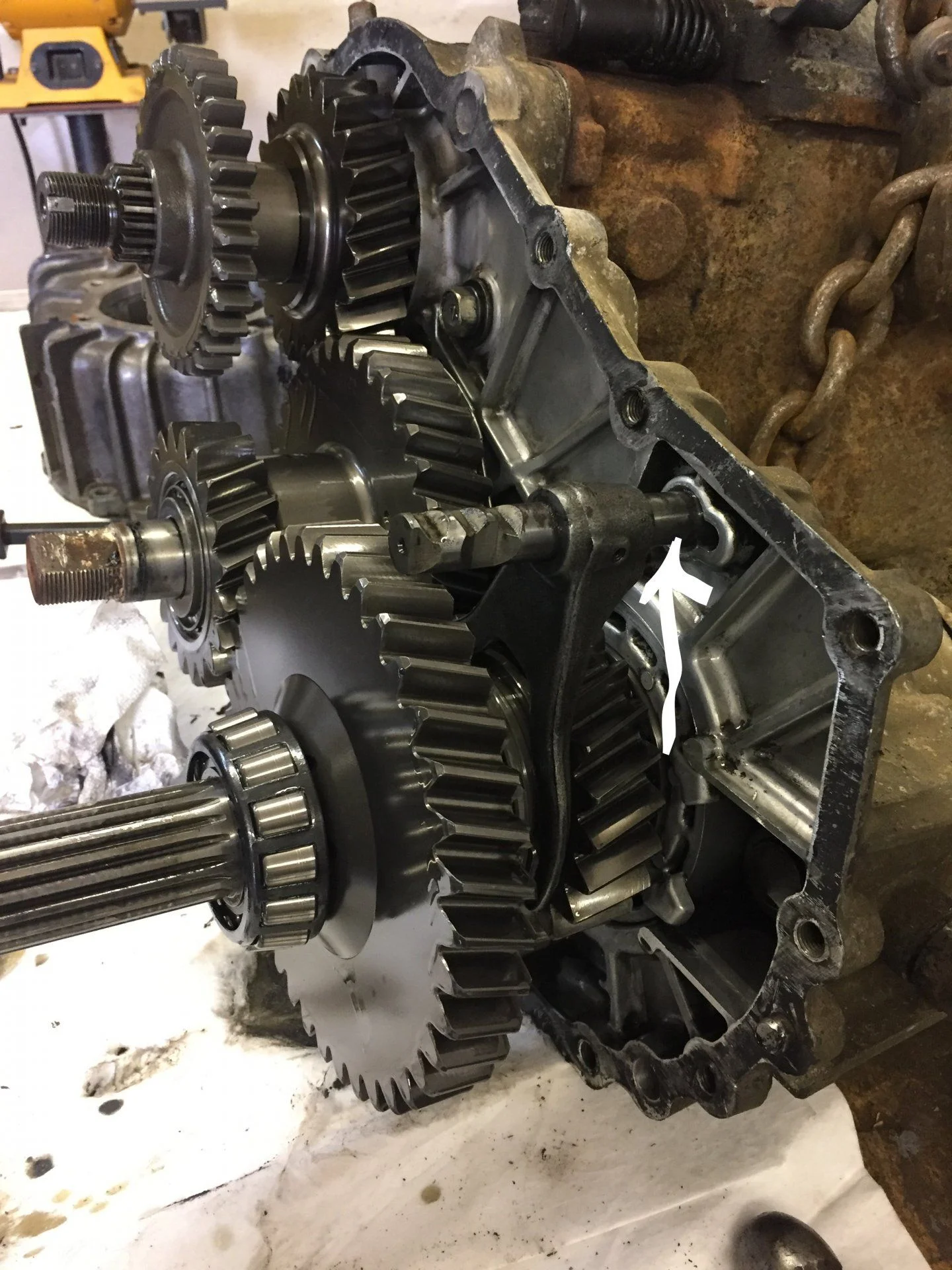

Can you get a set of Vice Grips on it, and does it pull up? I just had mine apart, that lever if it's still there
is kind of 'captured' so it should be able to wiggled and pulled up.
Are you missing the assembly on top? Is it still attached to the shifter lever?

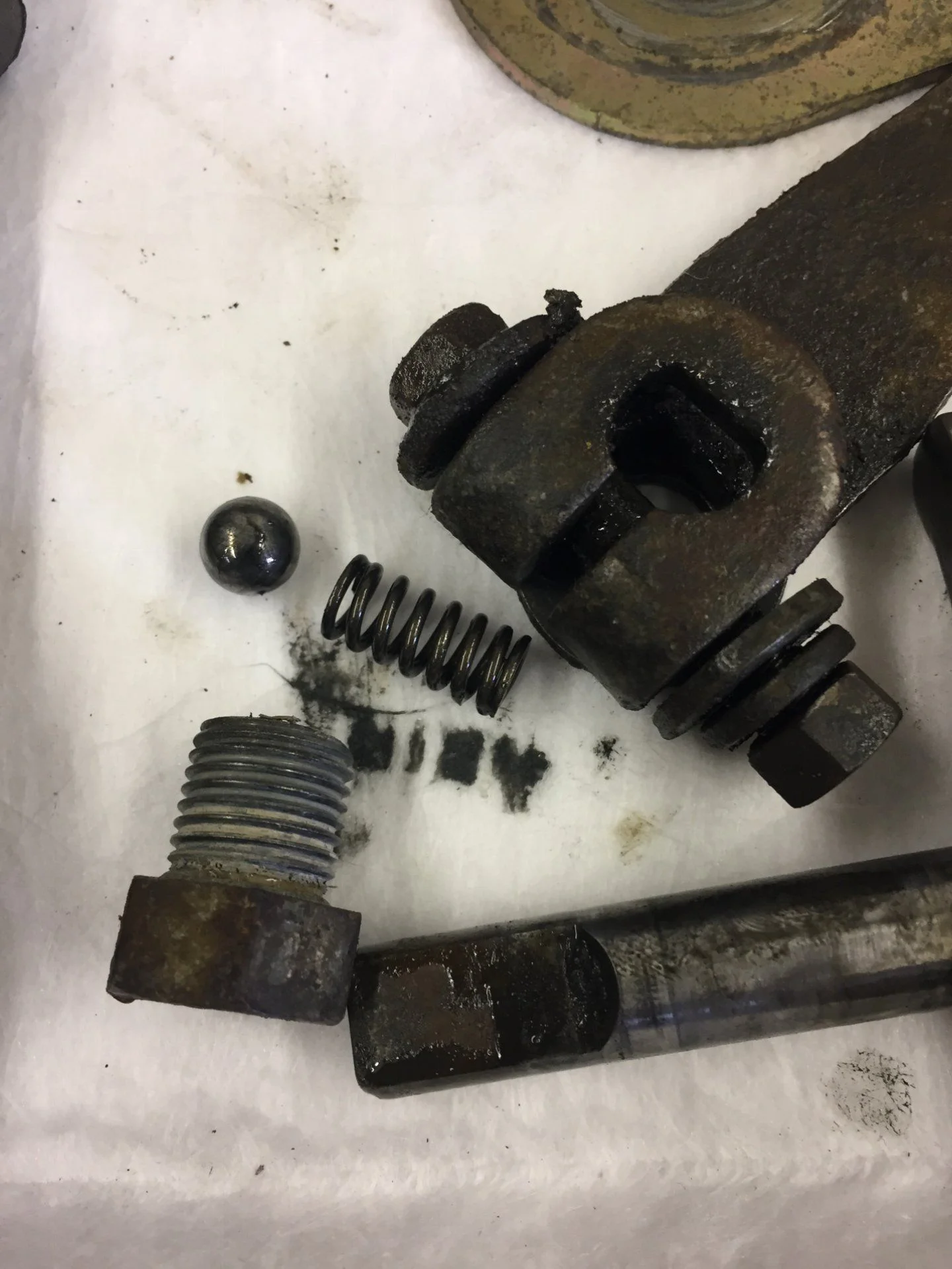

This is where that lever is positioned to inside. Right above the fork is the bolt with the spring and ball that holds
in the gear selection detent. That's the second photo.
if you removed the bolt and spring, used a small magnet to pull up the ball bearing then the selector fork will be a bit easier
to resist pressure when you pull up on the selector that has slipped down. That thing will only come up so far so if you are
able to lift it back to the correct height, you should be able to bolt it all back together and good to go.

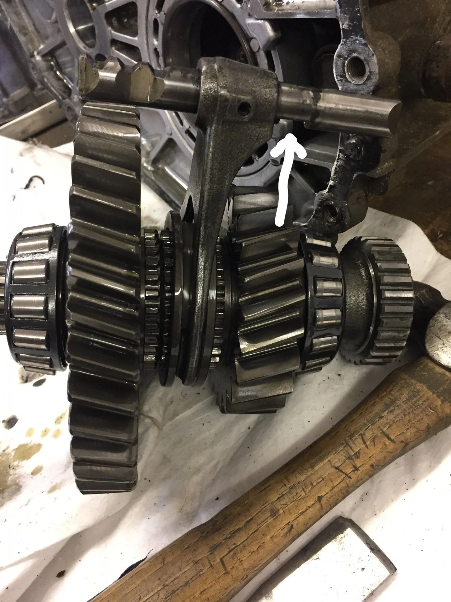

Yeah exactly the lever is still attached to the linkage, missing the bolt. the post is down in the hole unable to grab it. thought I might be able to pull wiggle it up with a strong enough magnet maybe. Thanks for the picture that's exactly my plan. was wondering what the peice is sitting on why it hasent fallen further, I don't remember or see where the notch on the selector fork bar. Is the notch where your arrow is?
Yes, the notch is hidden on the bottom at the arrow.
Thanks! Must be sitting on the ledge of the aluminum housing, pretty close to getting eaten by that gear.

I found a pic of the gear and shifter fork assembly on the table. The arrow indicates the notch. Easier to see on this pic
Then the three detents on the left side on top are 'high' first, 'neutral' middle, 'low' closest to fork.

The lever should be safe, as it's on the outside of the shifter shaft. IF it hasn't fallen in, then you should be able to fix this without any
internal issues.
