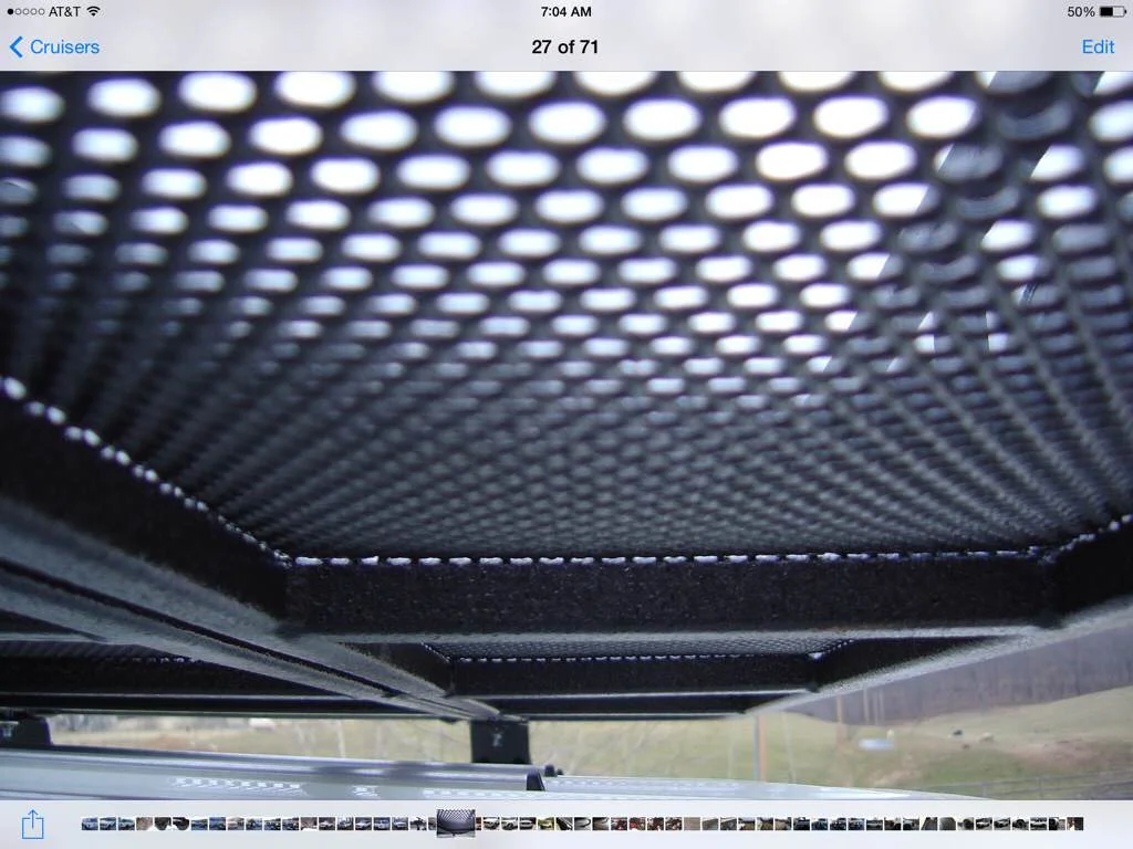

Instead of expanded metal which can be sharp edged, look into perforated metal.
...via IH8MUD app
When I bought it several years ago, this is what I remember. You select the size of hole you want and the distance on center between each hole. If I had to do it again I might get larger holes. It catches a lot of wind, as I guess anything on top does. I had to sprayed with rhino lining too. I does require some bracing between. I don't think it is as strong as expanded metal.

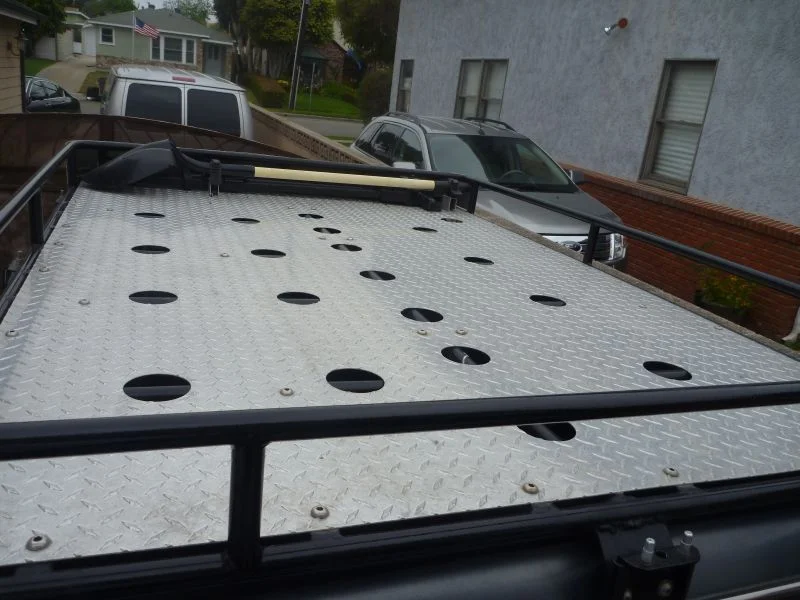

I used .065 aluminum diamond plate for my rack bottom. It's light, strong, and best of all...shades the roof, which makes the interior much cooler.
I designed my rack to mount various boxes and such, so I added nut plates to make attachment easy and quick. I used nut plates to attach the diamond plate also, some which double as accessory mounts.
For misc. attachments points, I made 3" dia holes in the diamond plate over the racks support tubes. These are used to allow strap hooks, bungee's, ropes, etc to connect easily.

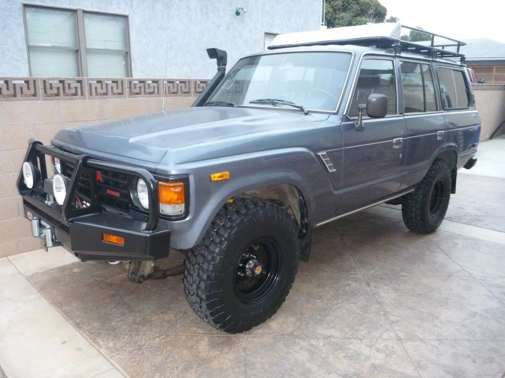

I also made a front nose piece to deflect a little wind, hide my hi-lift and shovel.
The rack is quiet and works well. All made in my garage.

Doug what tube size and wall thickness did you use and did you just thru bolt the diamond plate to it?
Sorry, we have been on vacation.
The tube is 1" and I don't recall the thickness, but I think it was .083.
I welded nuts to tabs and welded those to the bottom tubes. The aluminum plate and accessories bolt into the welded nuts so I don't need to get fingers under the rack to attach things.
