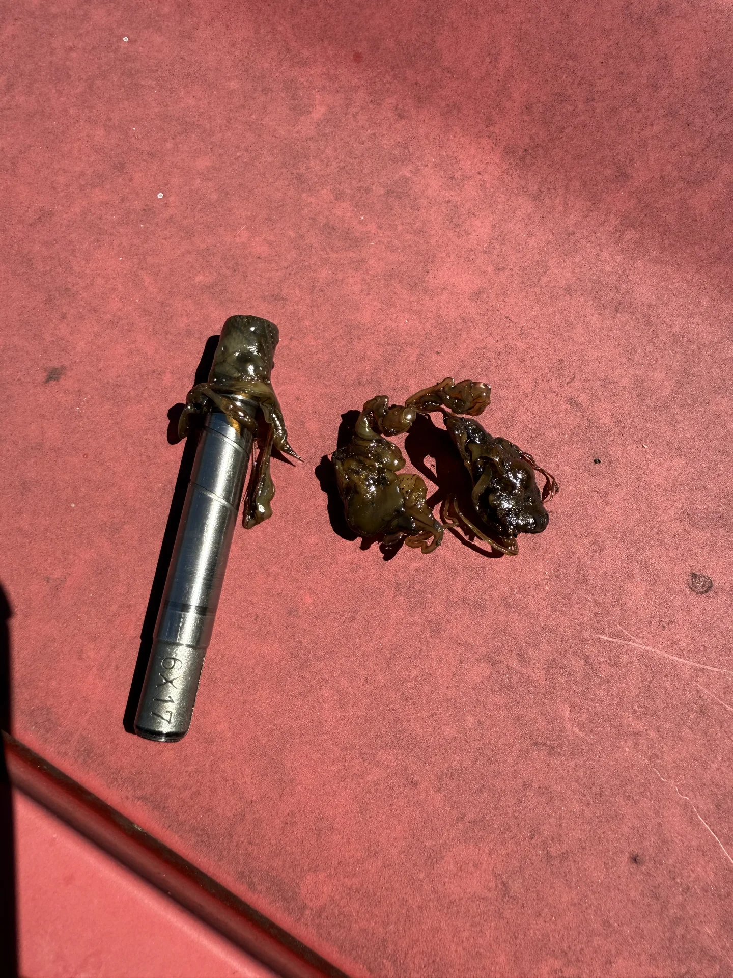

nuclearbeef SILVER Star 10 Year 15 Year Joined May 12, 2010 Threads 47 Messages 628 Location Memphis May 8, 2026 #1 About a mile from home returning from a 150 mile trip, my Speedo quit working. Upon investigating, I found the problem.
nuclearbeef SILVER Star 10 Year 15 Year Joined May 12, 2010 Threads 47 Messages 628 Location Memphis May 8, 2026 Thread starter #2 Turns out that most all of my gear oil had migrated to the transmission. Speedo gear melting caused me to investigate and (hopefully) avoid catastrophic x-fer case damage!
