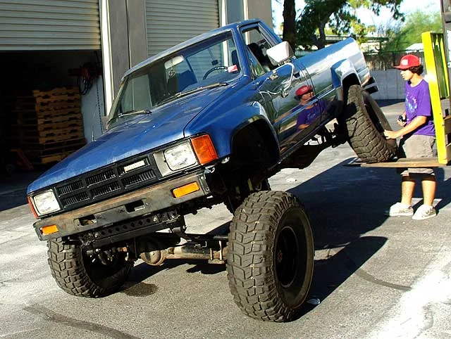

Specs on this sweet 4Runner?
Those are 1 1/2" lift shackles. The factory shackles are tiny. I'd invest in a High-Steer set up. That truck will steer like a brand new rack and pinion vehicle. High-Steer set ups start at $300 and you'll need a steering box from an IFS truck (junkyard, no biggie) well worth it.
Nothing wrong with the drop drag link. Just service it.
Those shock towers are factory all the way. You may nee to put a taller bump stop on to keep the shock from compressing to much. Drop isn't an issue that I see. (That is with the OME springs installed) Shackles will give some better lift and added droop!
Try it, you'll like it. Then later, if you decide, Hy-Steer is way better and worth the time and $$ :D
My old 85 with 3" Downey springs, well seasoned and Ford shock towers, pre hysteer:D
I'm not a big fan if push-pull steering, but do prefer the "ball flip" to bent links, it also helps with u-bolt clearance.
J-Arm Ball Flip info
Anticipation
