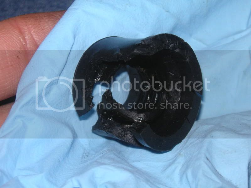

so i've been trying to get what i call the spark plug grommet that seperated from the wires out of the spark plug column :doh:
i bought some of those handy picks and only retreived part of the spark plug grommet. The part that is missing from the pics, represents the part that is still stuck in the spark plug column.

You should keep trying to get it out. Lay a wood plank from the right fender to the engine's front tow eye - pad the fender. Bring a hand mirror, get a light on your head, and use the pick with your other hand. When you've got it loose and just chunks are in there take a soda straw and tape it into a vacuum crevice tool so the straw will reach all the way down and start pulling the little bits up and out.
I'd try very hard not to get something down there that might either bend a valve stem (think hard rubber between edge of valve and piston top) or chunks of rubber lodging in the EGR valve (#6 cylinder directly feeds EGR) or catalytic converter (melting onto catalyst, etc). It just makes good sense to put up a fight on this. Hope you've already ordered a new set of factory plug wires from Dan, too....
