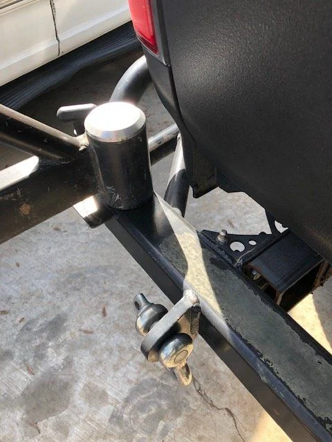

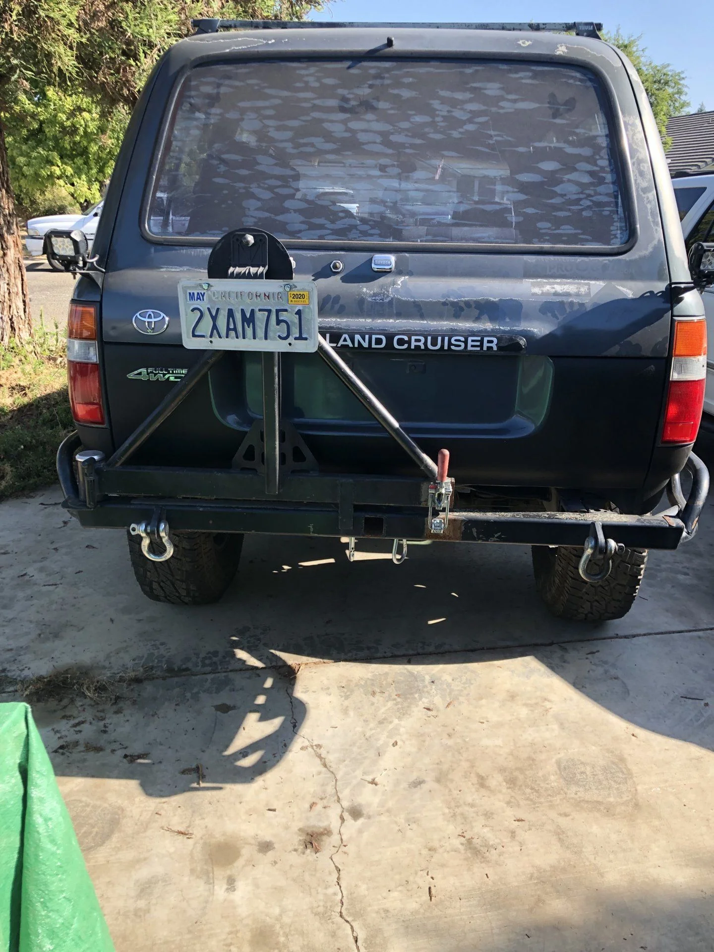

My sad and lonely spare tire mount-

Any other pics of that bumper? I'm a fan of simple designs!

Thanks for the bumper pics by the way!
