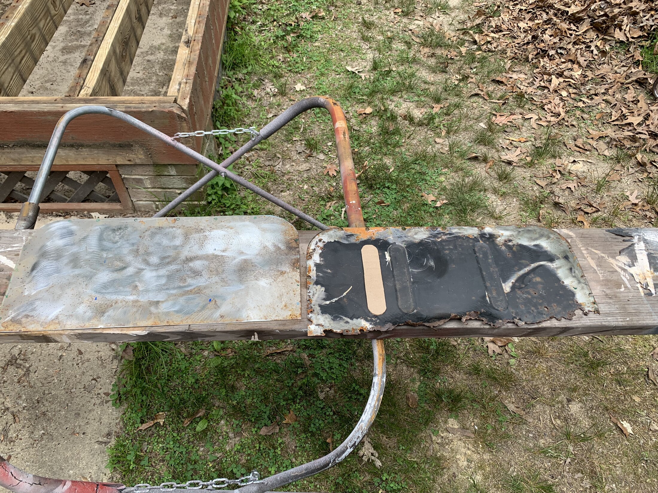

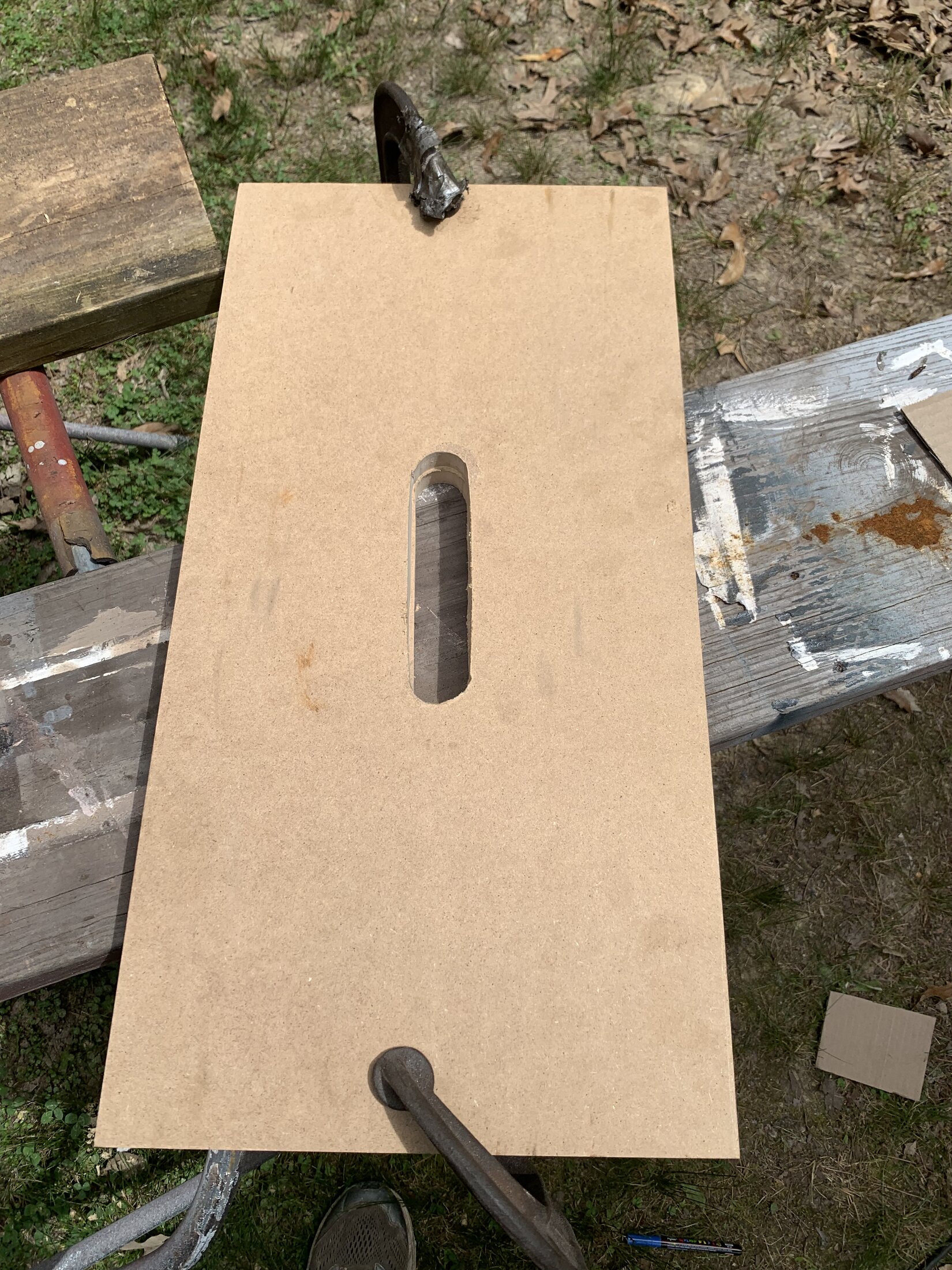

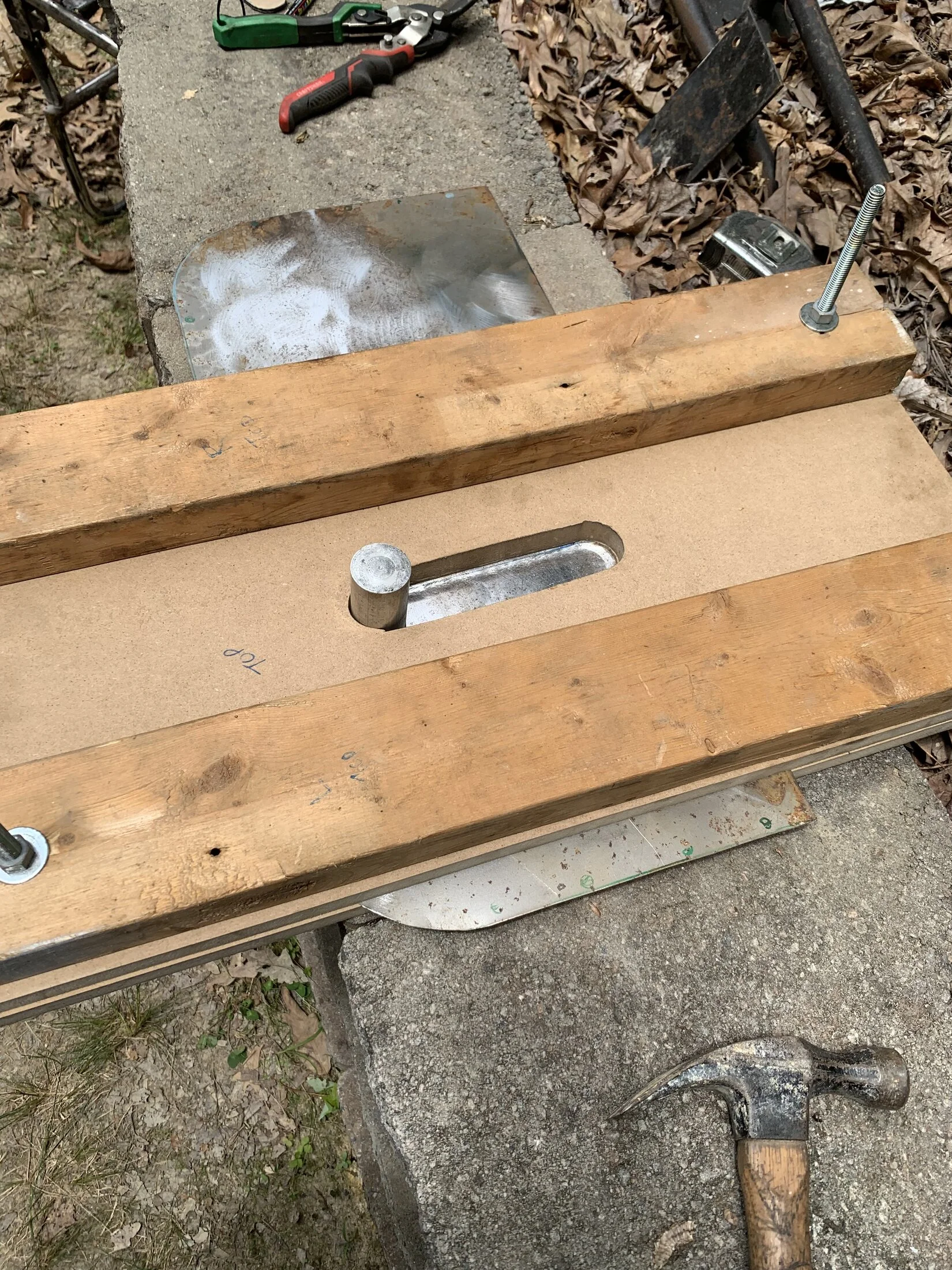

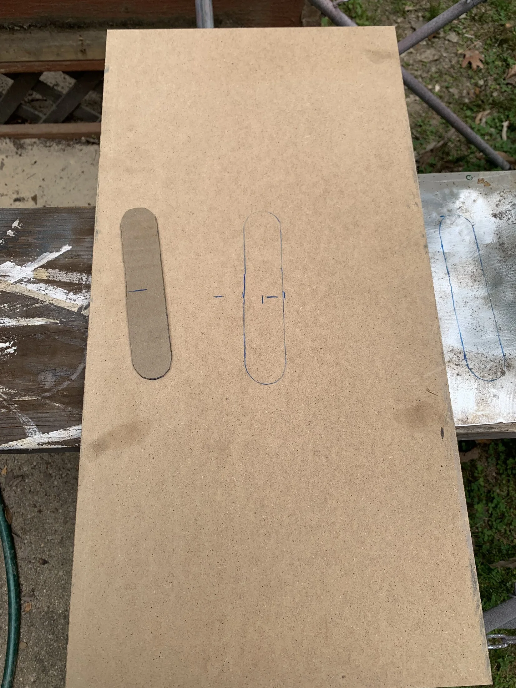

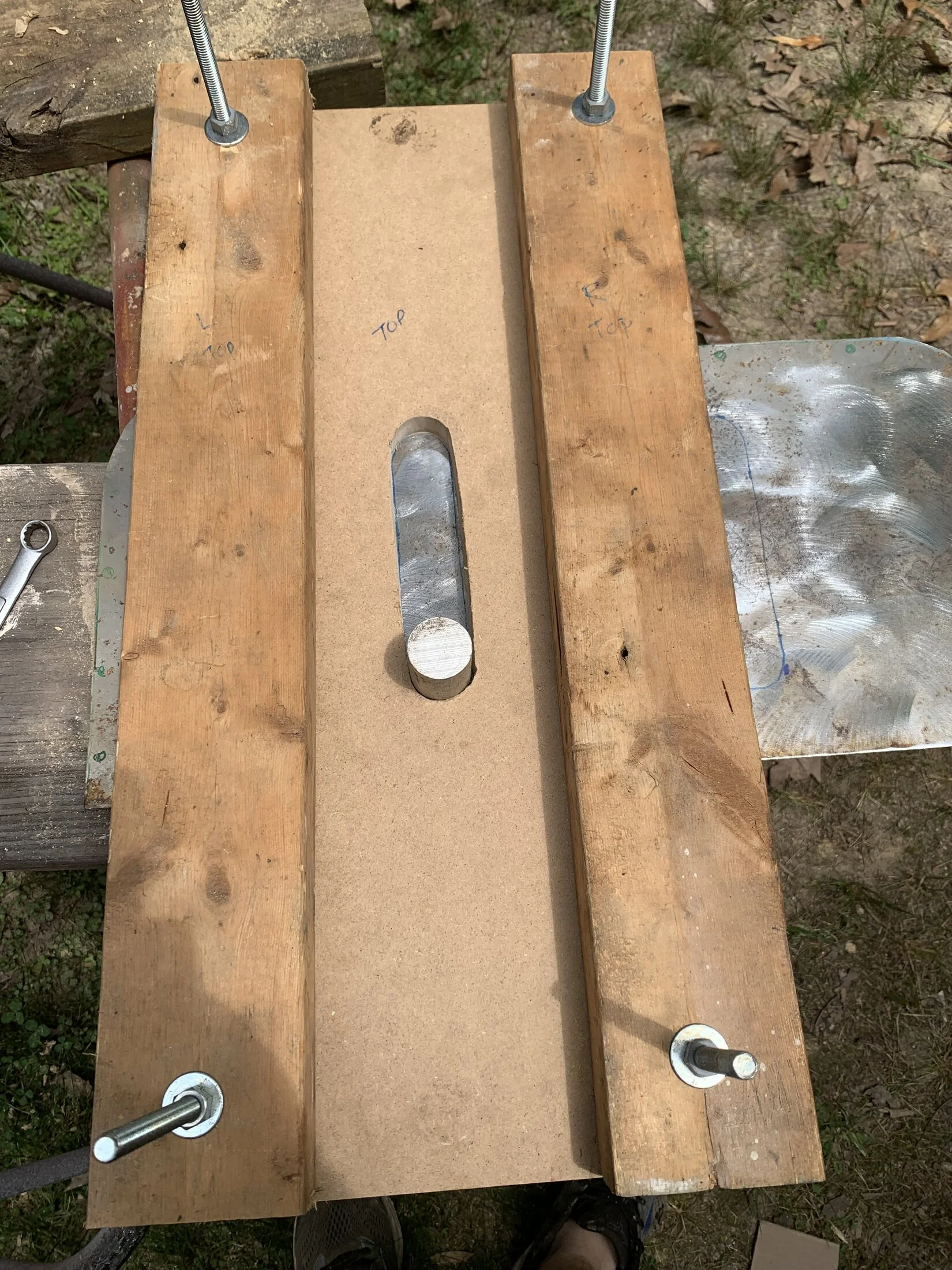

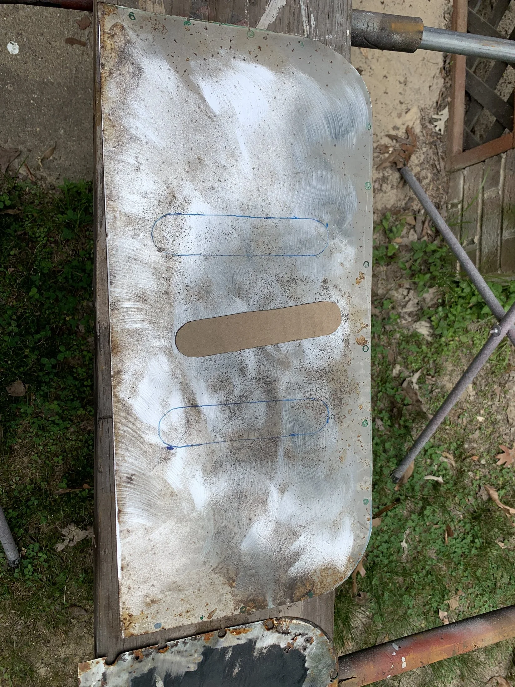

I had an aluminum solid piece I picked up at a metal recycling yard (seen above). I used this as a form and hit it repeatedly with a hammer. Made a small chamfer on the end too. I used a metal plate under the sheet metal to provide the correct depth. Grinding the metal sub-piece so that it fit in the MDF relief took the longest time.

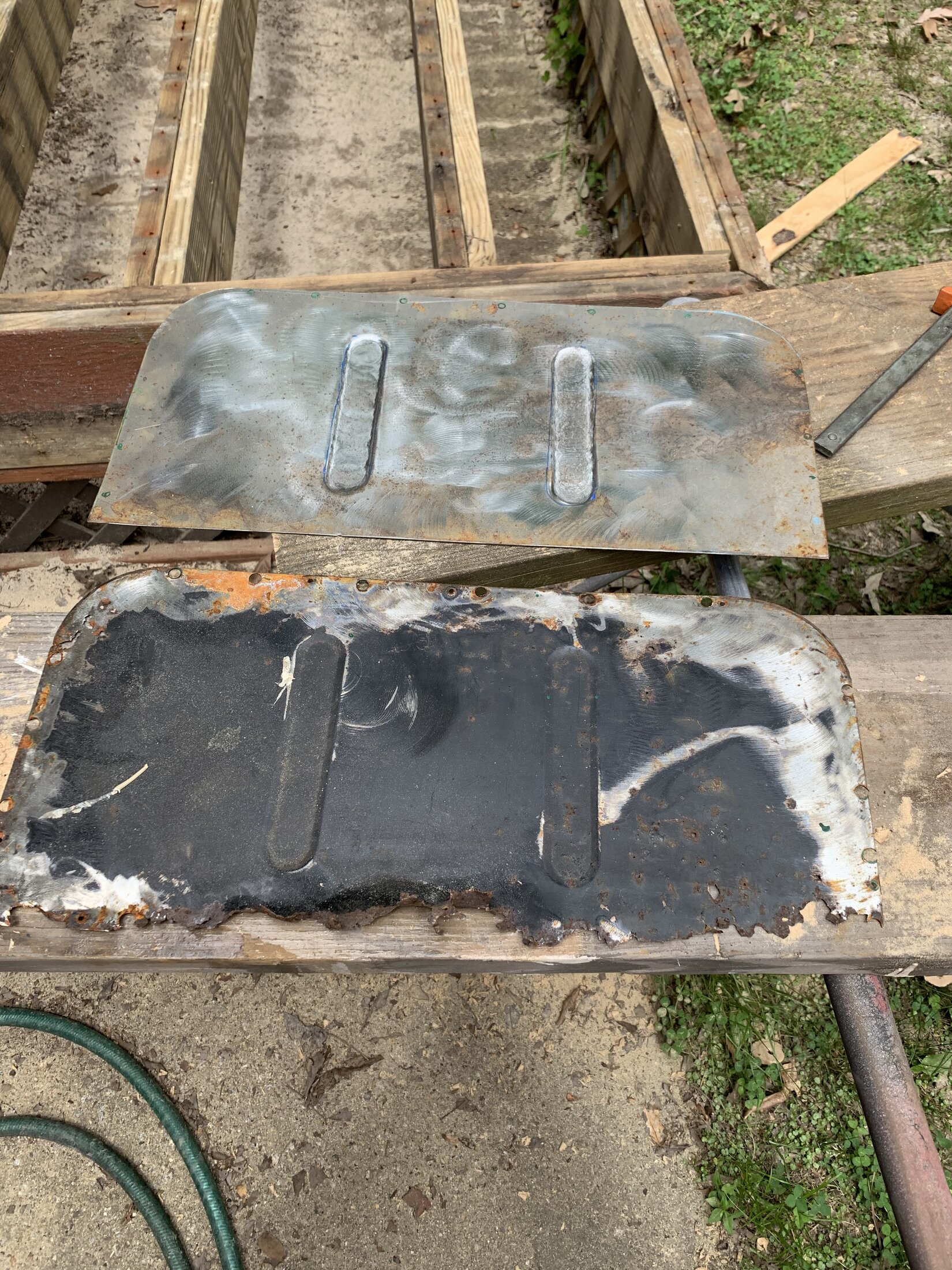

Below is the old piece and new piece side by side.

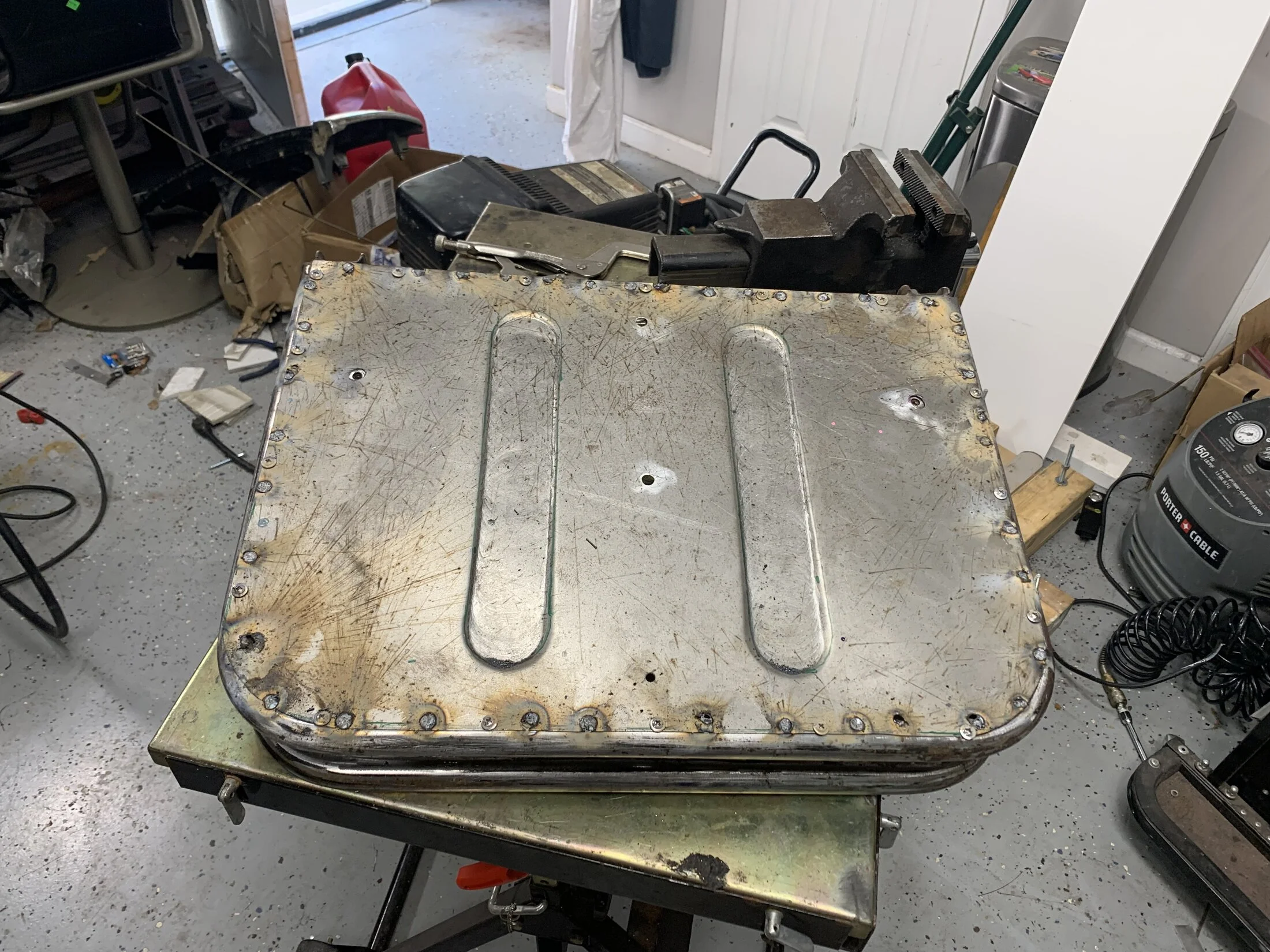

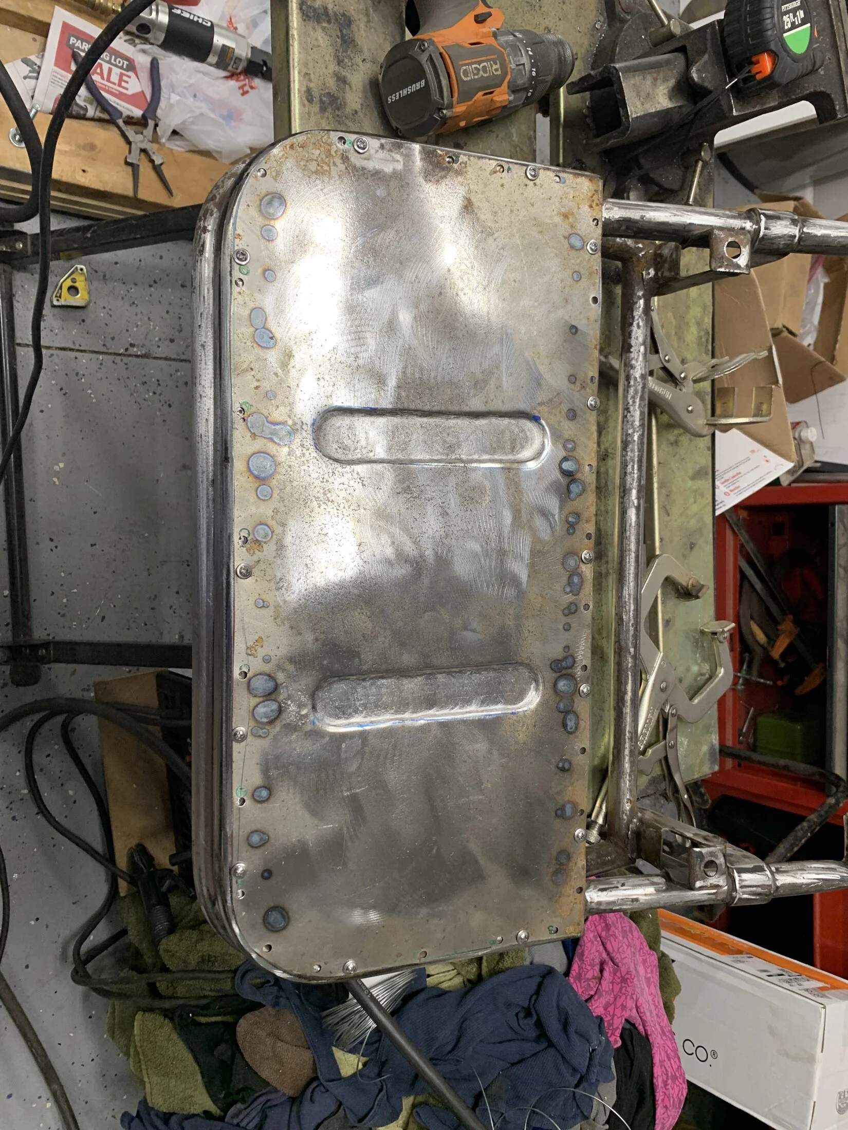

Also, I did not show it, but used a pneumatic Harbor Freight punch to punch out holes around the perimeter to spot weld. That tool may have been the coolest part of the project.
