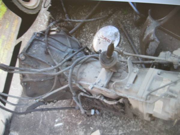

Folks, I am in need of a low mileage used tcase for my 94 80 series. Anyone have any leads or know of a reputable source?
Frank
Thanks for the referral. I am out of T-cases right now. I estimate that over 500 Dead Cruisers are being resurrected nationwide, based on the number of inquiries I am getting daily for collision and body parts. I am glad to see all the cruisers being put back on the road; this has always been a goal.
Depending on what you need there is a full rebuild kit with bearings and gaskets available from cruiser brothers or cruiser teq
Also a couple used ones on craigslist adds in sun vally and chatsworth
Thanks. I called them. I might go with one of their units with lower gears.
