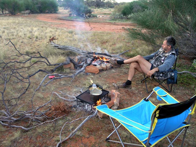

Here's the campfire/cooking setup we typically use in the oz bush. Excuse my mate in his boy shorts :)
Basically one large fire or heat/light and a small cooking fire. Much easier to cook over a little fire that you can adjust the heat output by adding/removing wood as needed versus over a raging fire....
3/8" steel plate with 4 legs, either welded directly on the plate or screwed into coarse thread nuts welded to the plate so it can lay flat when not in use. Slip it all into a canvas bag to keep the soot/grease etc off the rest of the gear in the vehicle. There's 1/2" rod welded to 3 sides of the hot plate to keep stuff from rolling/slipping off if cooking directly on the plate. The 4th side has not rod, to make it easy to scrape off excess grease/fat/oil etc.

I can see George's pics. it is pretty much just as he describes, like a griddle on legs. the legs look to be about 10 - 12 inches long.
