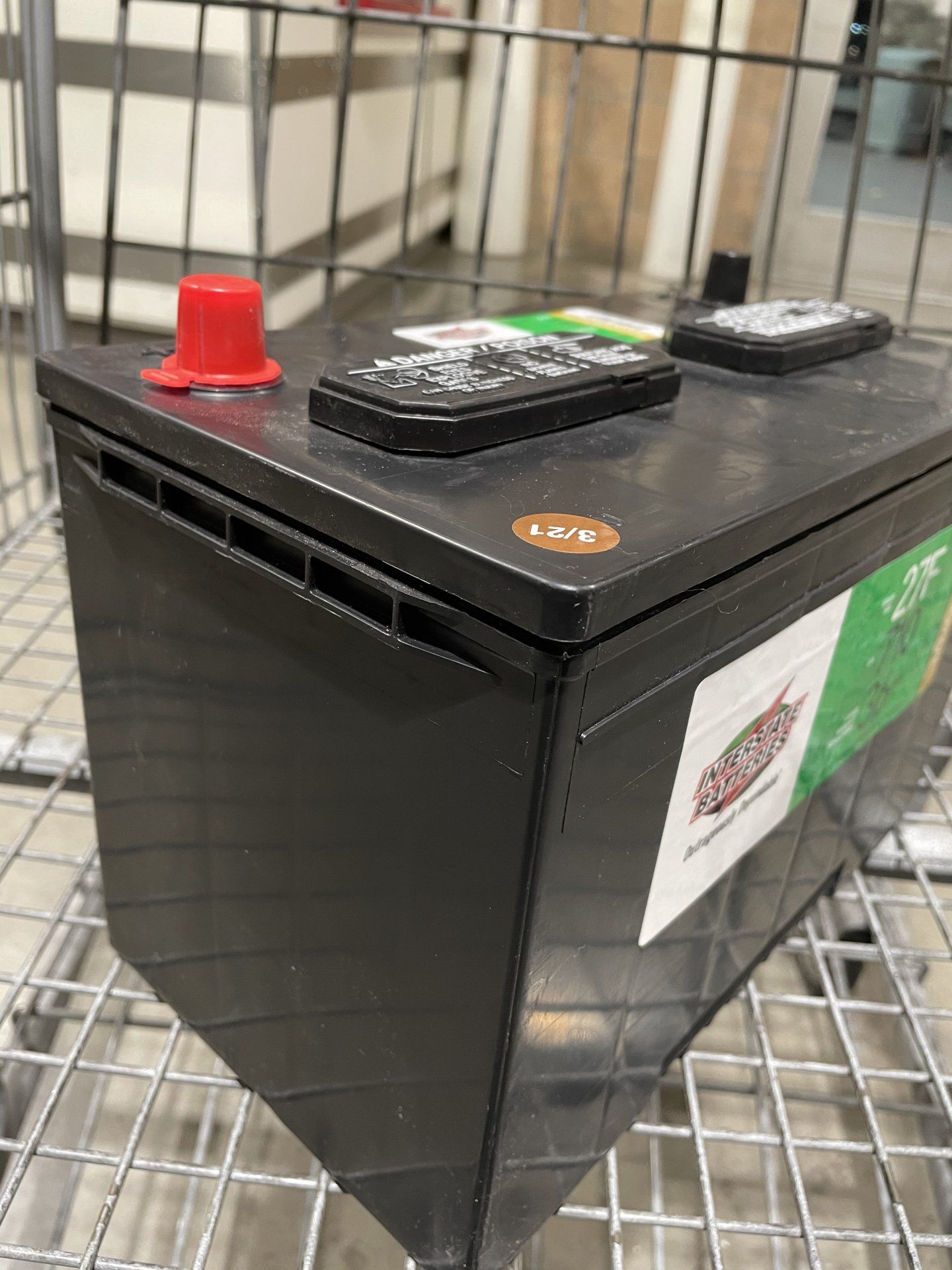

27F gents, how’d you manage to install your battery from Costco? I just realized this doesn’t have any handles on it? :censor: Should my kids expect a round of cursing for today’s DIY?
No issue, just picked it up and set it in. Move your cables out of the way first with a zip tie to hold them or a bungee. The handles are overrated.
