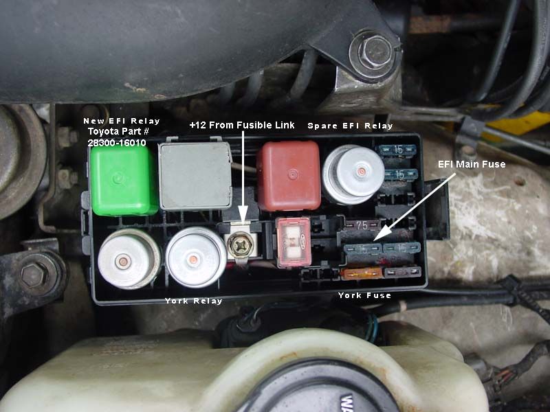

Here's a little tidbit for you before you go and move the EFI relay.
28300-16010 is a direct drop in replacement for the EFI relay and has a plastic housing as opposed to a metal can. It has worked without issue since I installed it sometime around 2004. There are also 2 unused relay positions in the fuse box that fit and hold spare EFI relays. In this picture I used one for the York OBA system.
Nice! How did I not know this about the direct fit replacement?!?! Crazy! Thanks. I will order it this morning from Toyota. I moved it in to the cab last night but that will take 2 minutes to undo. And didn't cost me anything.
