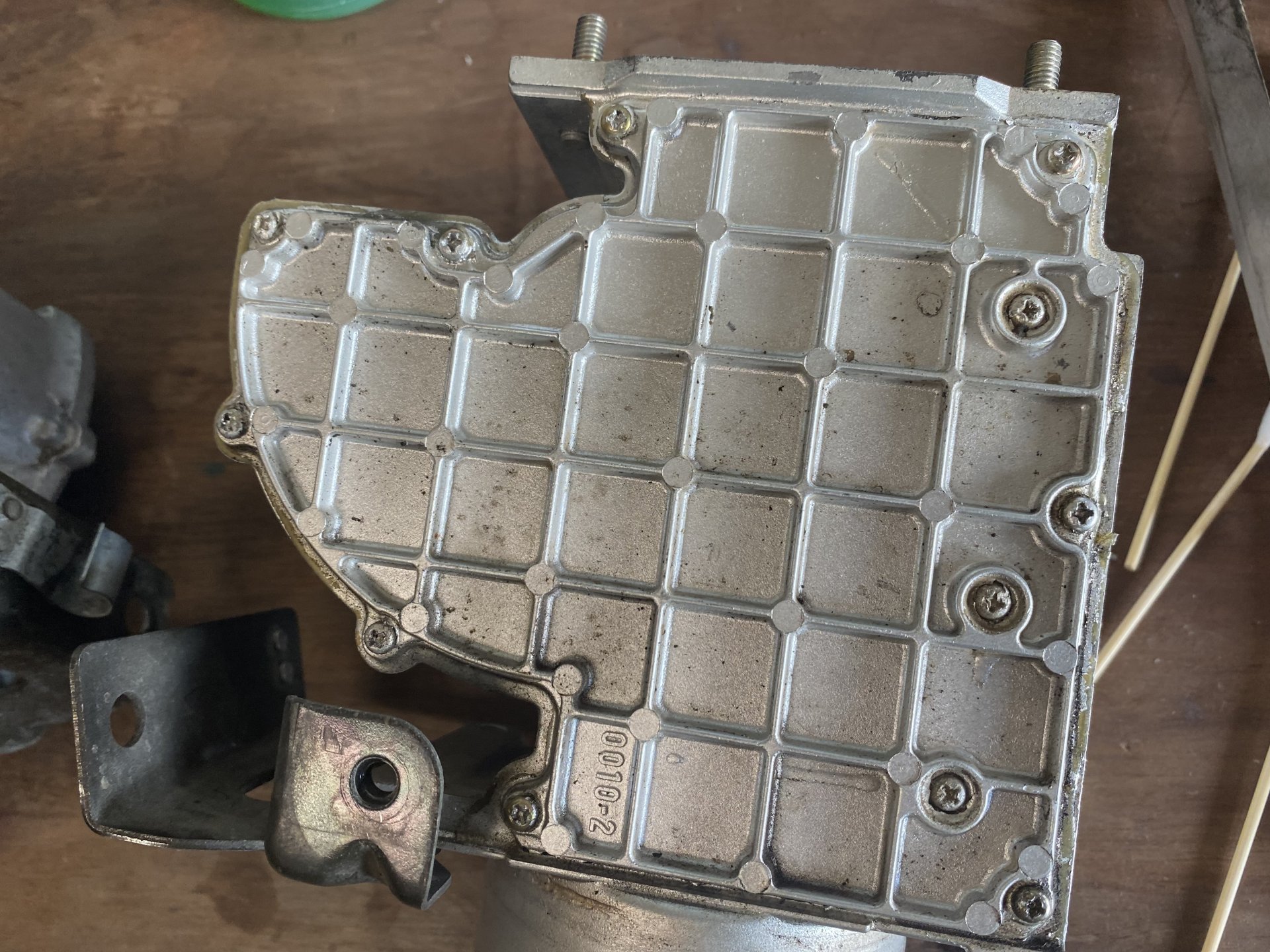

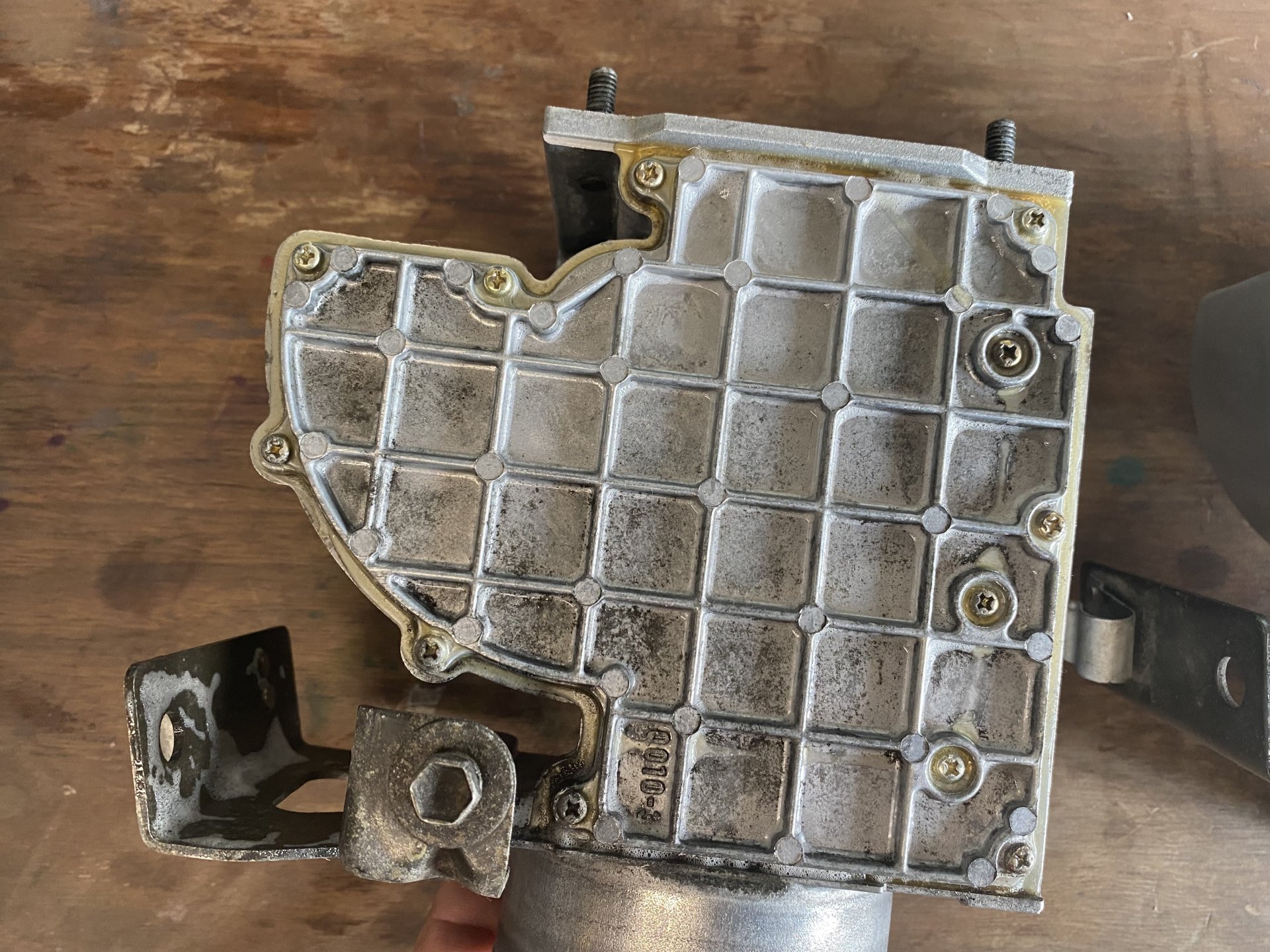

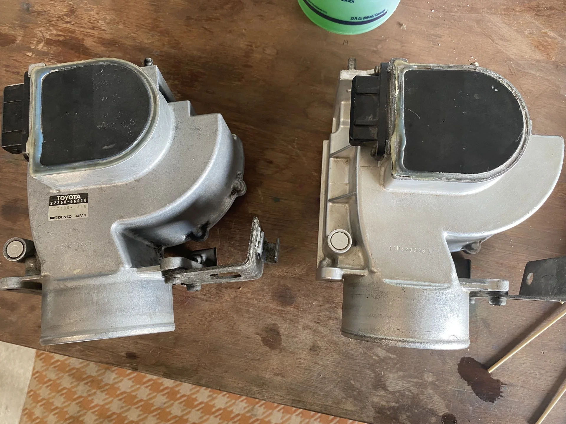

Here are some pics. Let’s see if you can spot a difference. The one off my cruiser is on the right.
The one off my cruiser is cleaner and looks to have been painted. Which got me thinking. Here is the bottom of mine. You can zoom in and see where it has been painted if it isn’t obvious already. I suspect this VAF has been opened and tampered with by an eBay dude who sells refurbished VAFs. I also bought and returned a VAF he sold me. I don’t want to say anything publicly so if you want my experience, PM me and I’ll share

Here is the one shocktower sent me:
Now that I have both VAFs side by side, I began comparing values. When shooting for continuity on pins E2 and VS, both VAFs got similar values with the door closed and full open.
Then I compared pin THA on both VAFs and looks as though my THA pin off the cruiser is dead. I shot this the last time and it was functional but it has since failed as I’m shooting open every time.
It never occurred to me that my VAF looked a little too good. I have never seen another VAF so that’s my alibis.
Bottom line, I think this is the culprit but time will tell.

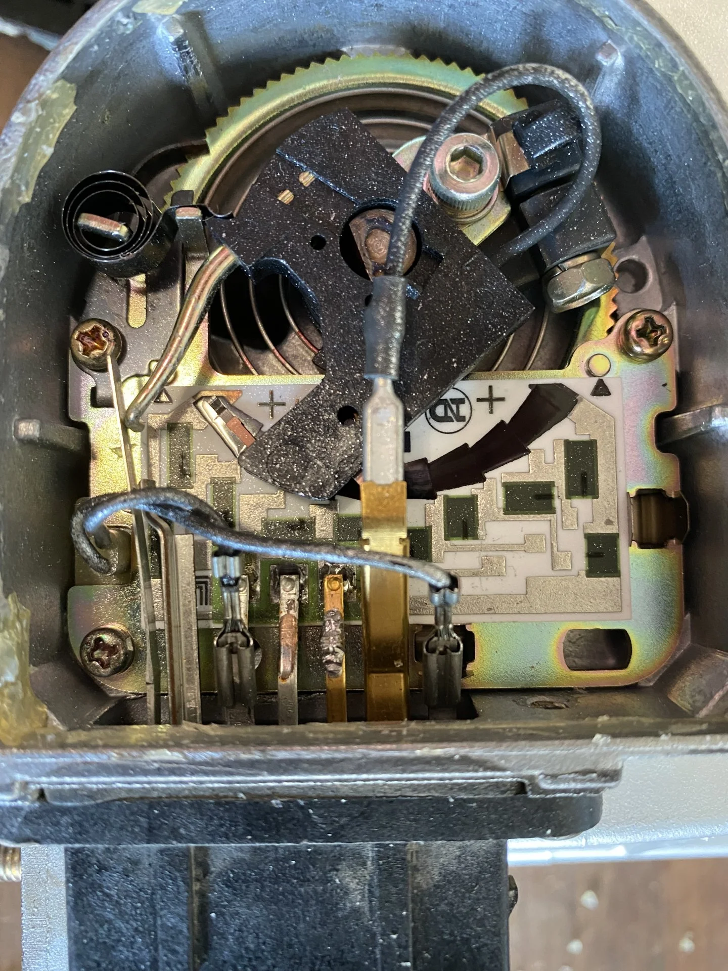

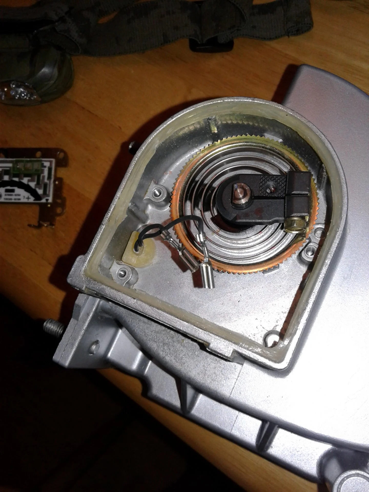

Glad that it was any easy fix. I'm curious as to what the inside of the original VAFM looks like. Since it has been opened before, could you pull the black plastic cover off and take a pic of what the internals look like. I'm thinking that the little flat metal arm that makes contact with the clock spring at close was bent or not making good contact and that was why it was intermittantly cutting off.
I’m curious too, I’ll look up how to do it and see if I can provide the mudship a worthy contribution. Expect to see something soon, maybe today but no promises.

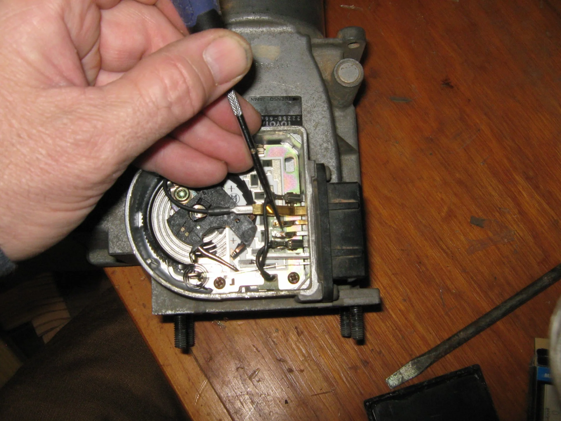

The little black cover will pry off once the sealant is cut away. Just take a pick or similar to pry up the cover. Here was what mine looked like after my attempt at resoldering the tabs. Yours may be worth saving for a spare. My bad one still works but it shows code 24. I replaced with a good used and now have the original as a spare. These VAFM's seem to be the biggest weak link in the older obd1 cruisers and it would be good to have a working fix for people in the same situation.
Did you repair it yourself and did it Ops check good?
I boogered that one up all by myself. Yours looks like it was booger soldered as well. I didn't do any meter testing. I did the trial and error method. I got very good at taking it out and putting it back in to test the fix. Overall, my old half-ass repaired one does work fine, just has the 24 code, no other problems. I need to upgrade my soldering iron though. You can read about my VAFM journey here: My first 80 - https://forum.ih8mud.com/threads/my-first-80.1170546/ @slow95z and @ppc were big help. In hindsight I should have jumped on the used one that slow95z offered, but in the spirit of rebuilding not replacing I gave it a shot. I later found another used one for sale and just replaced the original.

Yep, I remember reading your thread. I'll keep the malfunctioning VAFM and see about sourcing another one. I really want a new one but someone swiped them all and I missed out.
There sure doesn't seem like much to it. I see a contact that I assume opens at minimum and the sliding rheostat that moves with the vane.

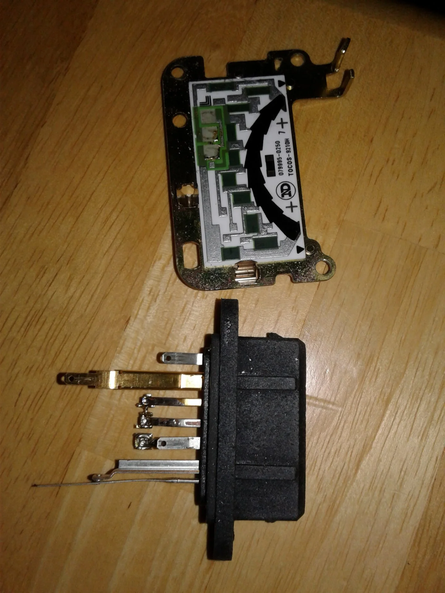

FYI and FWIW. What I learned so far and please excuse any translation gaffes between the smart person that explained it to me and the jabronie explaining it to you. Those three pads on the PCB where the pins from connector attach aren't "normal" pads, but they were manufactured with a dry film on the pad containing the traces. When you try to re-solder on those pads, you are most likely destroying the conductive dry film with the heat and making things worse. (You can see the remains of that film sticking to the connector pins on my one pic.) So the challenge now is not to try soldering the connector pins back onto those non-conductive pads, but to figure out how to solder the pins directly to the traces on the board. This is probably why above it took a few tries soldering them back on before a connection was made.

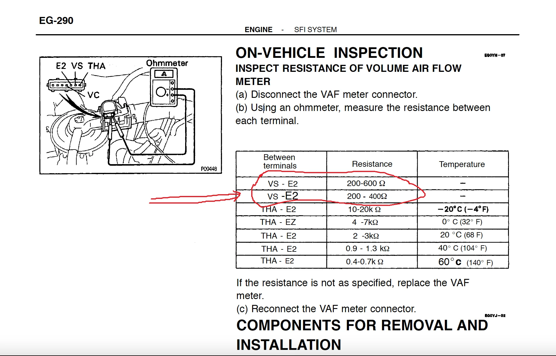

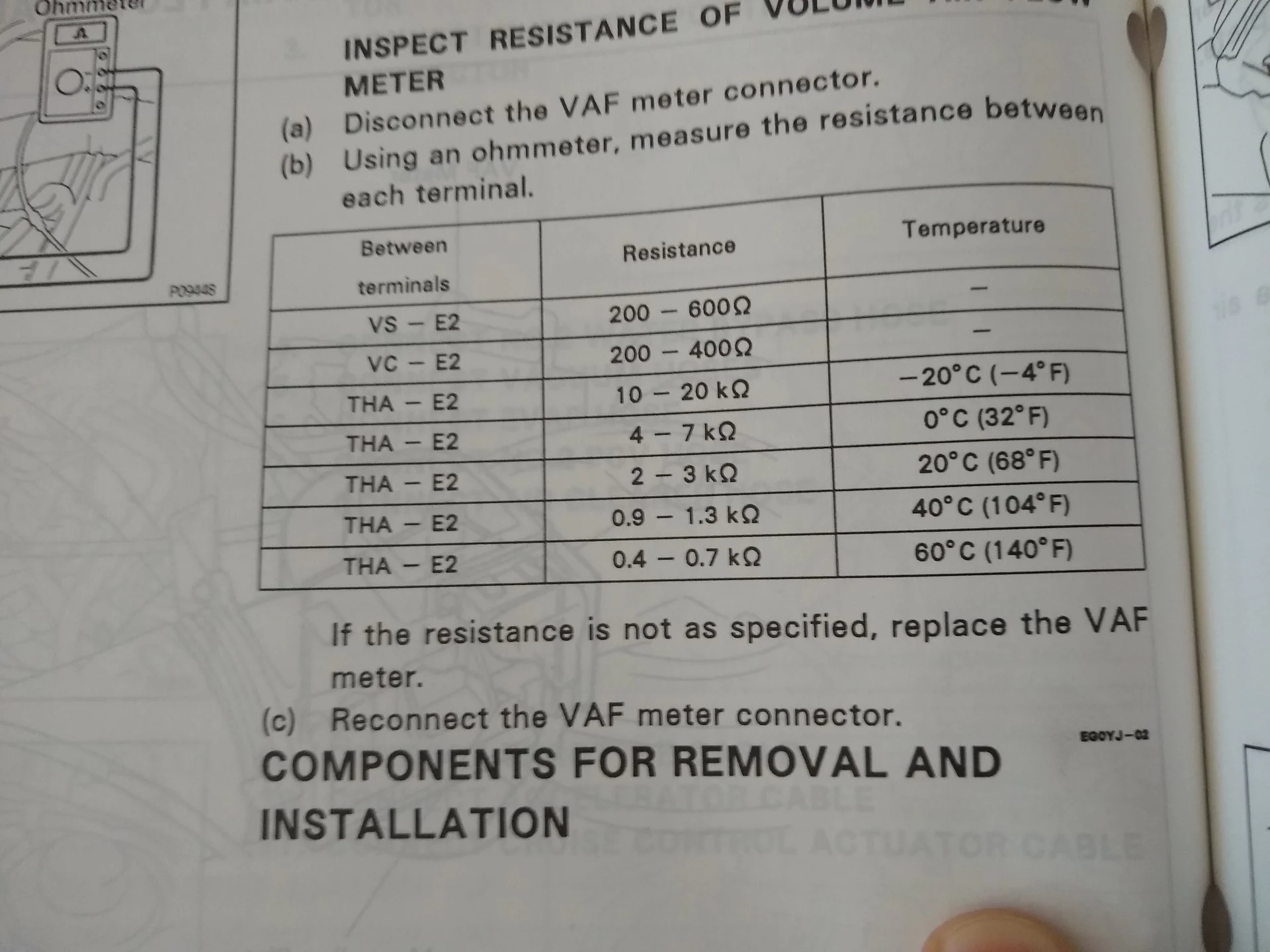

@FMC80 is there a mistake in manuals table? The two first line in the table reads the same pin different resistance???
I noticed that when I was troubleshooting mine as well. I am not sure why it’s like that beyond temperature values determining the differences.
I don’t have the FSM in front of me but there is another chart that has the correct troubleshooting format with proper values so I used that one instead. You should be able to cross reference the troubleshooting steps to find it.
