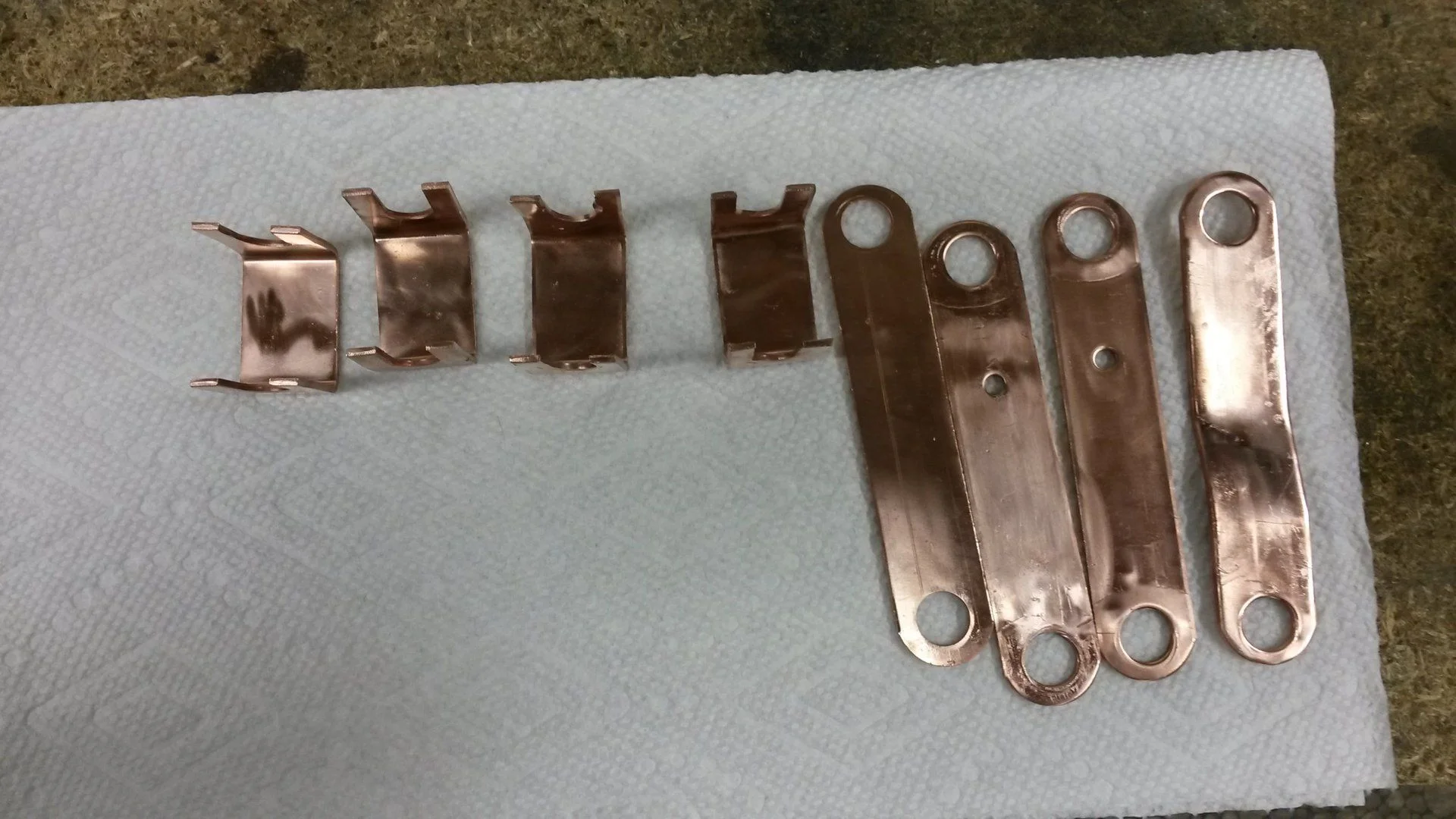

On a side note: Some 'jewelry' for the rebuild (parts from two control boxes):

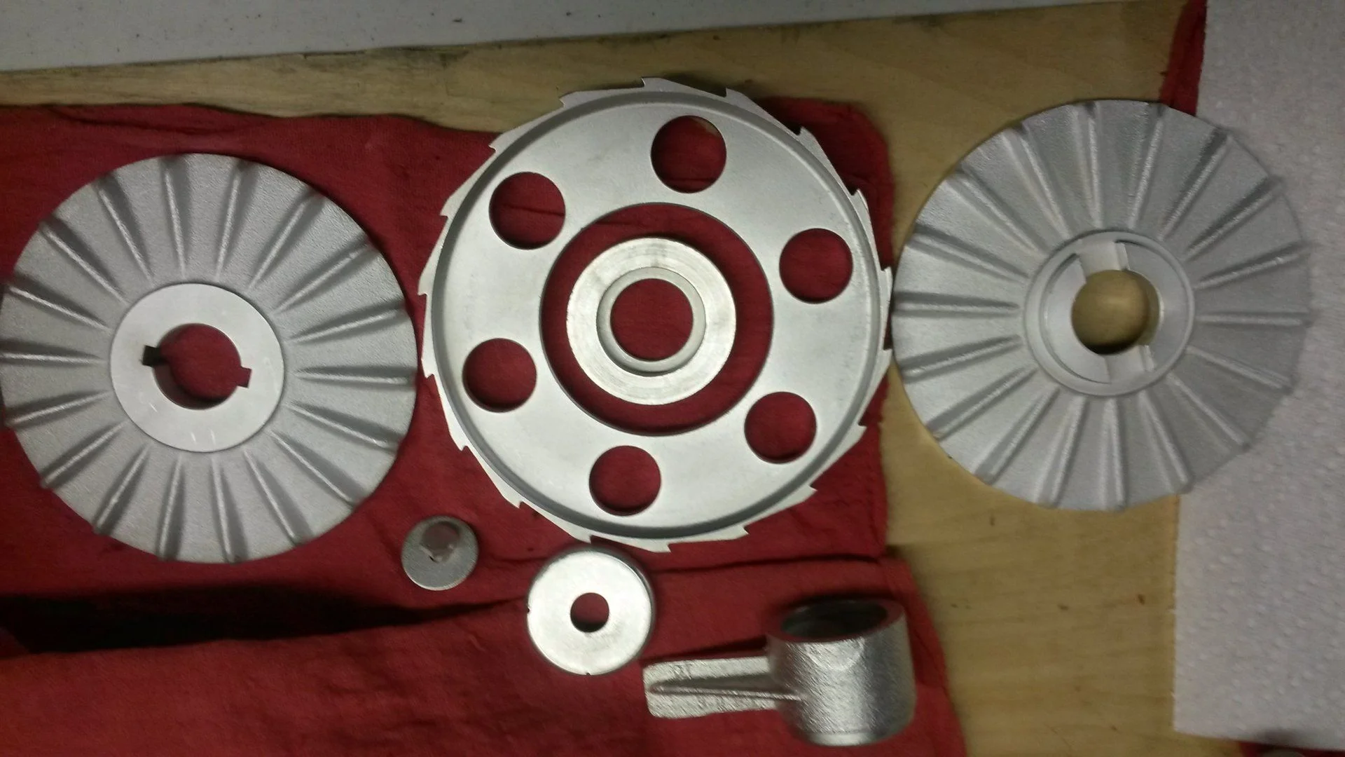

So.... I took the mounting plate over to my local plating place. They had previously done the cadmium plating on all my 8274 brake parts:
I told him that I didn't want to spend over $20 on it, and he said I won't: It'll be free. Nice! Should be done in a couple of days.
