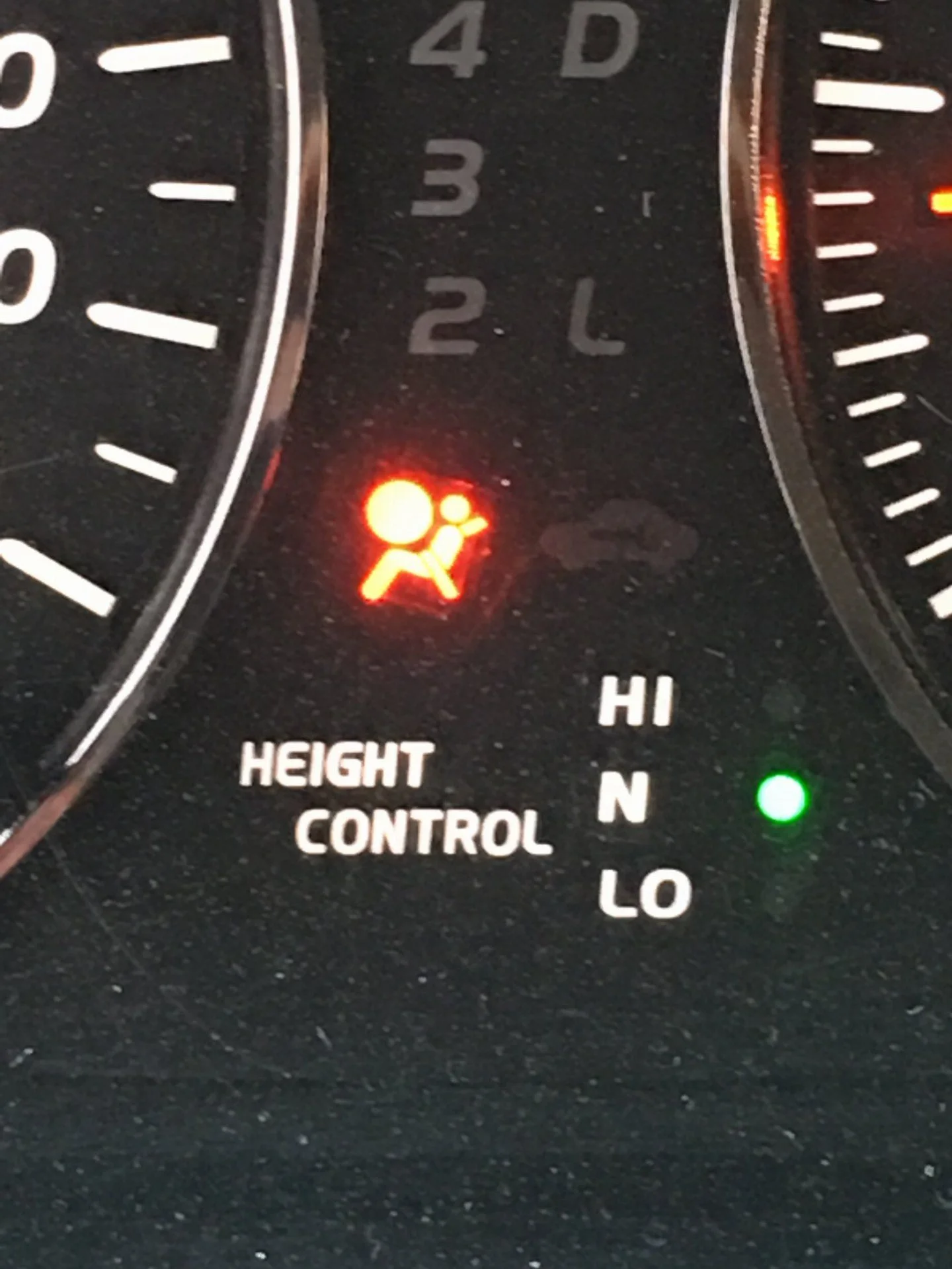

I need help clearing the Airbag light on the dashboard. I'm not interested in paying the dealer 2500 to fix some Airbag issue. Anyone know how to clear it other than taking out the instrument cluster and removing the bulb?
Which airbag light?
have you had the recall done?
I haven't. I just bought the GX a few days ago. Should I drop by the dealership?
I would say yes, but they might tell you that since the light is on, that you should drive it. maybe just call and find out about it.
I would be more concerned with resolving the fault than simply eliminating the light - airbags are there for a reason! I bought a ~$20 Techstream cable from Amazon and use that. You can view all codes (more than just OBDII) that way.
Call first and tell them you haven't had the recall. Then they can order the parts and schedule an appointment. It only takes a couple of hours. The dealership will give you a free loaner and should fill up your tank for you when they get done.
According to the dealer there's no recall for my Airbag issue. I ordered the Techstream for further diagnosis
