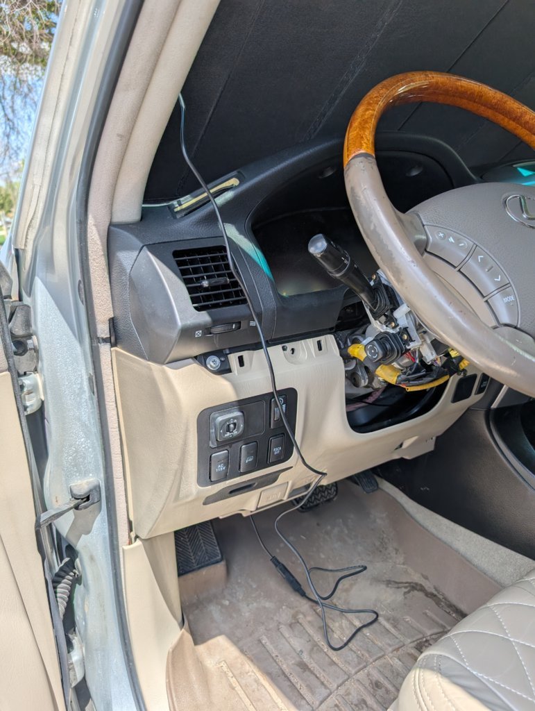

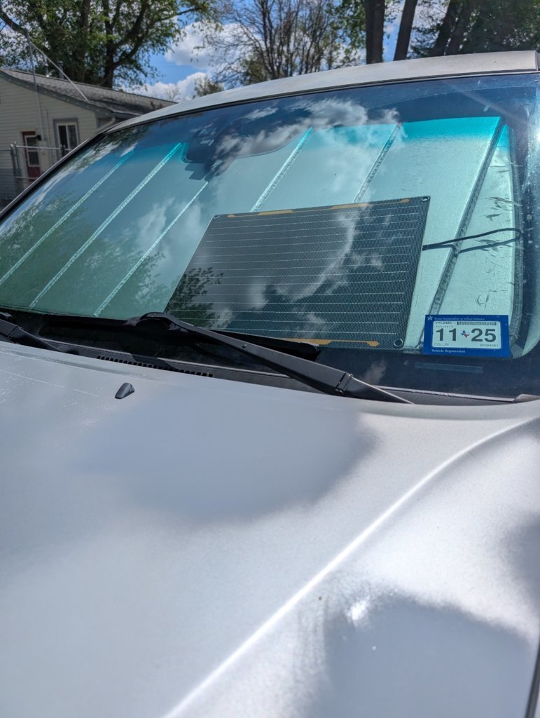

I bought a couple of the Project Farm recommended solar trickle chargers and just got it today. It has a few different connector types: direct to battery, cig lighter, and ODB port. Either the cig lighter isn't constant, or I forgot to hook it back up when doing the HU upgrades. It doesn't charge through that with the engine off. But it does through the ODB port. It even charges through that with the engine on. I've read that it's ok to do that, but have my doubts. I'll just unplug it before driving. I'd prefer it was direct connected to the battery, though. I need to see exactly how much cable I have to work with, and if I can run it through the firewall.

I put one last fall since my GX was going to be parked all winter. Direct connection to my battery and sitting tilted about 30º on the dashboard. Either it wasn't enough charge or not enough sun but my battery is dead, down to 2.5 volts. So I'll replace the battery when I get back up next month.
The kit did come with a connector for the he battery also. I wired it directly on my E46 M3. Trying to see if I can get away with two chargers for my three vehicles, and just swap a panel out between two of them. I'll either order another battery connector or just get a third panel kit. They were only $33. This was rated at the top of Project Farms list.
Also the fact that it charges through the ODB port with the vehicle off, leads me to believe part of my battery drain issue was leaving the Joying HU ODB reader plugged in. At least others have pointed to it being an issue. Haven't had a dead battery since removing it. But can't say 100% that was it until I start testing for parasitic draw
I rigged my OBD2 reader so it's only powered with the ignition is on. Had to custom make a OBD male-to-female cable to do that, and I have the power pin ran off of a fusetap on the interior fusebox.
