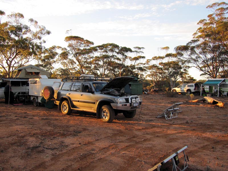

In fact for vehicle use having the rigid panels NOT mounted is a benefit. You will be giving up a LOT of your panels' potential power output by having them fix mounted (to roof or hood or whatever). The panels REALLY need to be facing the sun (as perpendicular as possible). Having the panels on 20 to 30' of cable means you can locate them more optimally versus having to park the vehicle in a certain area/direction etc.
Do you plan to move the vehicle or tip it on it's side to aim the panels at the sun several times a day? :)
Lots of folk in oz run solar panels (it's a natural with the amount of sun there and large areas of relative low/non-existent trees) and having the ability to move/tilt/relocate the panels is a major plus.
Trip in the oz bush ~nov 2012, near dusk. All the panels were later rotated to face the direction of the rising sun in the morning.
cheers,
george.
George, a ground stand is not something I had considered, but seeing your picture above, I think that's a great solution! Did you make those stands yourself or do you have a place you sourced them from?
