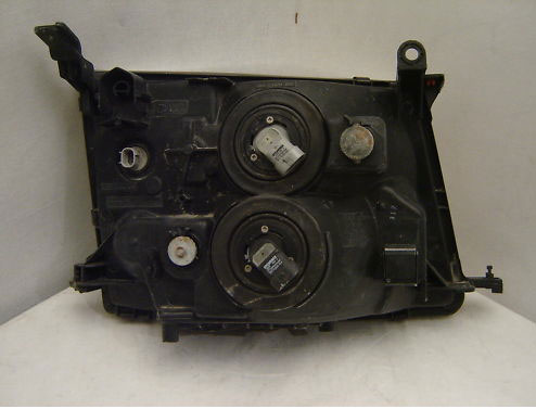

Okay, found a pic. So, the HI-beam is on the bottom and the LO is on the top, right? If you can install the Bi-xenon projector into the housing while retaining the existing HI-beam bulb, then you can have HI/LO and the stock DRL's all at the same time.
But like LJ mentioned, you can also get rid of both stock HI/LO and go a different route for the DRL's... whether it be a smaller bulb, angel eyes or whatever floats your boat.
