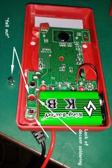

THOUGH - while open, check the soldering. Here's a HF meter that I had spare - just checked it and it was rattling inside... Opened it up and the +ve 'socket' had fallen out due to piss poor soldering - see picture below. I've soldered it up decently now.
EDIT: I would **NOT** trust them to measure 110VAC, regardless of the B/S Cat rating they claim... 12/24V DC stuff is all I'd recommend...
EDIT: Remove the board for soldering so you don't 'melt' the plastic 'guide' for the 'socket'.

It's amazing how little there is in there considering how much the thing does. That's Electronics for you. How things have changed! You should see the size of some of my old power supplies... Not to mention the nominal cost of the thing when you think it took a 10000 miles trip to get here probably.

Today, I was doing some more creative charging of NiCads and was using several multimeters. I was using charging currents below 200mA most of the time. The HF was doing pretty well, actually, compared to better meters, current readings were very close. But at some point, it stopped registering current readings. So I figured that I must have blown the fuse by going over 200mA at some point (the stated limit). So I opened it up, took the fuse out and checked it. It was fine (and 500mA actually). But interestingly given George's post above, I saw that either originally, or due to pulling the fuse out, the fuse holders were loose to the extent that they were wobbling in their solder bond on the board. So had to resolder those. Now, they are secure. Watch out when pulling those fuses out, be gentle. Maybe you want to hold the support down while pulling the fuse up. (Also, interestingly, I didn't see a 10A fuse, so that circuit is likely fused by the meter itself. If you see it smoking and melting in your hands, the current is too high..!)

The cool thing is the A to D converter in the HF meter uses an internal reference so they are actually pretty darned accurate, even over temp. It's the rest of the meter that is junk, cold solder joints, a crappy switch contact, and really cheap sockets for the test leads.
Now the kicker, I had a Fluke at work that was acting flakey, intermittent readings random blanking of the display etc. replaced the battery, no joy. I popped the case and found the same POS lead sockets, one of which had a cold solder joint that had fractured to the point the lead connection was intermittent.
