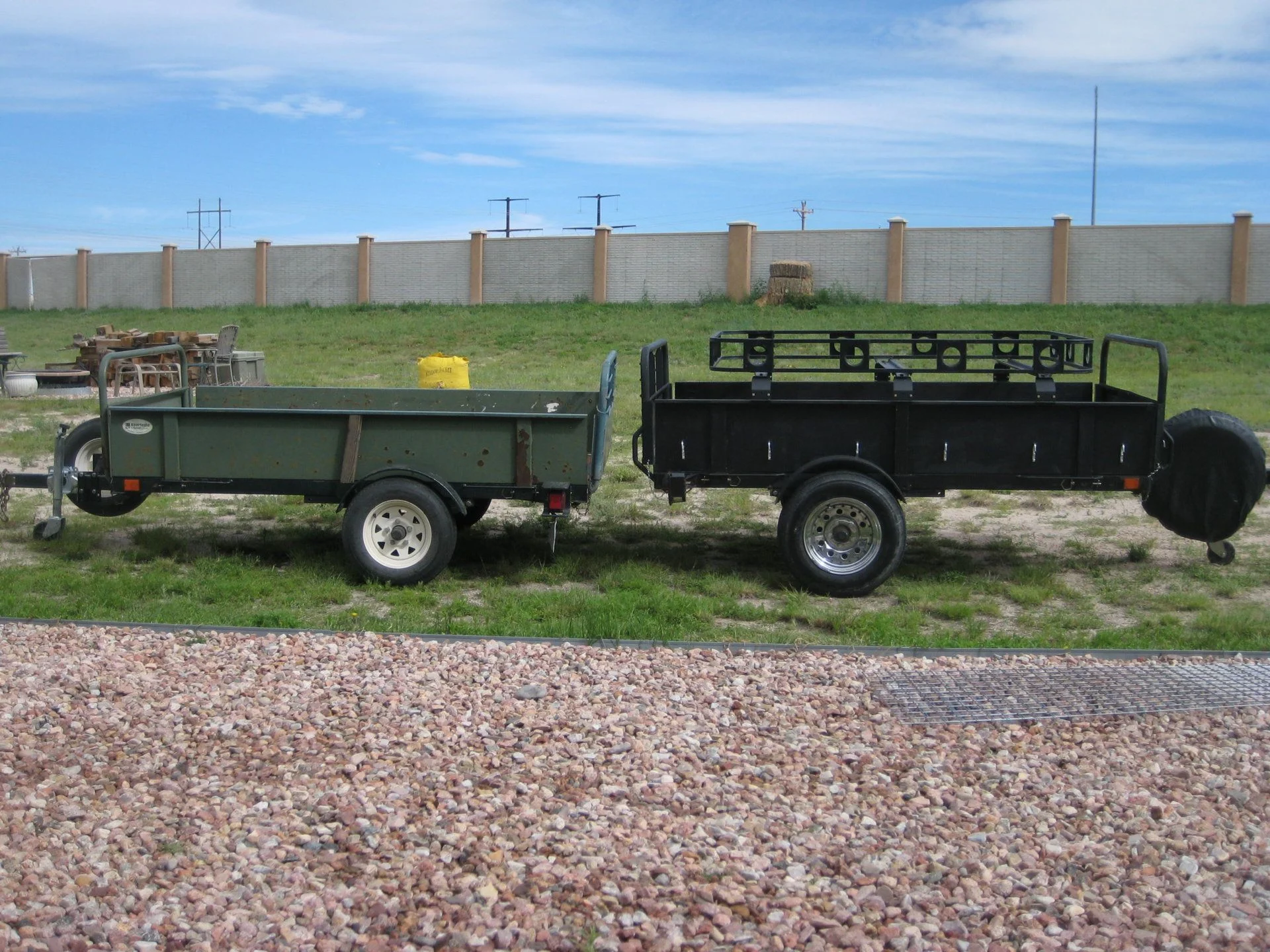

this is my daily driver.
just put another 1.5" lift on another Snowbear 4x8. This gives you the ability to run 13" tires for a significant lift. U bolts are 3/8 x 14 View attachment 2008828

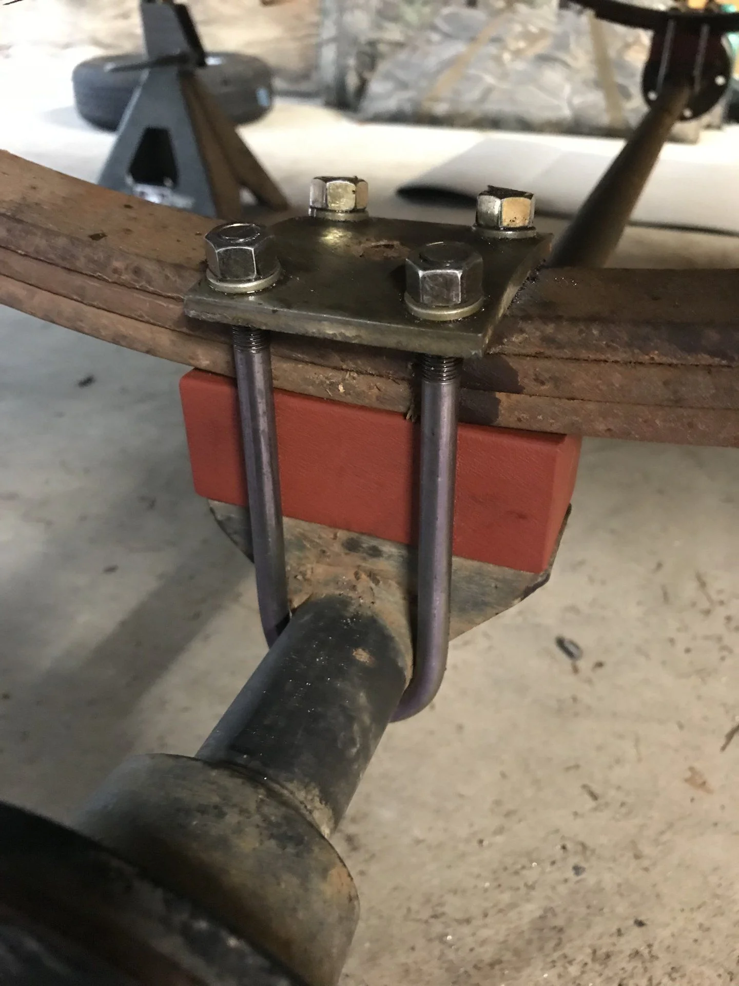

Hi Shootist, hope you see this a year + later. I want to do the same lift you have here So I can run 13” wheels.
Hi Shootist, I want to do this same lift on my Snowbear 4 x8 so I can run 13” wheels.
Where did you find the u-bolts? I’ve been all over the internet and can’t find this size...

Yep-- still here and still running snowbears with lifts! I used to get the U bolts bent at a shop in colorado springs, CO. Any shop that makes U-bolts can bend them for you if they have the stock. Rocky mountain spring and suspension. 70 Mt View Ln, Colorado Springs, CO 80907

sorry just saw this -- no downsides to lifting the trailer. wheels fit fine in stock fenders with my lift.

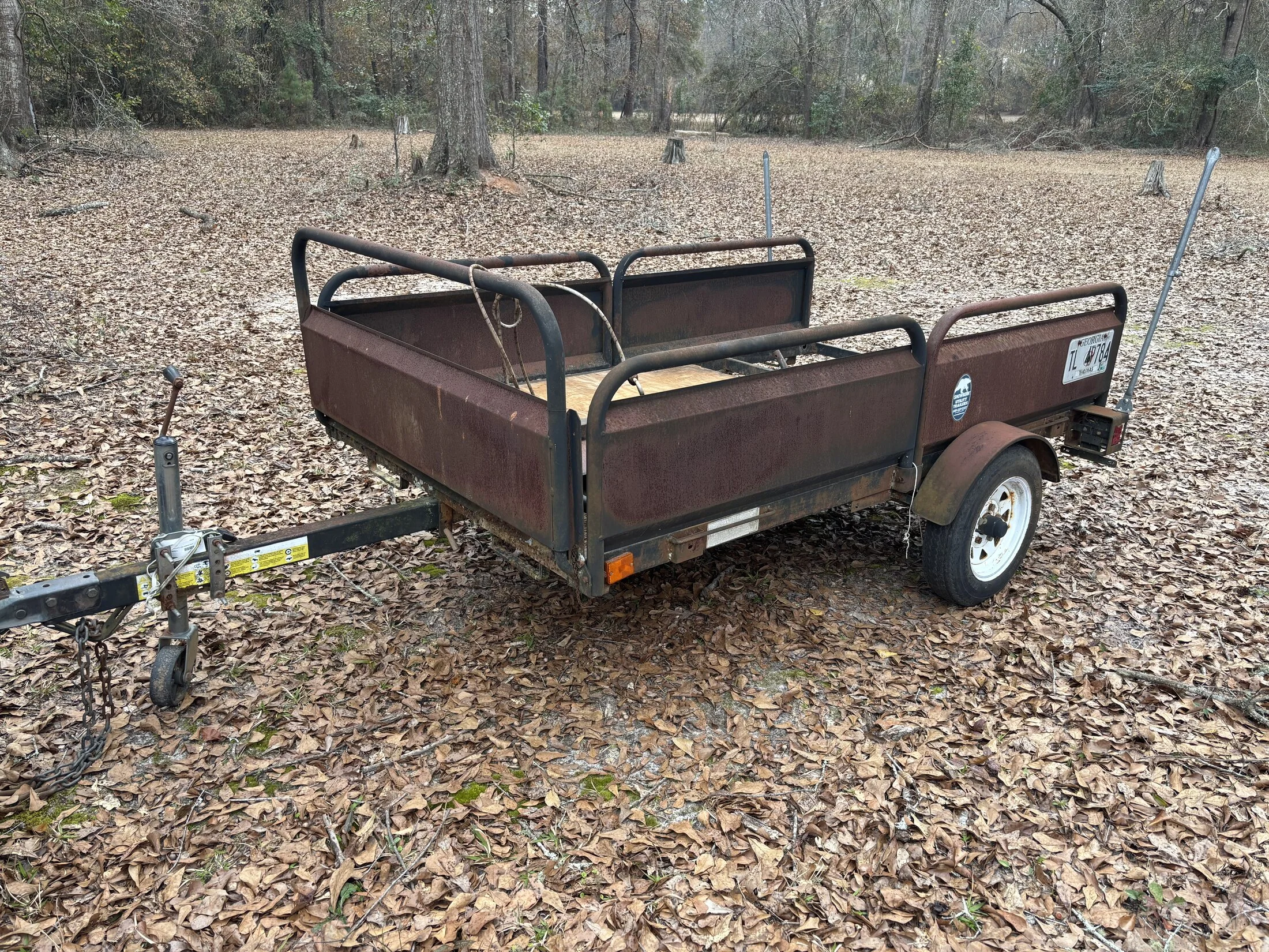

picked up another snowbear this week -- I like this model with the heavier sides. It has the tailgate, but apparenty bent a little as it won't go in the holes.
