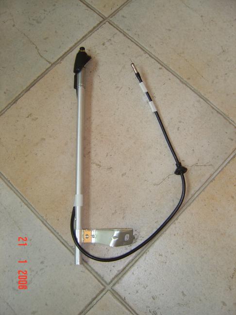

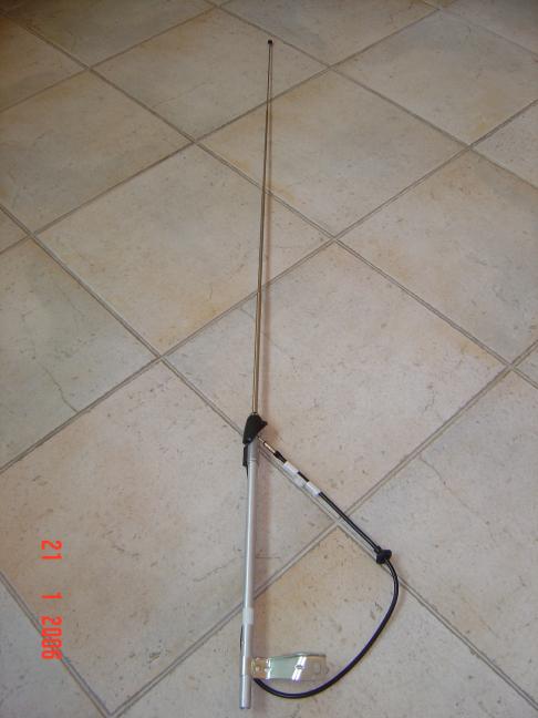

At first I went with the Chrysler one and it fit ok but I looked at my brothers Tundra and it seemed like it would fit perfectly. Remember, the Chrysler antenna's may differ from year to year and I may have had a different one than you.
A friend needed a new one on his Dodge truck due to car wash damage so I helped him out and got the Tundra one for myself:)
I will be doing a write-up with part numbers, etc. soon on the Tundra antenna.

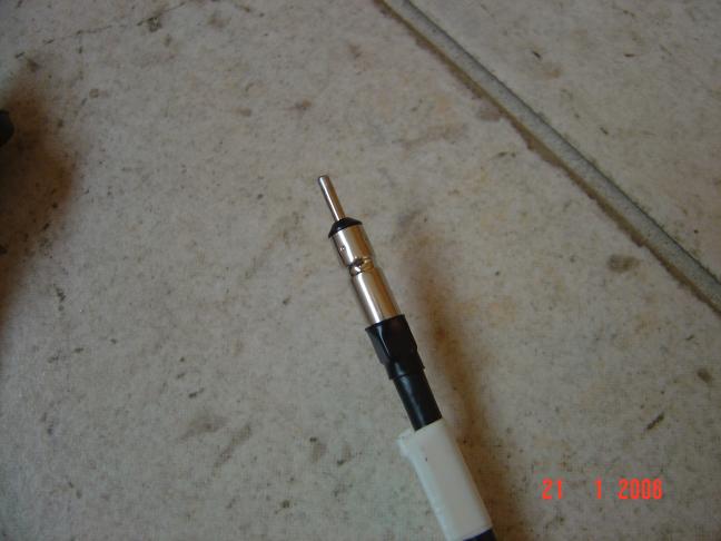

The problem I have right now is the plugs are different on the antenna. The one that runs from the stock radio and behind the dash has a smaller plug than the Tundra antenna. It comes down to the kick panel on the passenger front and plugs into the line from the antenna.
I haven't been to Radio Shack to see if they have an adaptor. I was hoping for plug and play but this isn't exact. Maybe the antenna from the 97+ Tacoma would have the correct smaller plug? Not sure.

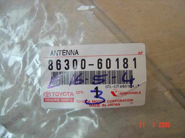

calamaridog said:
Siglo,
That part number isn't showing up in the U.S.

FYI, I used the same base as CalamariDog from the Tundra. This base fits really well on the fender up top. Underneath, you have to use a little arm bracket if you want to use the original mount on the wheel well to secure the base. You'll see when you get in there, any 3" strip of metal will do.
Connecting the wires was the hard part. When you unplug the original connectors in the side panel under the glove-box, the new Tundra plug (male) is too big to fit in the 100's connector (female) To fix this, I bought a couple screw-on-type RG-58 female connectors and a coupler at Radio shack.
I cut the connector (male) off the old antenna wire along with about 3 inches of the cable and added one of the female connectors onto the cable. Then I cut off the connector (also male) on the Tundra cable and discarded. I then added another female connector to the end of the Tundra cable where the connector was cut off. Then I used a coupler to connect the two female connectors together.
I also ended up tearing up the little fasteners that hold the plastic wheel well panel in place. There are 11 of these little guys. I ordered more of them from C-Dan. The part number is 53879-60010. They are less than a doller each.
Lastly, the part Calamaridog listed is for the base only. You also have to buy the mast. I don't have the part number for the mast, but it was less than $30.
Total including the base and cable, the mast, and the fasteners was about $65. Edit: I forgot the parts from Radio Shack were another $11. Overall, not bad considering my dealer wanted $270 for a new power antenna.:eek:
