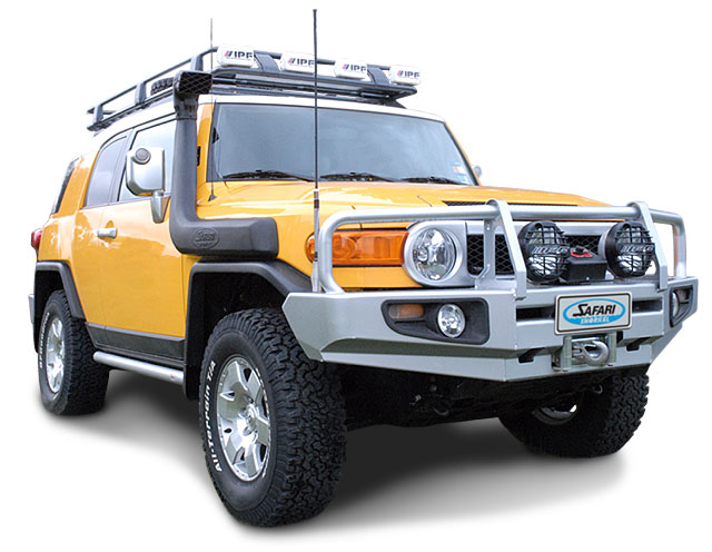

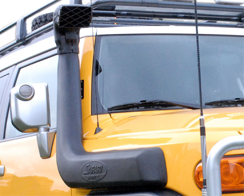

Drill a 4" hole just in front of the A Pillar on the passengers side and run a tube inside there. That's the way the other snorkel brand has done on some Land Rovers.
http://www.safarisnorkel.com/snorkel/ss410hf/ss410hf.htm
Oh yeah, I'd rip that thing right off on the trails. Maybe not a concern for the west coast drivers, but on this side of the Mississippi, there are trees and things to contend with. Also it should hug the A-pillar more. That gap at the top is just going to collect low hanging vines, branches, weeds etc. I think I'll pass on this mod, as 28" of water fording is enough for my style.
Gotta agree whole-heartedly on that. It would last about 100 yards on the right coast.
Also, are you guys really doing water crossings that deep? I've had water over my hood on the my current and last three Jeeps and the intake was the least of the worries (the grill, radiator, bumper, etc. create a bow-wake that and leave a void or low spot ). It was the electronics... and later the tranny, dif's, t-case, etc.
I don't think that most people want it for the water fording. I myself would want it more for the dust and cold air intake. That is probably why it sticks out at the top.
That is the only reason I am getting it.
