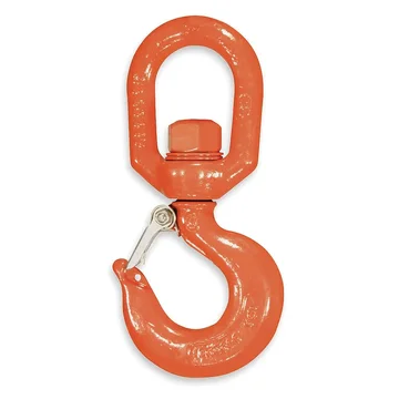

Are there significant cons to using a snatch block with a swivel hook?
This is a swivel hook. If this is the hardware you are referring to then yes a Screw Pin Anchor Shackle (casually called a "D-Shackle" in 4wd circles) is a much better and more universal piece of hardware to carry in your recovery kit.
With a swivel hook you will still need a screw pin anchor or similar to attach the swivel hook to a snatch block; redundant.
Also comparing each to WLL you will see the swivel hook has a much larger form factor (takes up more storage space), is less universal in its application (relative to vehicle recovery) and will be much higher cost to purchase.
Just my $.02.
You have to take off the bolt that holds on the hook every time you use the pulley to put it on the wire. You have to fuddle with the hook, the bolt, the nut, cotter pin as well as the pulley itself. With a shackle there are only 2 pieces to deal with- the D ring and the pin. Less stuff to drop in the muck etc. The hook version might be better for permenant installation but it seems tedious to deal with if you need to put it on and remove it several times- especially with gloves on.
The shackle will have a smaller lighter pkg for the same WWL and will come in handy for other uses as well. I even took the hook off of my winch line and just throw on the shackle anytime I use the winch because the straps sit in the shackle better.

the military swivel hook is simple and easy to use no pins no fidelling just turn and hook .i use them because my pto winches are to strong for the warn and arb stuff .i have a couple of the older warn snatch blocks for my smaller 12 and 10,000 lb winches .
How about a pic of what your talking about ? Sounds like a good solution.
Having a swivel hook lets the cable unwind on heavy pulls and will reverse swivel when retrieving cable . Win win in my book :)
http://www.rangerindustrial.com.au/shop/lifting/swivel-hooks.html
On a hook= yes not a bad thing to have. The O.P. was asking about a snatch block. Not sure I'd want to have the block twisting around.
Pete
ive used the swivel blocks for over 40 years once they line up they dont turn or move .all my swivel blocks are used for the 5 ton wrecker by the military not saying what is right or wrong just my expereince with them. busy day going to recover 2 power wagons from the bottom of a gulley will post photos of the blocks way later if all goes well.i always overdo stuff in a recovery that way i never have any problems and no one gets hurt thats justs me
