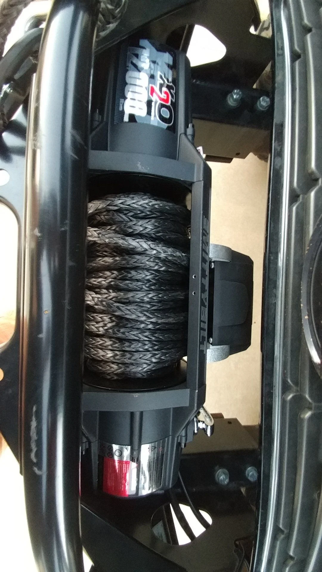

Finally getting around installing my X2O 12k (synthetic) winch, lots of competing priorities... Anyway, with the 12k synthetic what bolts did you all use to clear the spacers or do the Smittybuilt supplied bolts work. Thanks.
I'm tracking:
3/8'' aluminum 1x1 spacers (2) (9/16" holes?))
gearbox 90* to the left
supplied bolts or?
Pretty sure I bought longer bolts, can't remember exactly length depends on spacers
I'm tracking:
supplied bolts or?
Post #19 details this. You need longer bolts.
Got it rigged up, need to respool my line. I left the gear housing in place bc there seems to enough working room but I may end up rotating it 90 degrees.
