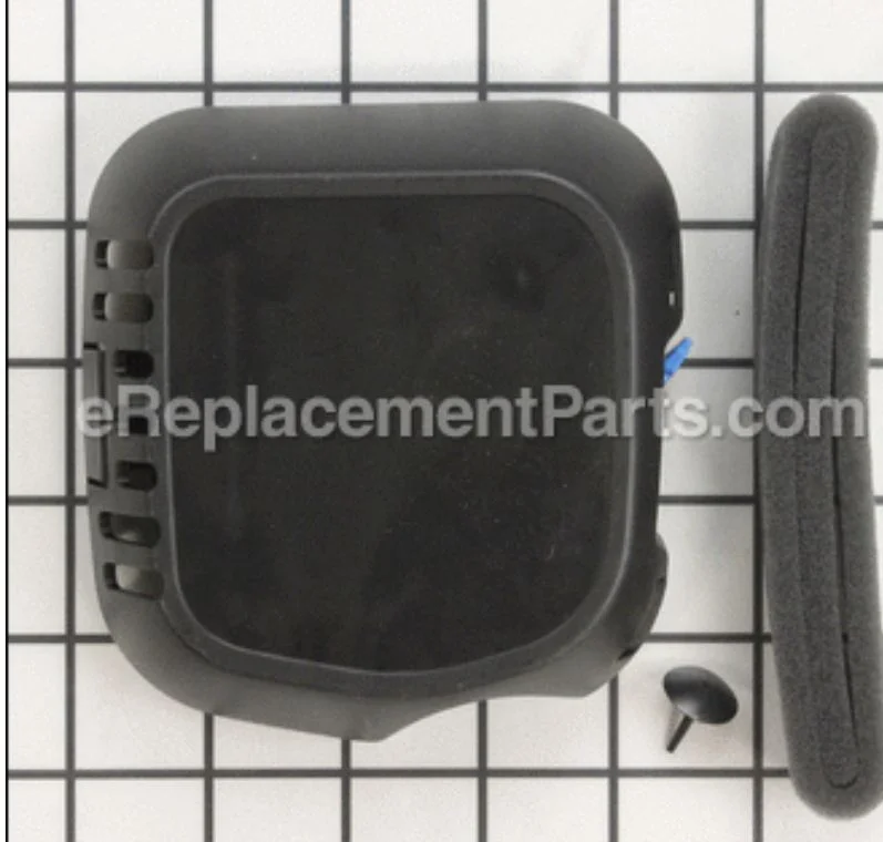

So why post up here. The air cleaner housing is broken/missing. A new housing is about $50 if it comes to that, but that’d triple my investment in this experiment.
Here’s a picture of what the missing cover looks like.

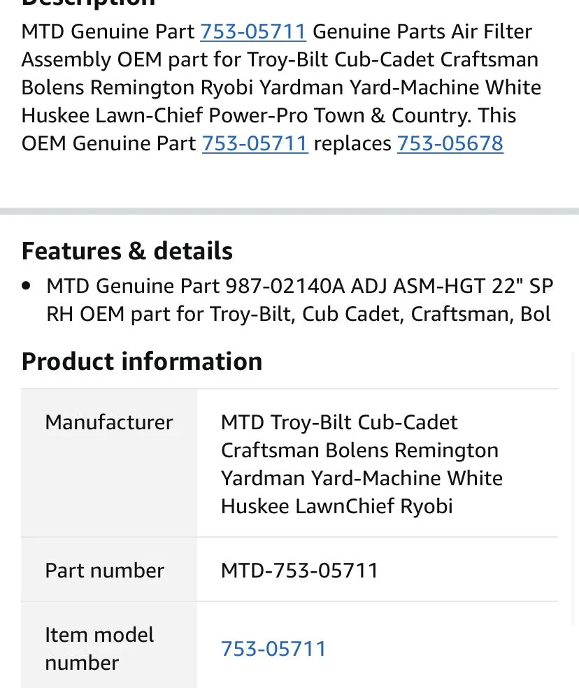

And the other brands that use the same housing.
If I can’t find a used housing, I’m thinking I’ll adapt some kind of filter to do the job. The only complication is that the choke is a part of the housing.
So my thought is to find a foam filter to cover the backing plate and then hold it on with a ‘sock’ or drawstring breathable bag.
Anyone have different ideas?
The carb has a 1/2” intake hole and it’s held on by two bolts about 1.5” apart. The choke is a small plate that slides over the carb throat that has a 1/16” hole in it.
Any small cheap air filters that come to mind?

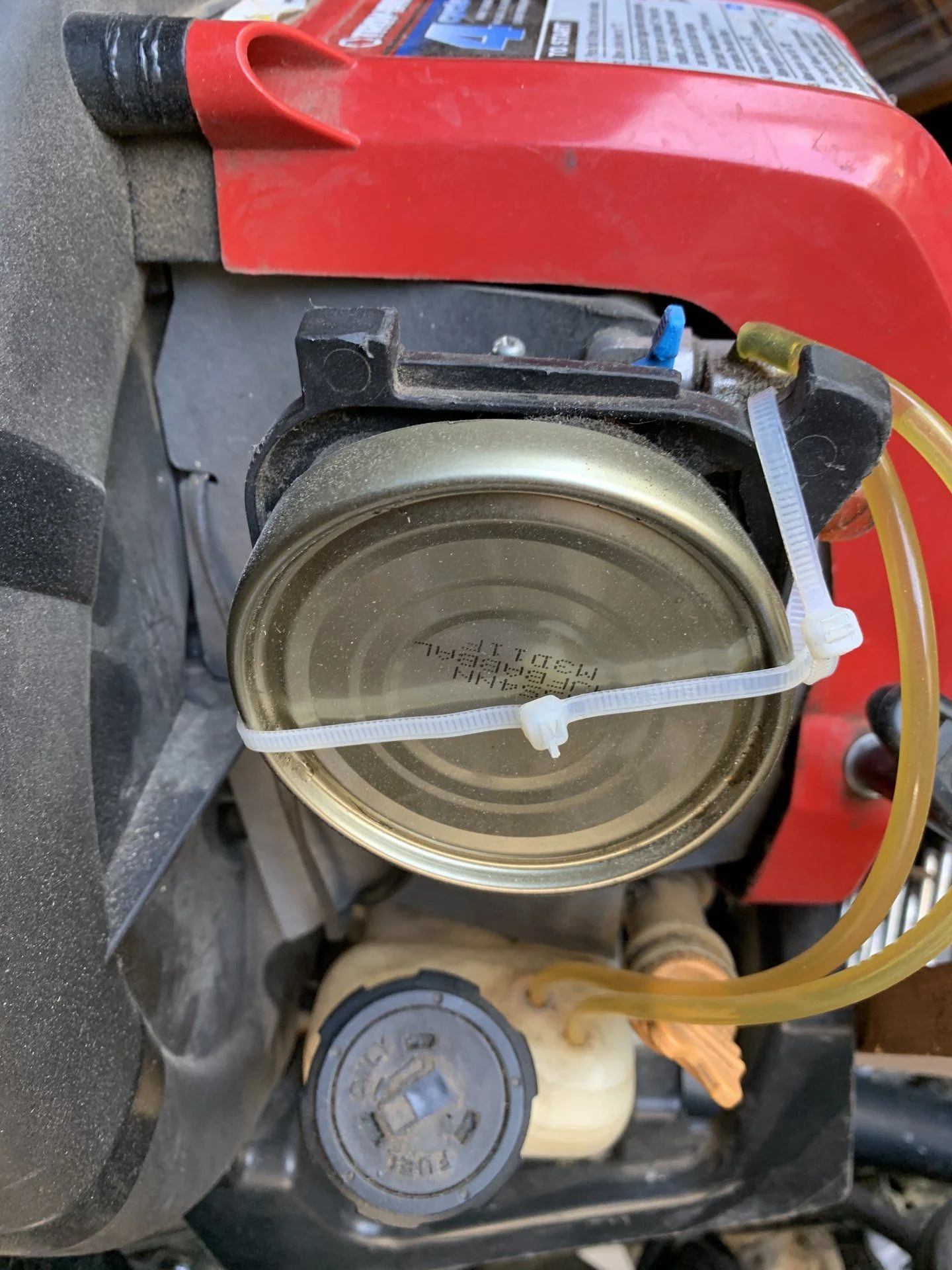

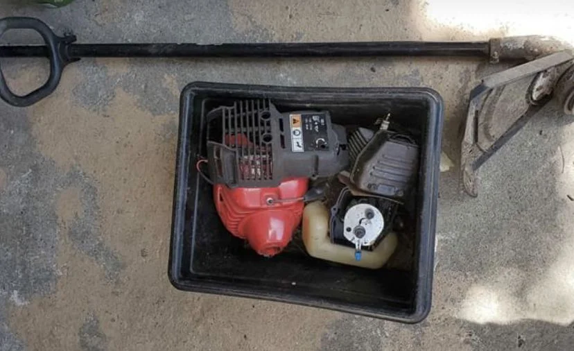

Picked up a free parts weed eater. It seemed to be all there. At least it was until I claimed the foam donut filter for the backpack blower
Next came a prototype filter cover. Not pretty... quiet red neck, but it works.
I used the angle grinder to shorten a can.
I
I bought and installed a cheapy Stihl filter housing to replace this… only to later have someone down the road tossing out a broken RYOBI line trimmer. Oh well.
