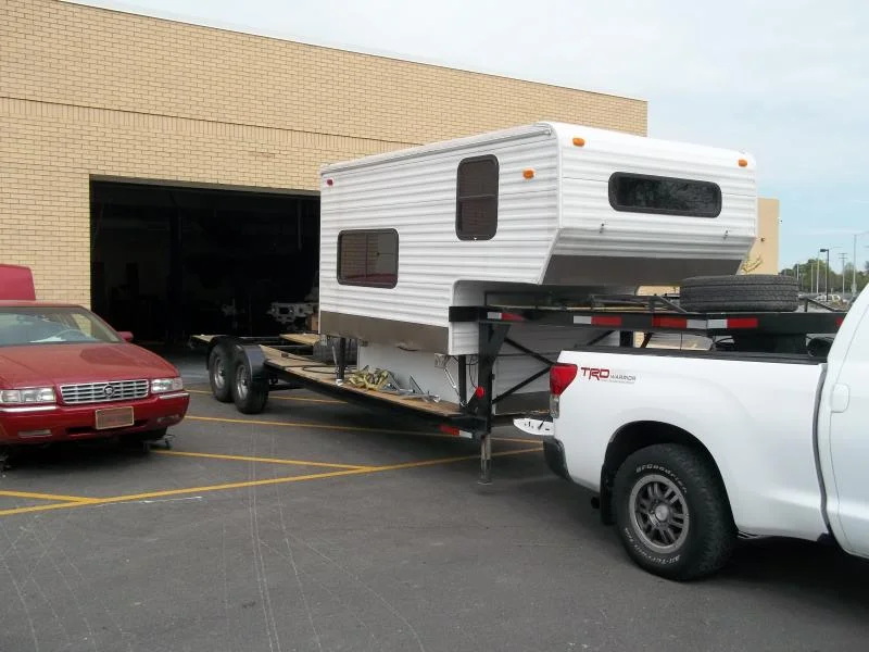

So I got a 5th wheel trailer to leave the camper on. It's a former travel trailer I picked up for $200.

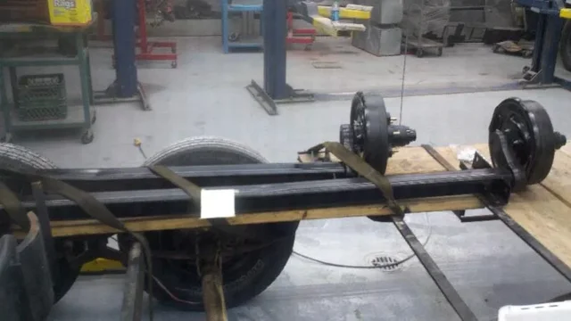

But the one I got was too short for the camper and the pig so I extended the bed back 4' and moved the axles back to get them under the pig. I think I'll dovetail another 30" or so too.
I'm looking to upgrade the axles too. Up to a pair of 7000# jobs I'm looking at.

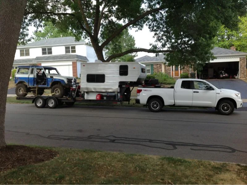

Hey Gumby, I used to own 2006 Tundra and my brother has 2007 Crew max and what we have noticed that by adding spring helper on the back will make your MPG go up by 1-2mpg's when towing larger loads. Unless you already have them, but looking at the photo it sits bit low. I used to tow 7000lbs generators with mine and I have noticed considerable improvement in gas millage also the truck was cornering much better. Just a thought. :cheers:
I'm running 5000 lb air bags in it now and it works great. It's no cummins dually, but it doesn't break down every 100 miles either. The bags are down to 10 lbs and the tires are down to 40 in the pic. When everything is at 80 it's a little higher in the back than level even with the loaded trailer on it.
I dropped the camper 3 inches into the frame to tighten up the gap on the front and lower it enough to fit in the shop. Put fenders on it today. Got the brakes all working right with the new dexter 8 lug hubs. New 16" rims and tires. Ran a rail along the upper deck to give be some tie down points, box in the deck and give the upper rails some support. Ran some bracing on the uprights too.
Got a vin number on it this week. My truck was telling me I was getting 13.6 mpg hauling down to go wheeling last weekend.
I scaled it on the way home. 7750 over the rear axles. Total weight for the truck and trailer is 15000.

Trailered it down to MO. For 10 days. It was pretty nice.
