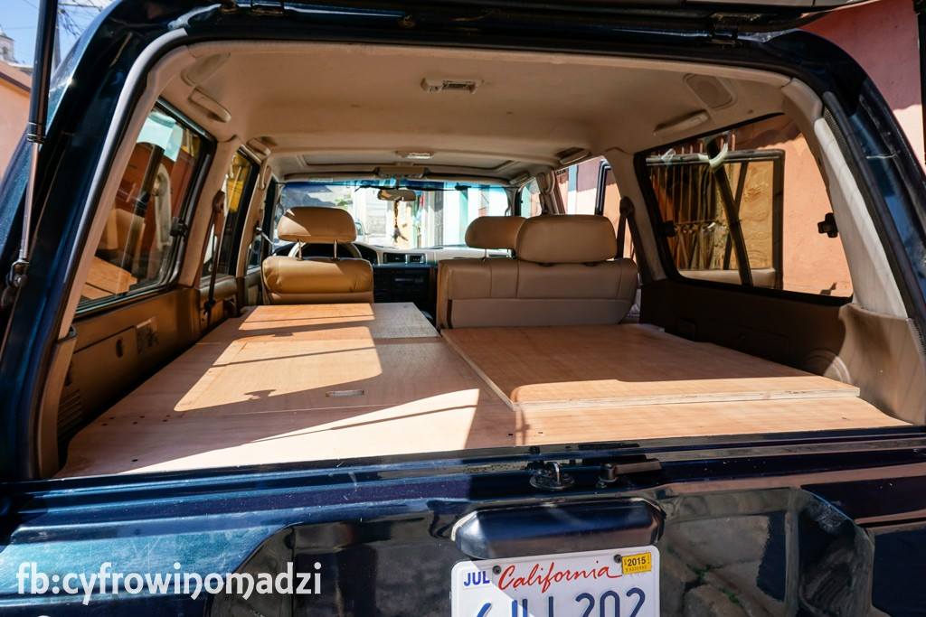

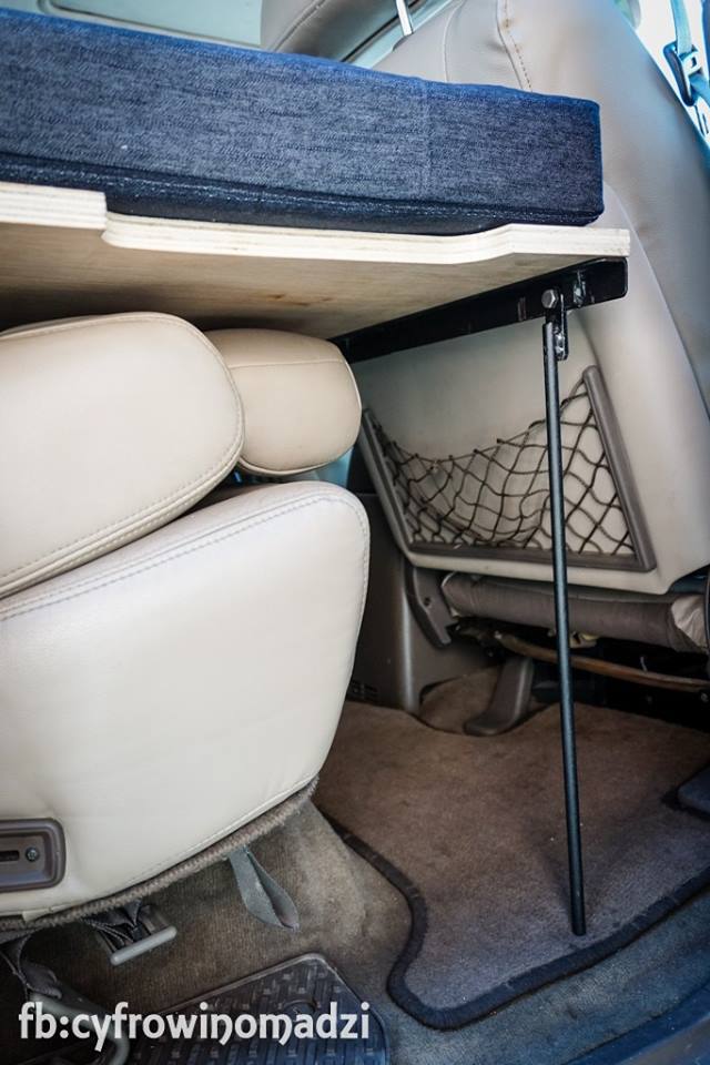

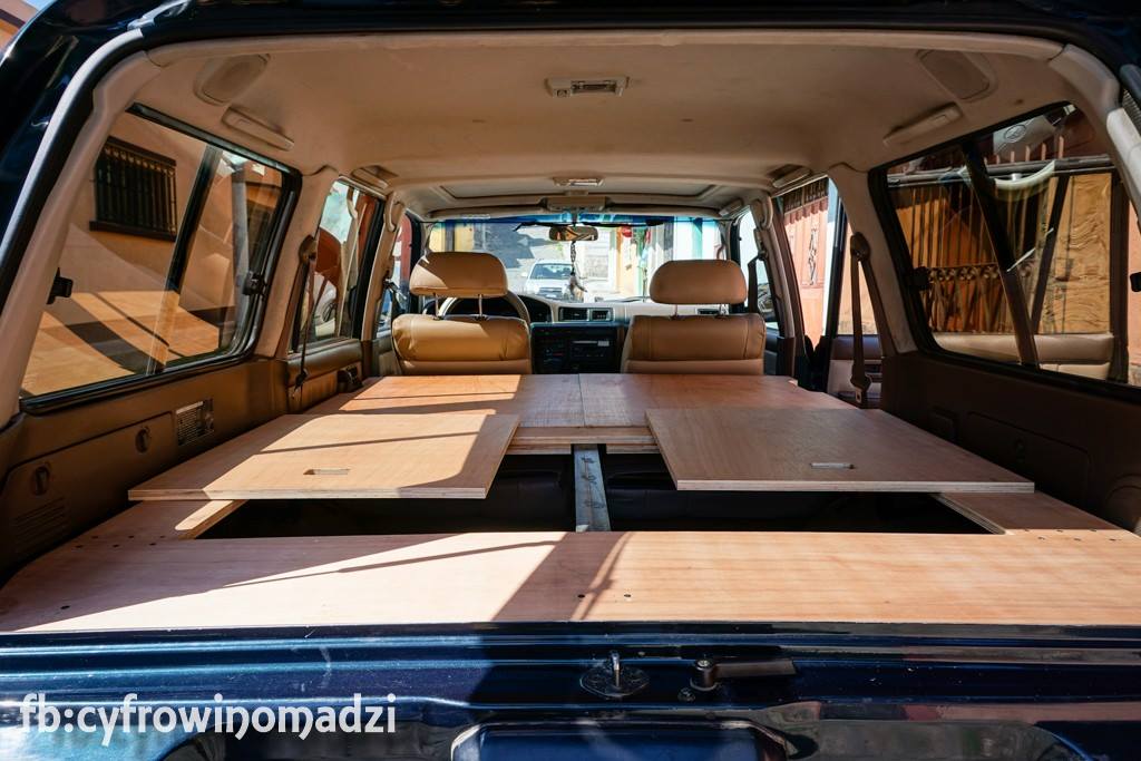

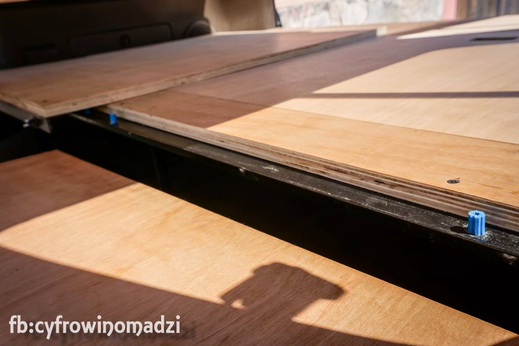

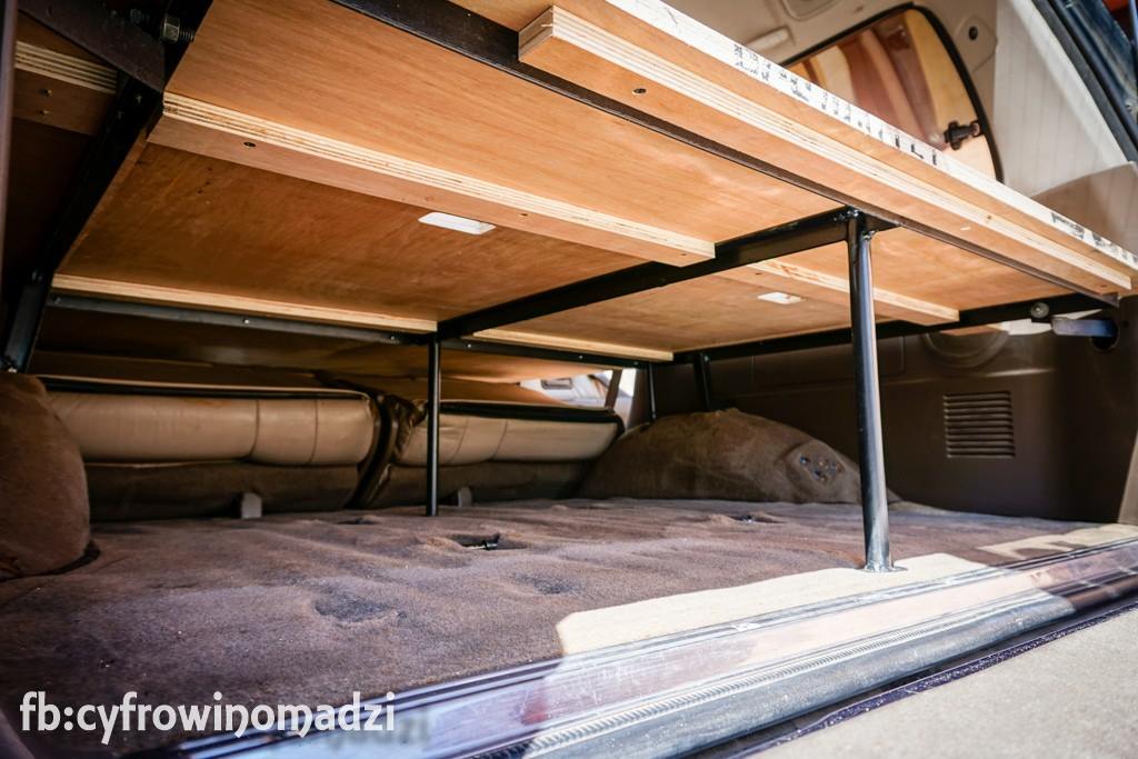

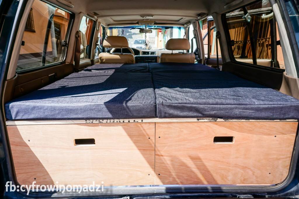

Just wanted to thank for the inspiration and share some photos of our platform. We have had it constructed a week ago in Quetzaltenango, Guatemala. We didn't use hinges as that would limit the maximum length of the bed (and we didn't want the platform to fold twice). We also didn't want the platform to lay on the seats, so it has foldable legs. Which by the way are the weakest and least thought through part of the construction. Nevertheless the platform is stable and provides us with a lot of space. We are 5'2" and 5'6" high and the platform is 6' long. We can comfortably sleep on it together with our Rottweiler so I guess without the dog three persons of similar size to ours could fit and have a good sleep.
We used 3/4" plywood, but I guess one could easily get away with 1/2".
Anyways, thanks again for inspiration!
