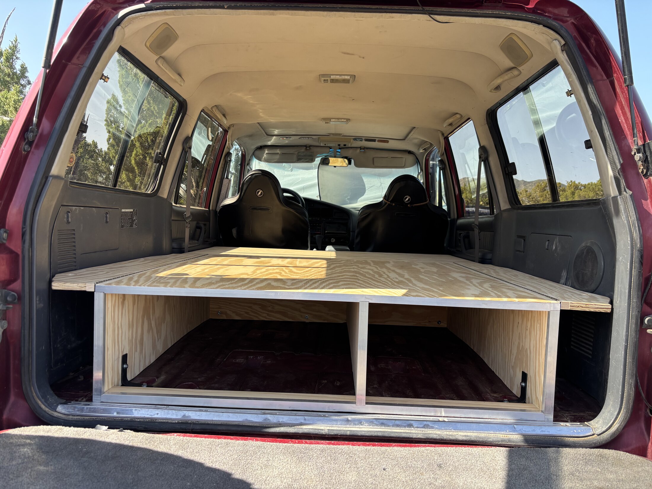

I had a carpenter friend do it. He did not keep track of his time, but I dropped it off with him on 5/7 and I picked it up yesterday 5/26. He worked on it in his spare time but was on another job at the same time.

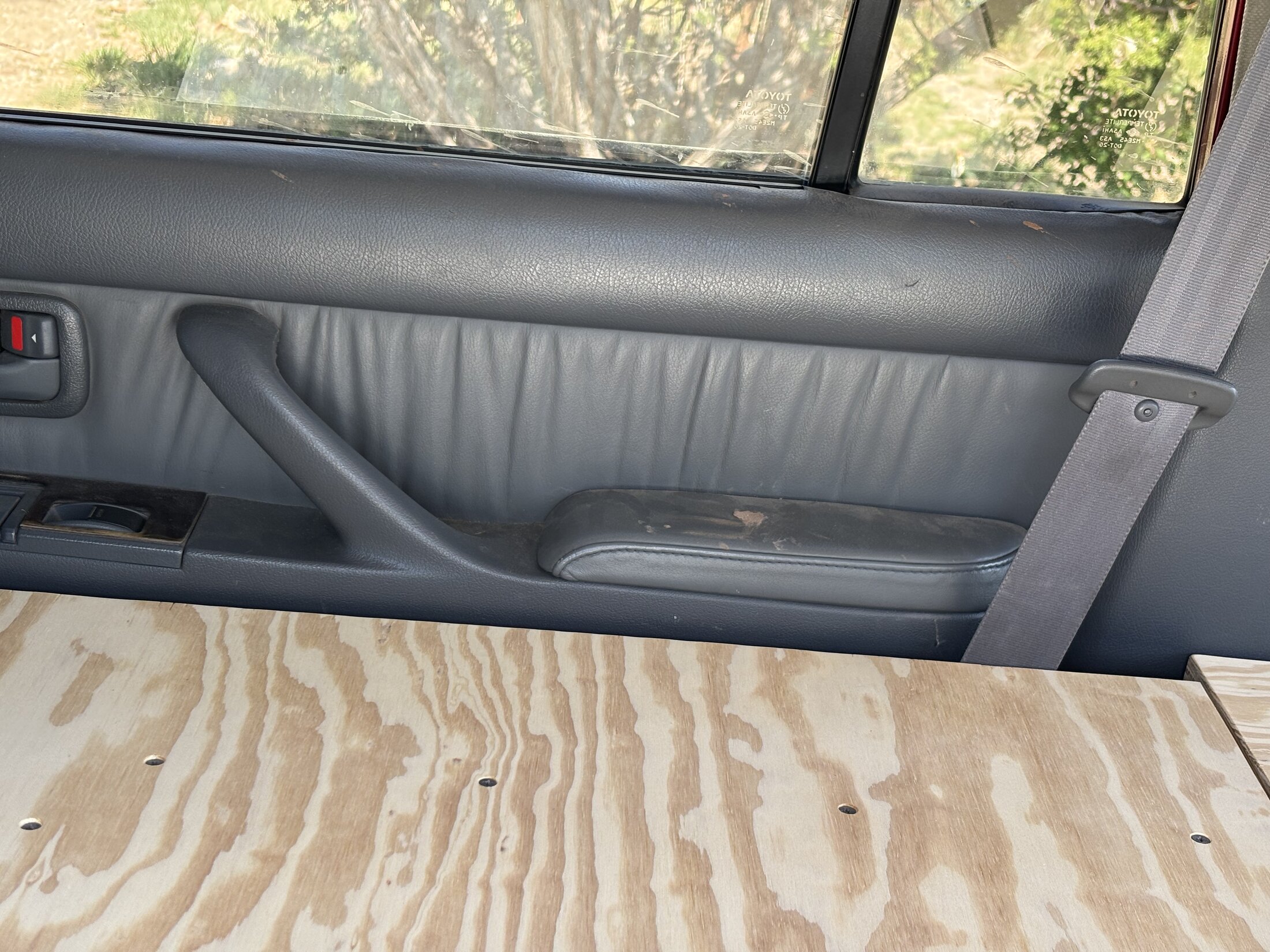

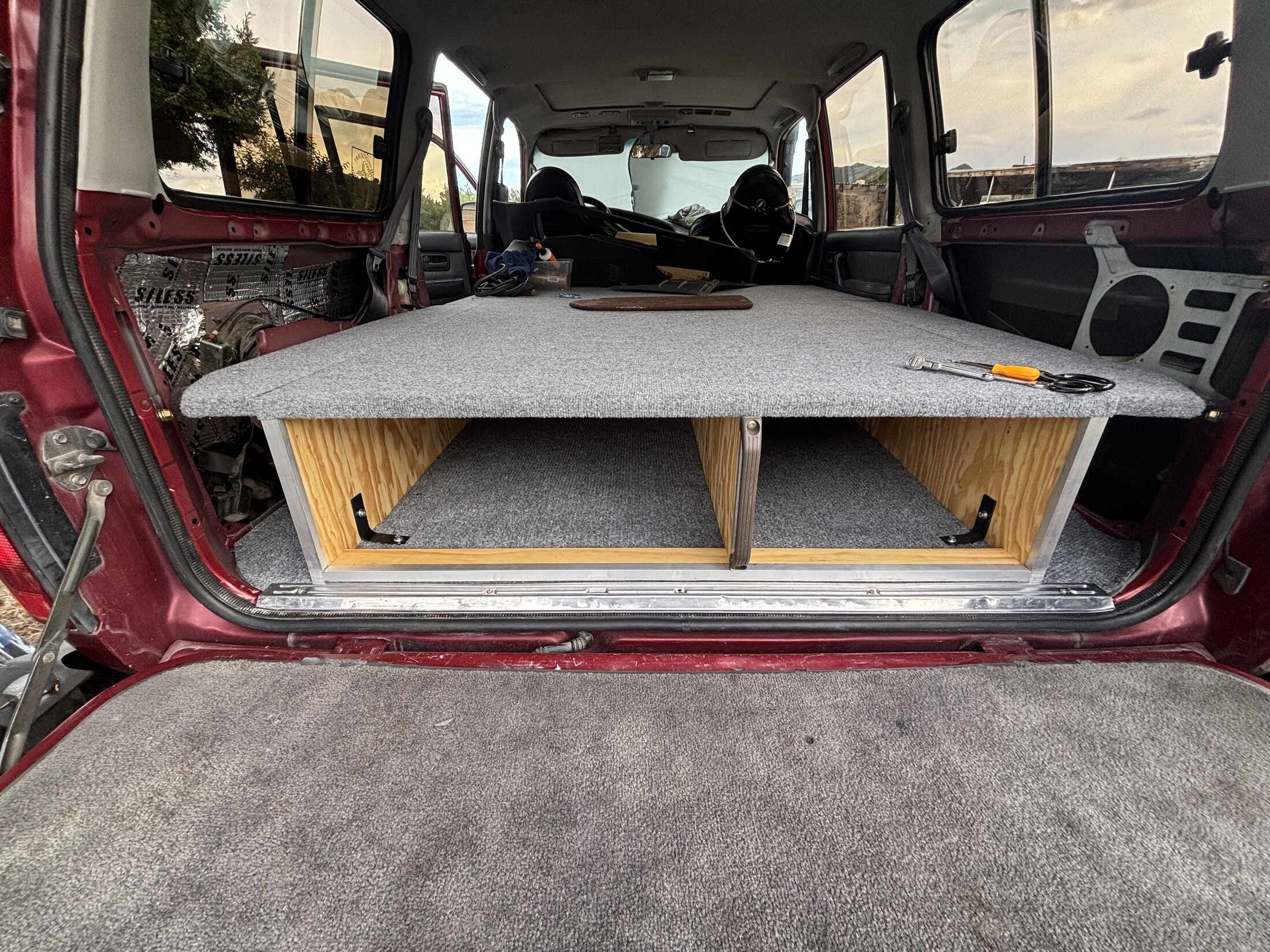

We used mid grade plywood, 3/4” and today I started covering it with carpet.

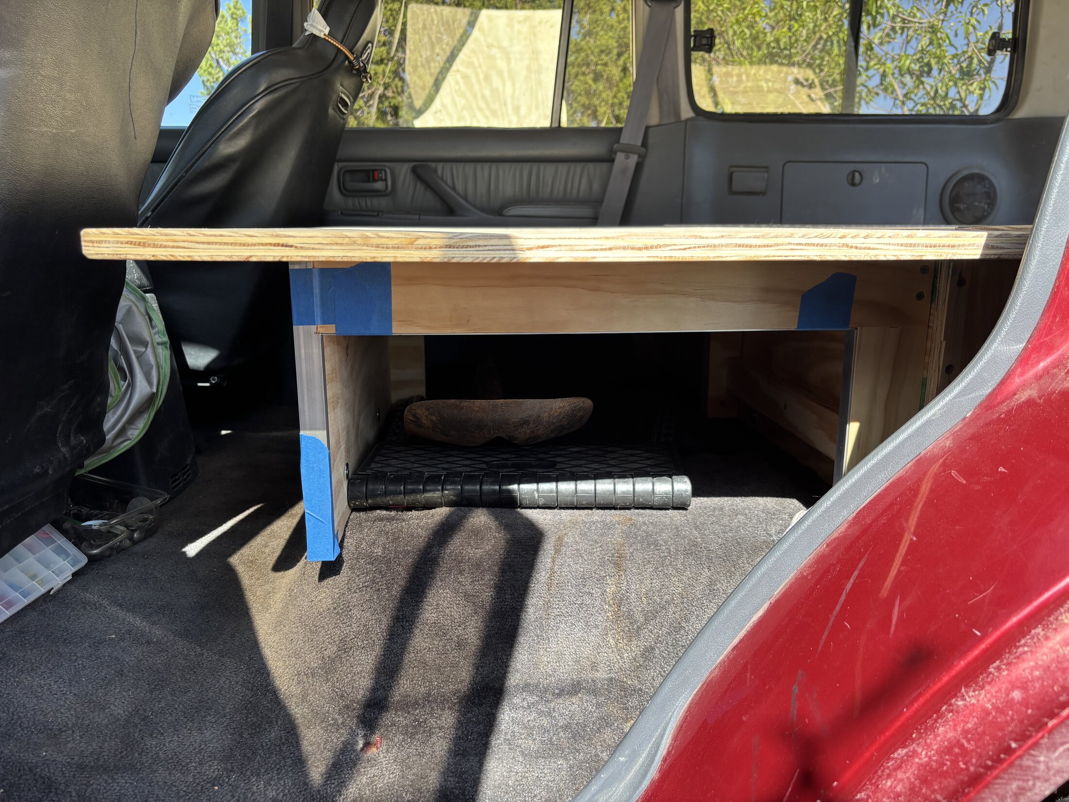

I did it! This is where we are today and we will be adding carpet today or tomorrow. So excited to have this project wrapping up!

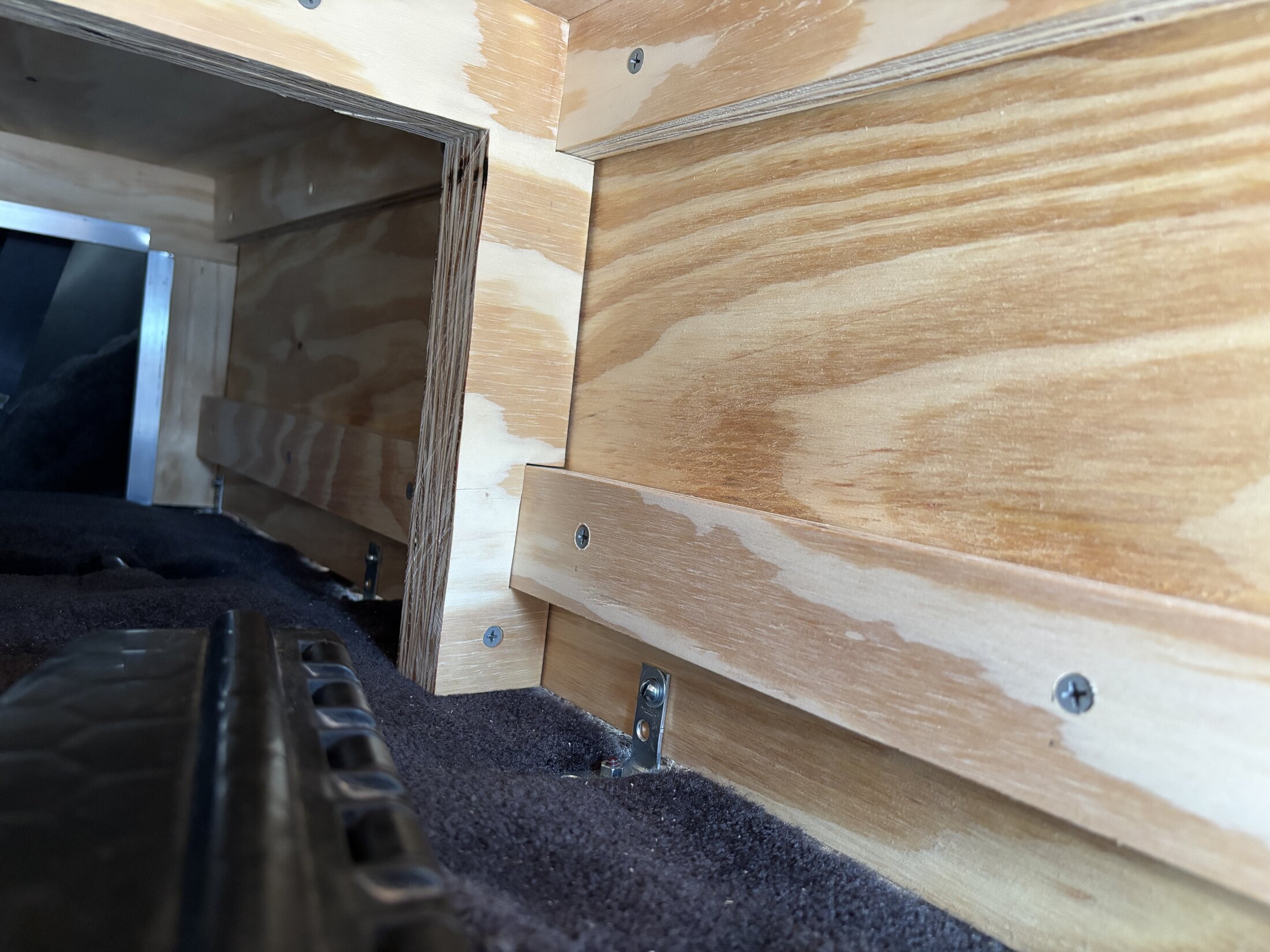

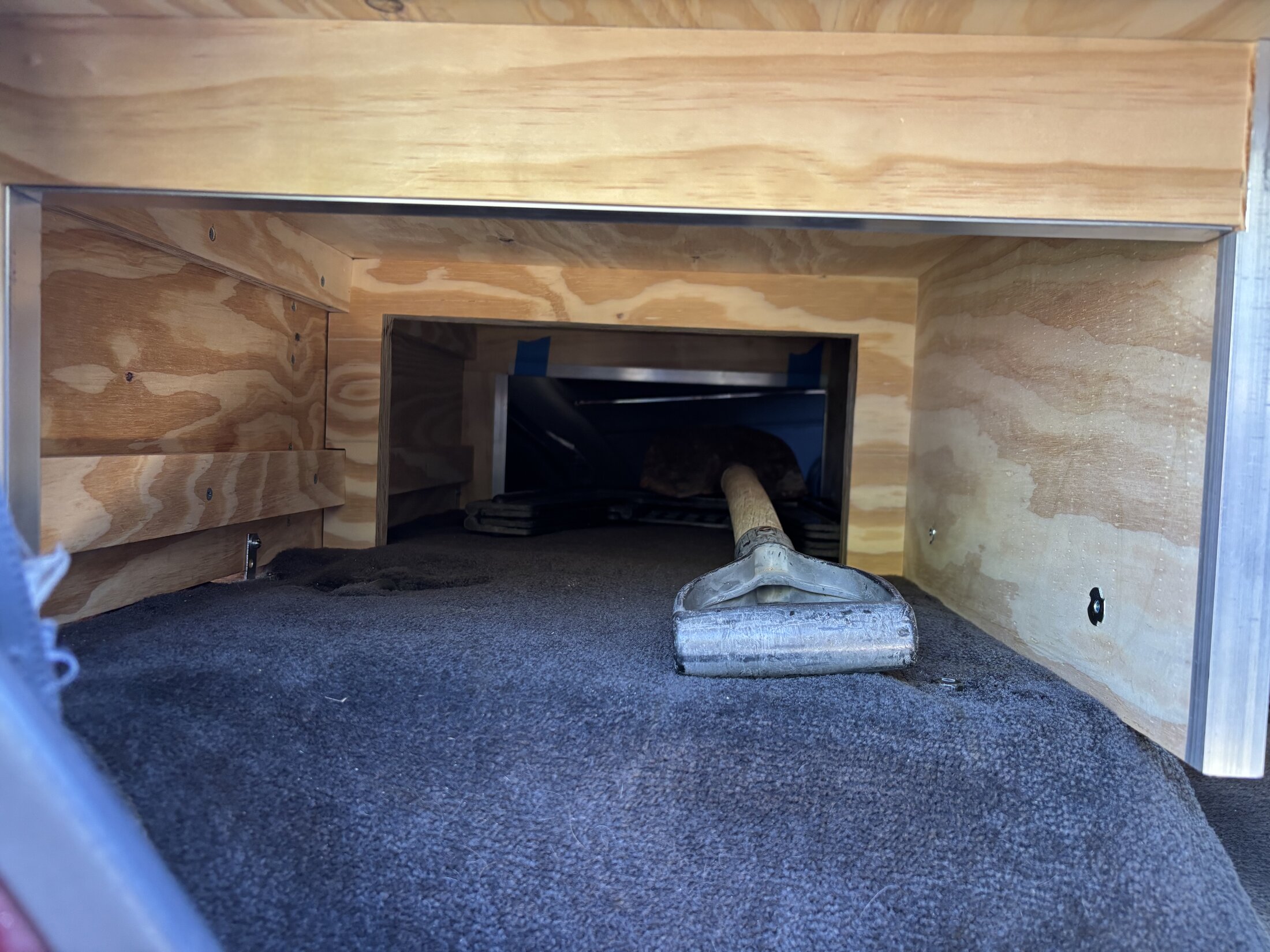

Got the side cubbies to work.

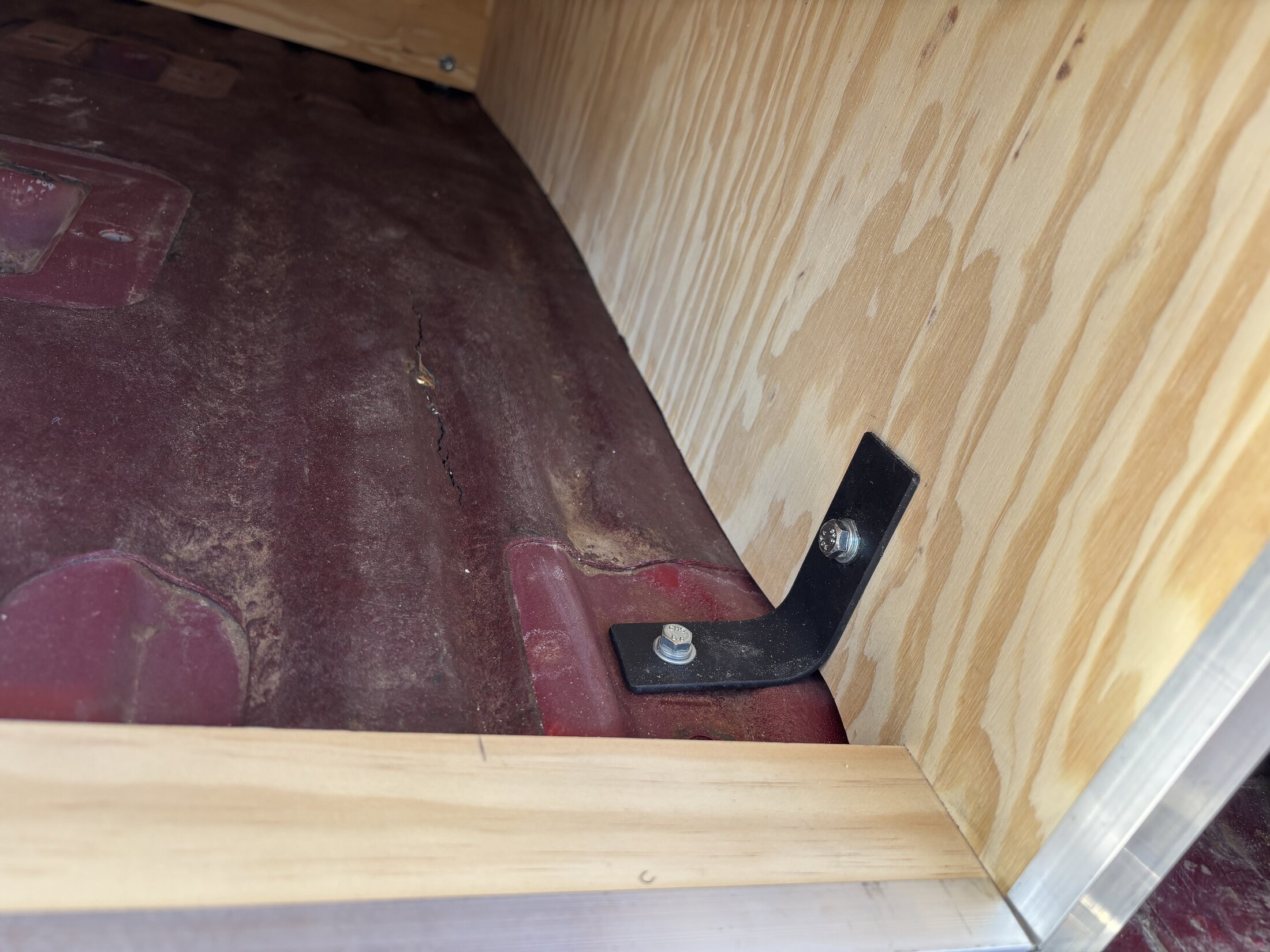

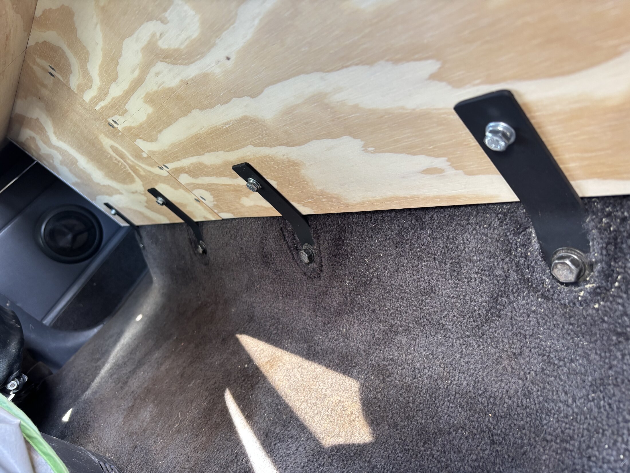

Used existing bolt holes to anchor the box down.

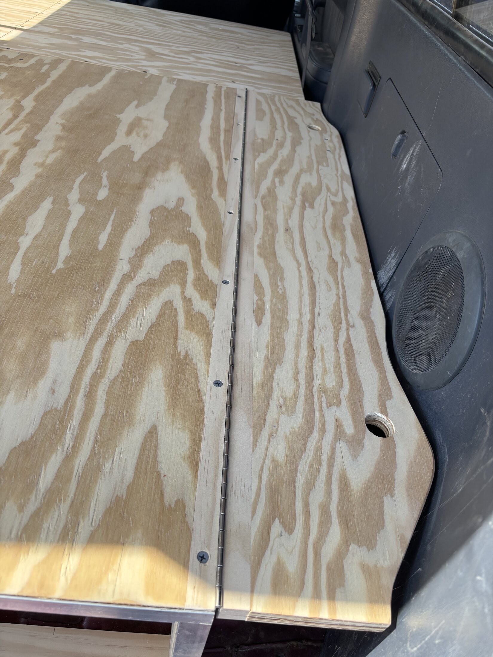

We decided to build two boxes for the second row. We did not hinge the top pieces, yet. We’ll see if the cubbies with side access from rear doors will satisfy us.

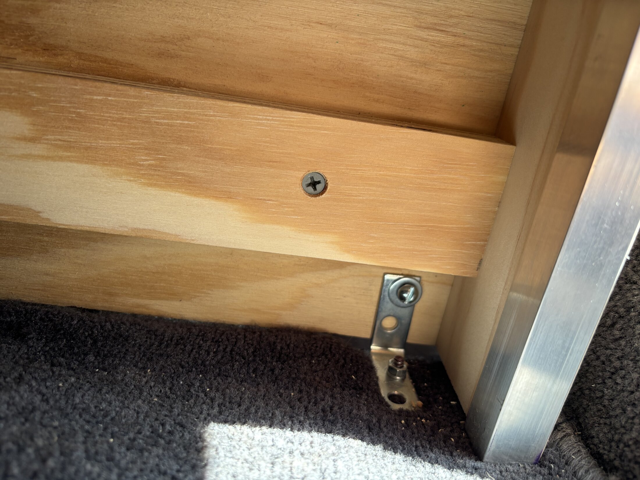

Anchored the front of the big box using existing bold holes and we decided to use the nubs for the carpet to secure the box to as well.
Here we used the second row seat bolt holes to secure the two smaller boxes for second row area.
Nice long open storage where the second row seats would go.

Not much. Two sheets of plywood and some wood for the legs.
We lifted out and it was not heavy at all, I was surprised. But we also did not do the solid bottom so that cut out more weight.
And it’s easy to remove.
The boxes that go over the second row seats were not heavy either.
Big one like 40-50lbs ?
