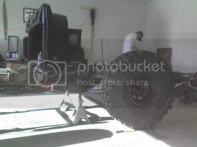

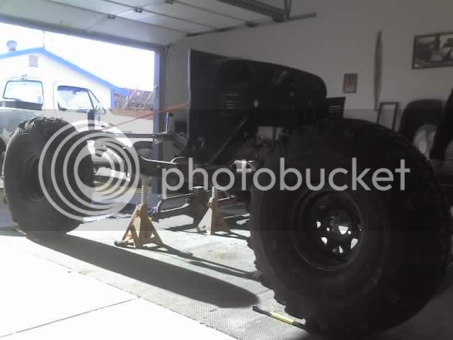

Thank you kind sir!! I chopped the back of the tub off today, got the front end out, starting measuring and got to thinking a little about what to do.......
This is what it looked like when Rick was building his buggy. Big pimpin flex!!!!:steer:
Just a little update. It's chopped down to just the cowl now, floorboards, complete front end, steering, EVERYTHING!!!! I'm picking up the tires this weekend....42 TSL's and my 8" hydro ram for the FULL HYDRO!!! I have a 12 ft stick of 2" aluminum stock that might get sleeved for my lower links, and there is a chance that it may get link'd in the front also. Picking up some other parts this weekend too, gears, heims, misc. stuff here and there.

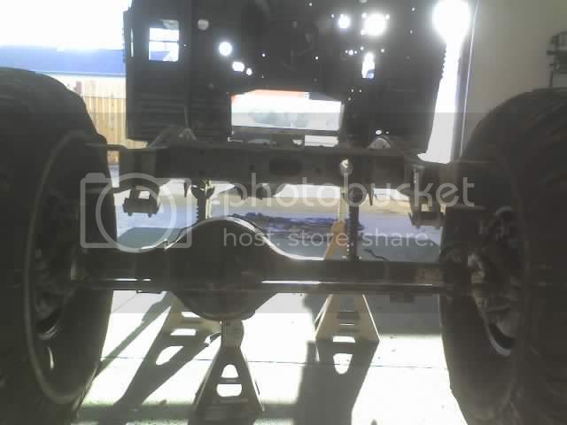

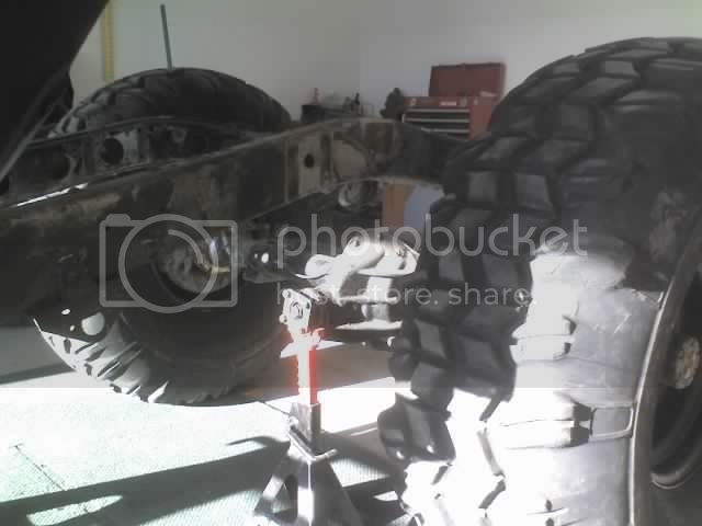

Quick question about the cut and turn. Since this one is gonna be link'd, and low slung, do I need to do it? It still has a few degrees up to go before it runs over good caster. Tell me something fellas:)
For a trailer queen? I don't think so, but there are greater minds than mine on this topic.
I didn't think so, but just wanted to ask. Poorboy told me he didn't C & T his 45 and it seems good. I can always knock the tcase down on the clocking ring a notch to help it out.....hopefully won't need to.....tryin' to get this baby flat bellied as possible!!!:grinpimp:
FUUUUHHHHHK!
:eek::eek::eek::eek:
I know right??? The next to last pic is my favorite, my buddy is standing about 10 feet away and you can see only half of him from where I am squating down to catch the shot. HE IS 6'3 LIKE ME!!!!
You only need to do the c & t if you are trying to turn the pinion up to relieve the u-joint angle and then turn it so that you have some caster. With dual cases and the extra wheelbase you are shooting for, I think you are going to be ok.:cool:
By the way, I agree with Keith, wowwwww.:D
Jack
