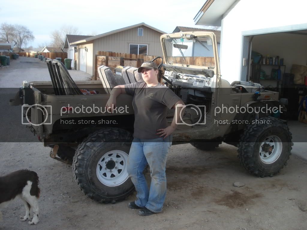

We got home from SoCal yesterday at 3 PM or so and the motor is almost ready to be pulled. Went ahead and pulled to hardtop and cage out and the hood off to make it easier to work with in the garage. After everything is pulled it is getting a bath underneath and in the engine compartment. If it wasn't dirty before(which it was), after a blown motor, it is very messy.
WIFEY SAID SINCE SHE BLEW IT UP, SHE WANTED TO HELP......BRINGS TEARS TO MY EYES!!!:grinpimp::grinpimp:
Yep, pulled the apron and rad, pulled the motor/trans/xfer case all in 1 piece. Now tomorrow I will get the pressure washer on it and clean her up.
Not bad for a few hours work yesterday and around 4 or 5 today. Thanks to Dan, Mark, and Charlie!!!! Props guys!!!
