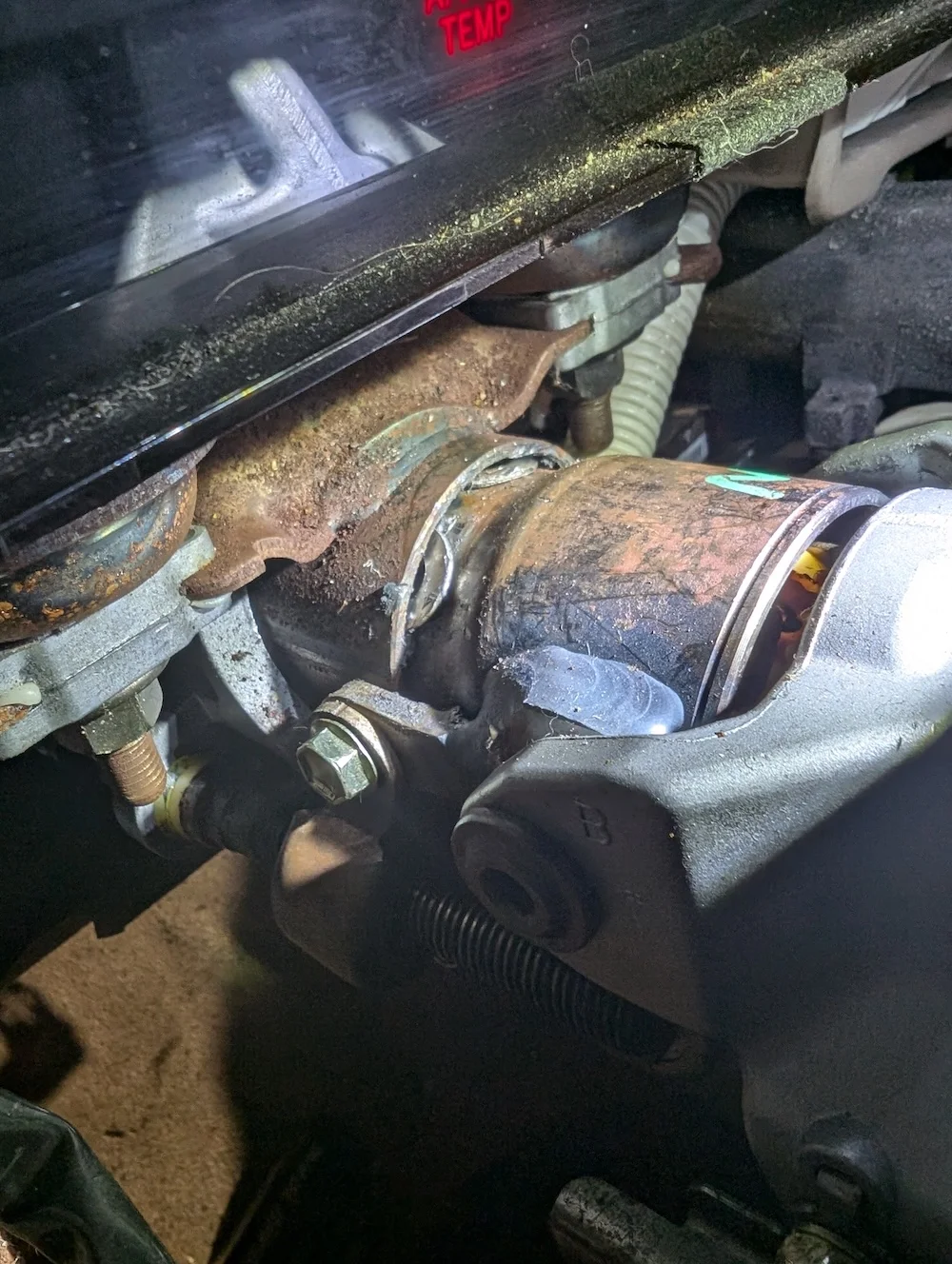

Context around my plea for help: I recently purchased an '02 LX470 that has a very clean body/frame, but I'm discovering some iffy-quality installs of replacement parts in the cabin now that I'm opening up the truck to remedy some deferred maintenance. I bought the truck knowing that it had the steering wheel replaced (tan interior but the steering wheel is black). I took a cursory glance under the dash panels and could see that the telescoping motor worked but the drive shaft was broken, so I ordered the $5 part and thought it would be a simple fix. Now things are snowballing.

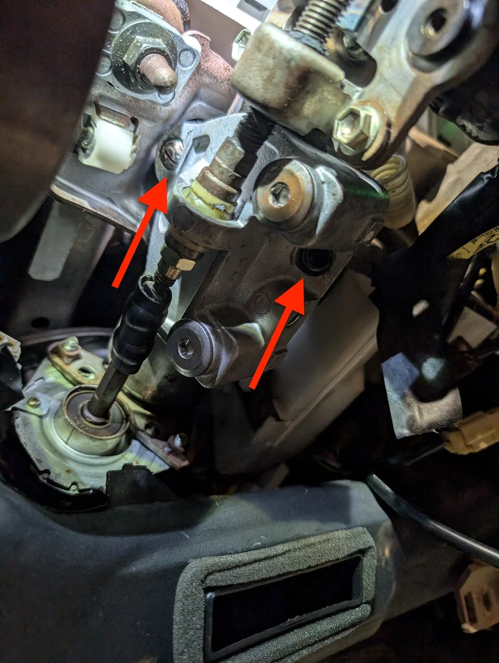

Having taken off the trim, It seems that not only was the steering wheel replaced, but the entire steering column (I noticed there's a lot of surface rust on some of the column components that are steel, indicating junkyard part). Making things worse, whoever did the work destroyed one of the nuts that holds the telescoping guide in place, and simply lost the other one (see photo below).
It gets worse. After destroying the bolts, they came up with an alternative way of holding the column in a certain telescoped position: shoving washers inside the steering column tube! I was able to remove two but there is still one deeper in there that I can't get out. Making matters worse, the column now has some up/down play in it since I removed those washers (I guess that's why they put them in there in the first place).
Since removing them I can get the telescope to move in/out manually, but it requires a bit of effort. Even if I bolt it all back together, I'm worried about burning up the telescoping motor (plus, that vertical play). I do want to get the telescoping working, and I do want to make it as safe/factory correct as possible in the event of a collision.
Given the demonstrated poor workmanship by the PO, do I just source another steering column in good working condition? Or do I pull this one, disassemble/clean it, and reinstall it correctly? I may be missing a few more small parts that I can buy for cheap, but if the braintrust feels that the condition + poor install are unsalvageable I may skip the attempt at repair and go straight to full column replacement (again).
