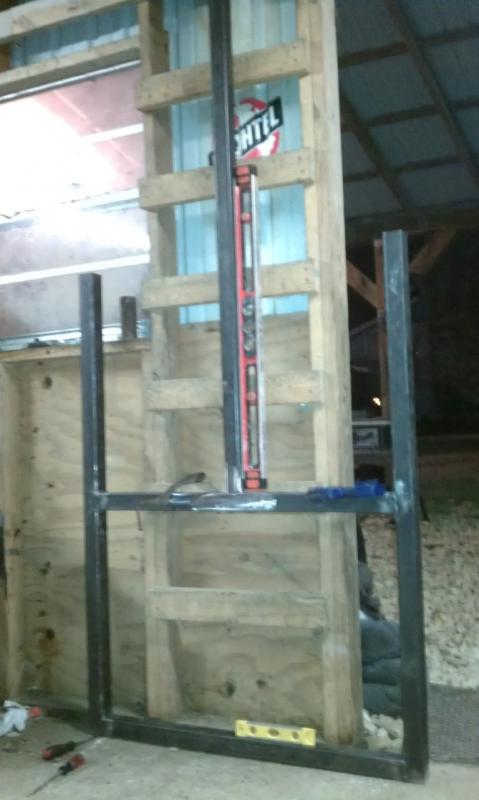

Update
Started the frame this weekend. I had the hardest time with squaring up the tongue of the trailer making it square in both left and right and up and down. You will see in the pic, I used the stairs for the hay loft to help square up the tongue.
Pics came out a little small I will try something else.
redo
Image redo :D
Side
Basic frame finished in pic 1
PIC 2 I finished 1 side ......helpers in the background..they prolly need some welding goggles:D
Pic 3 another pic with the side sitting on the frame.
